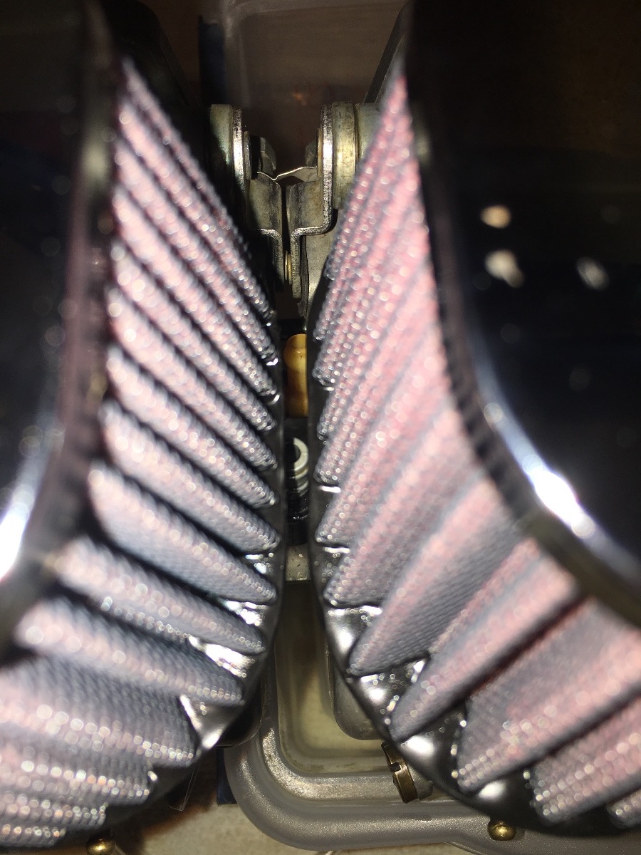

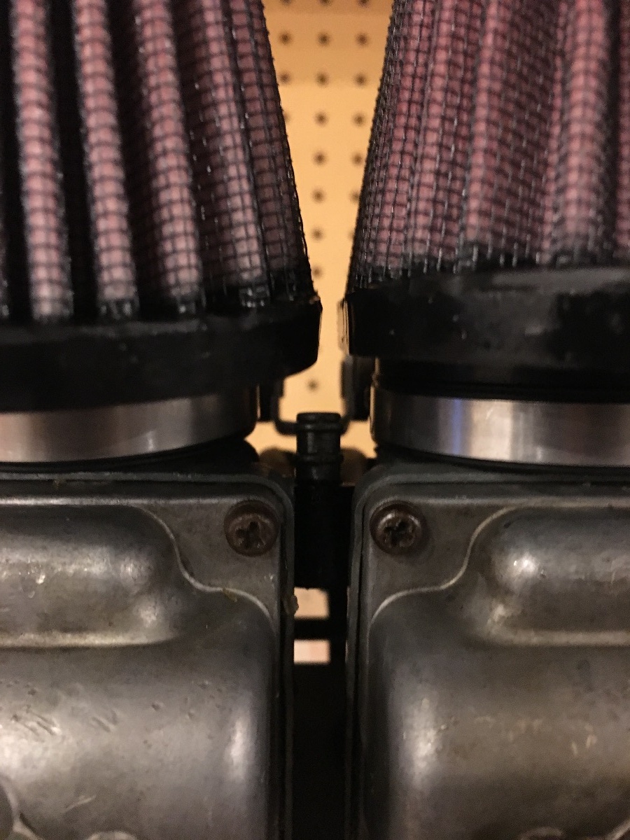

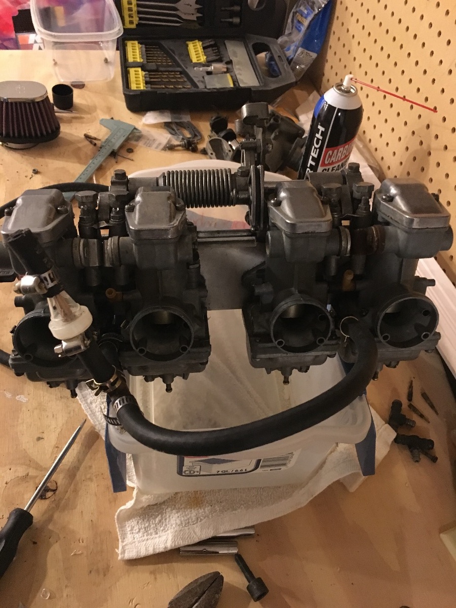

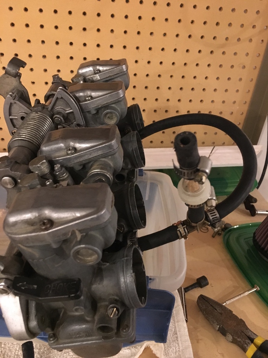

I have been having issues with how the fuel line is routed. With the old pods I think the pods were crushed to allow the fuel line to fit between them. I am trying to prevent damaging the new pods if possible.
The fuel line fitting is right between the pods and the hose is too big to allow clean passage. What should I do? Order fuel hose with less wall? Run fuel hose from the top or bottom? Pics for clarity.

My lines come up between #1&2,3&4

Your petcock has only one out let? Like SWest fuel lines and vent lines go up. The fuel Tee to the carbs will rotate up. Each pair carbs have a fuel line coming off the tee and go to my petcock which has two outlet tubes.

You mean your fuel lines, from the T, go straight up? I could give that a shot. What kind of line do you use?

Yes fuel tees face upwards....I'm using a 73-75 air box on my 76kz900

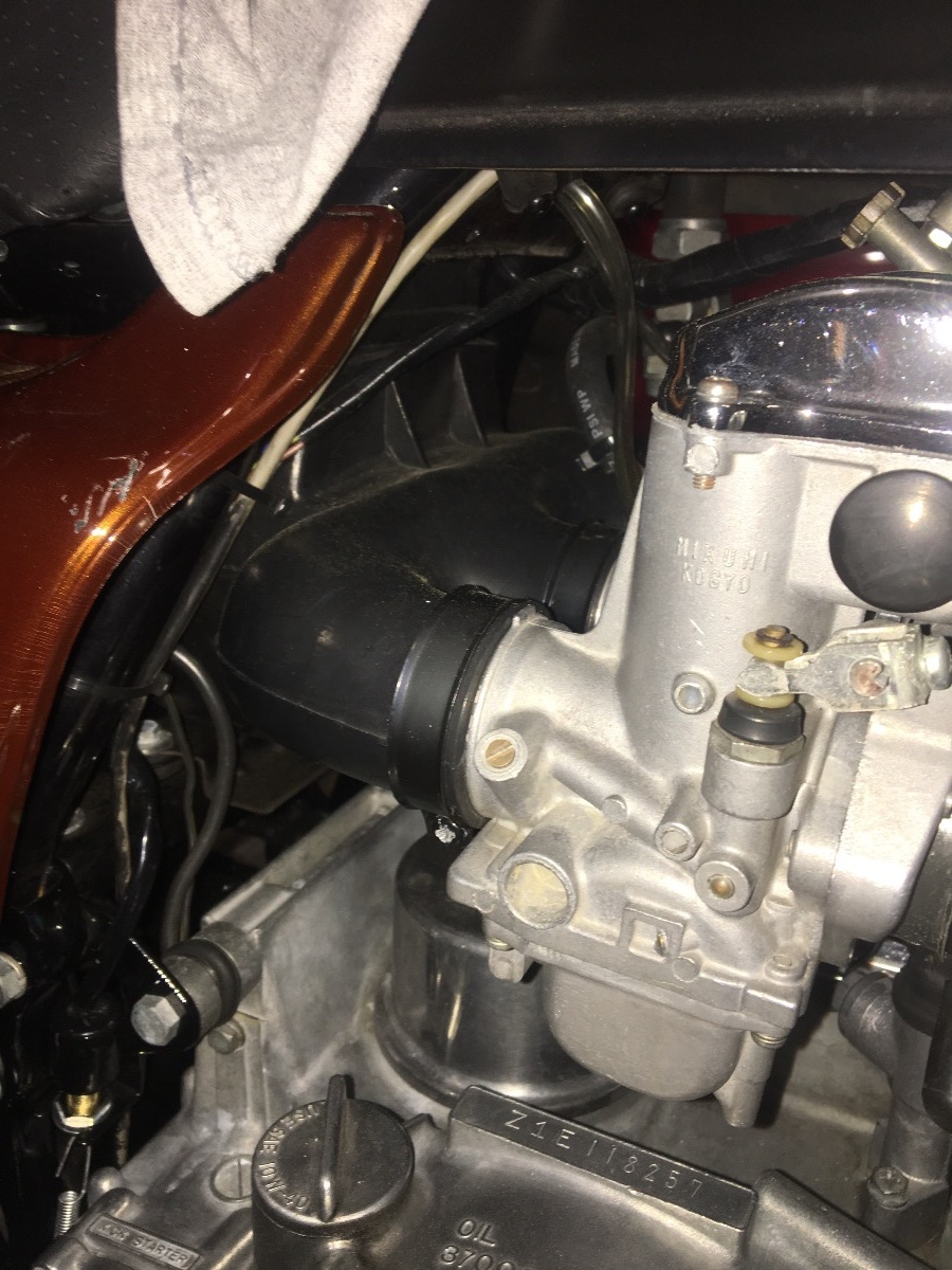

I had the 73-75 air box here and it would not fit into my 76 frame. Did you modify the box or just "shove it in"?

I agree with the other posts, fuel lines go up, but also you may have issues with the size of fuel line you have. You should look at getting fuel lines with a smaller OD.

03 Apr 2017 07:37At the bottom back of the box it has a support tab I had to cut that off because it would hit the frame . Other then that it works
