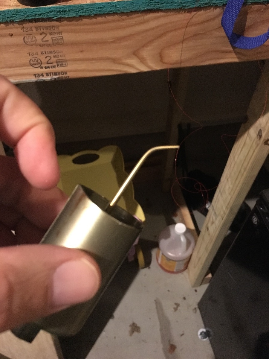

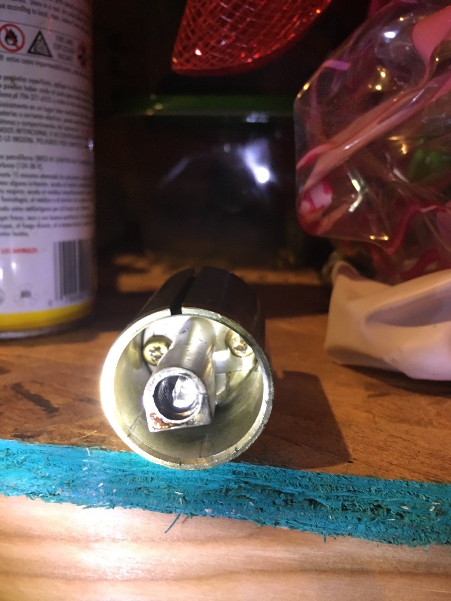

Carbs are off and mostly disassembled. Running into an issue with getting the removing the two screws down in the slide, holding the needle in. Two screws are already mostly stripped and I am not having luck with any others. Could these be the JIS screws that people are talking about? No luck with P2 head screwdrivers. Soaking in PB blaster now.

Pretty much every screw on any Japanese motorcycle will be JIS. Trying to use SAE Phillips screwdrivers will usually damage JIS screw heads, often to the point of no return.
Once the slides are out of the bore, heating the slide to about 250 F. will ease removal of the screws that attach the plate to the slide.

can you take some pictures of the two screws down in the slide?

Got the screws out on 1 of 4 slides. The other three are damaged. Sitting in PB blaster some more. I ran the heat fun against them for a while, with unintended results lol.
Someone near has two sets of z1 carbs on Craigslist. I am hoping I can get them for cheap. Cannot find any slides for sale online. Anyone know the part number?
