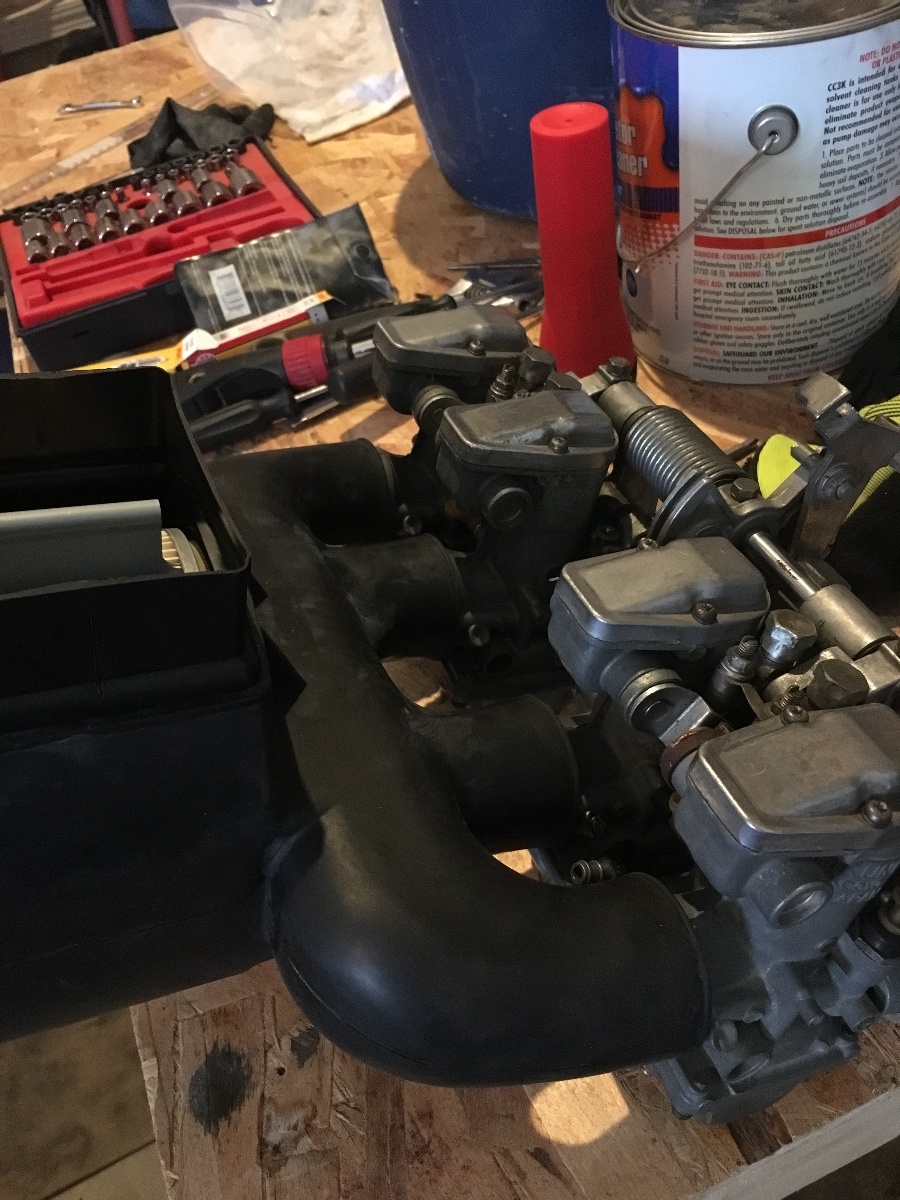

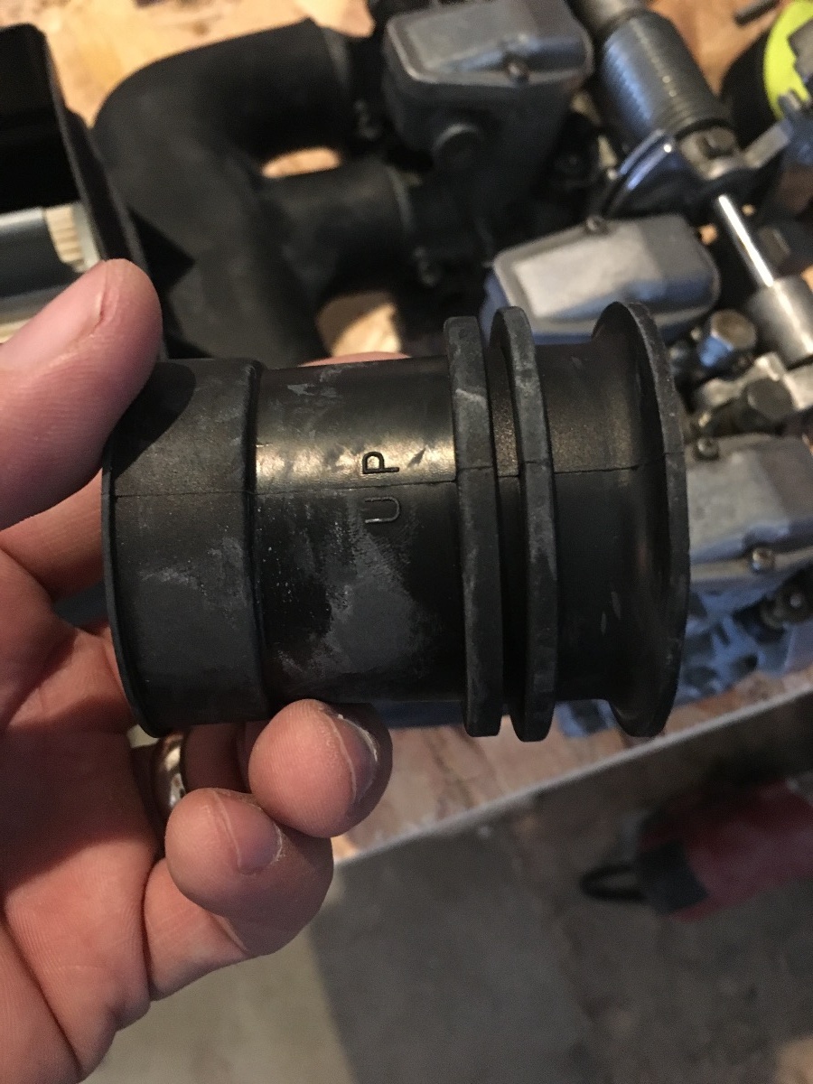

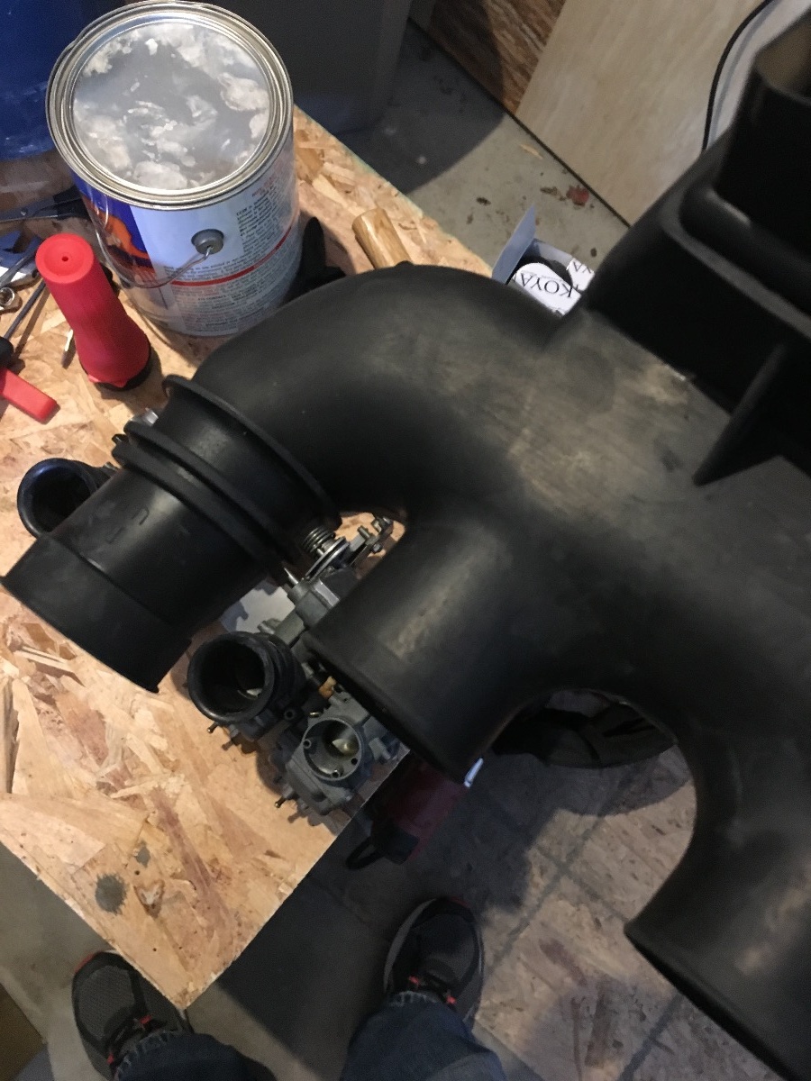

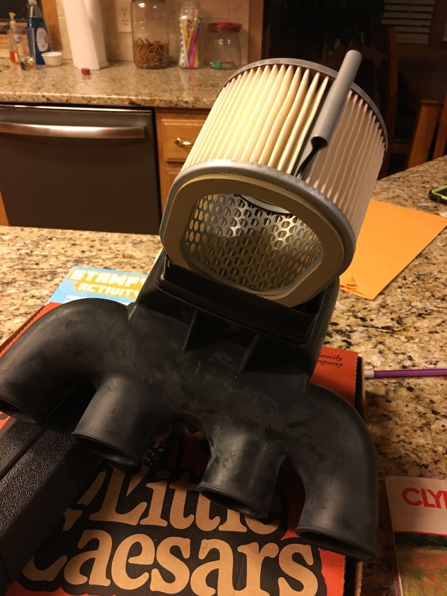

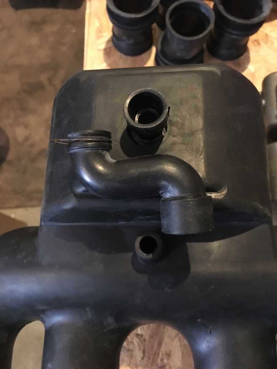

Made the filter fit. Now having trouble with the pieces I got in the mail. It doesn't look like an airbox will fit between the battery and carbs.
Do I have to use the short attachments or can I connect the airbox directly to the carbs?
If I force the rubber from the air box onto the connector it doesn't fit right.

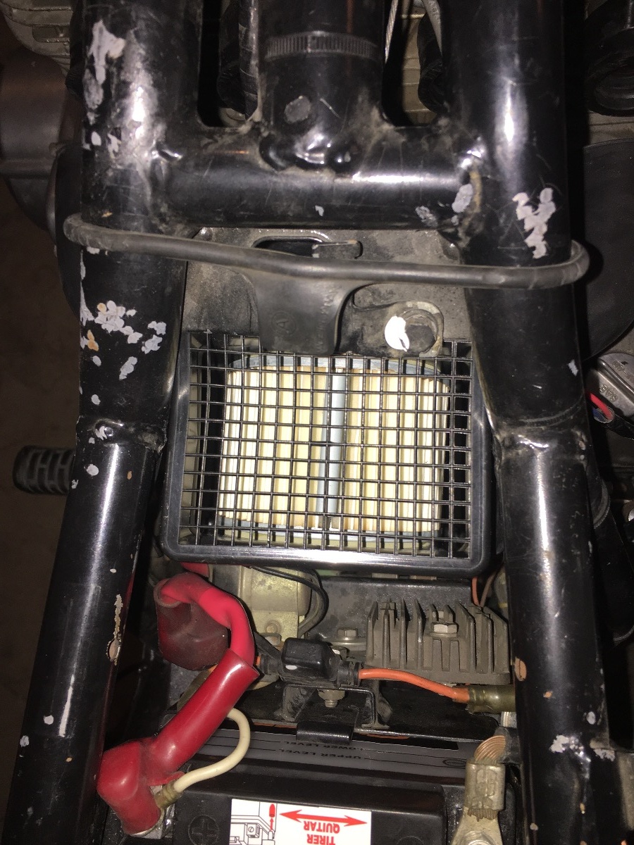

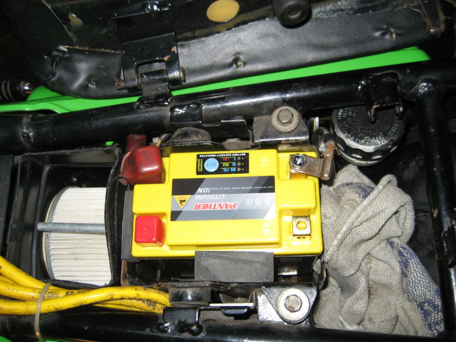

You have a 76 KZ900 bike. The filter body you are try to fit in is for 73 Z1 and 74-75 Z1A and B models.
Your battery holder is different mounted
My Z1B battery and filter body setup
Michael
Michael

25 Mar 2017 15:55Ya....I got so hung up on it being a 75 engine and carbs that I forget the frame is a 76.
From what I've heard, the 76 stock air boxes are hard to come by right? If I return this and cannot find the stock 76 airbox it looks like I'll be trading this in for K&N pods.

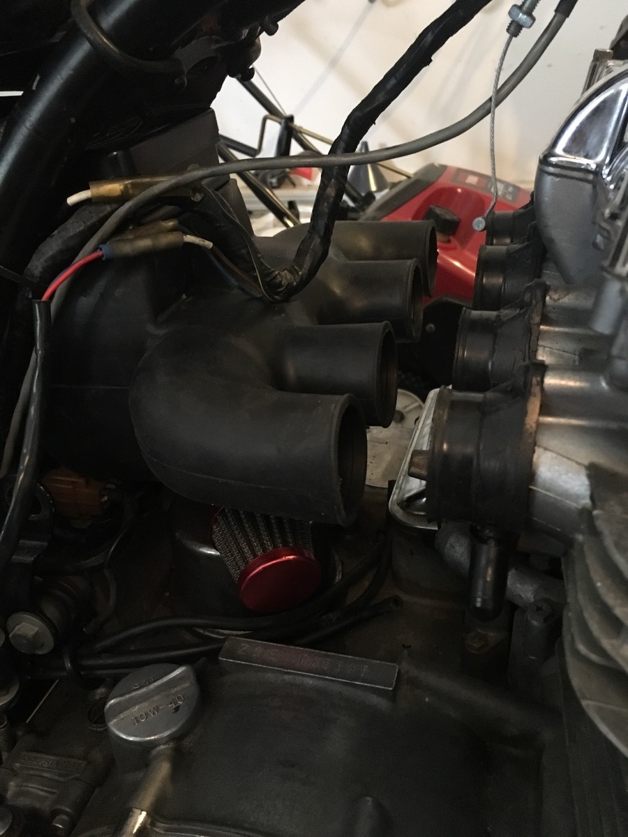

K&N Pods will be delivered today (cannot get my hands on a kz900 air box) and I want to do clear tube method.
Most of the videos I see show the clear tube hooked to the drain, and the drain is opened using an allen wrench or something. However my carbs only have a drain plug. In order to test it seems I will have to hook up the clear tube, fill with fuel, test, then drain, replace with drain screw and refill. It seems that I will have to do this four times, unless I want to cut 4 pieces of tube and do it all together. Does anyone have any other recommendations? I'd rather not do it 4 times, and I had to use a razor to cut the tube to fit in my drain hole. Thanks,
