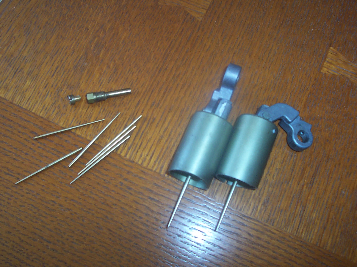

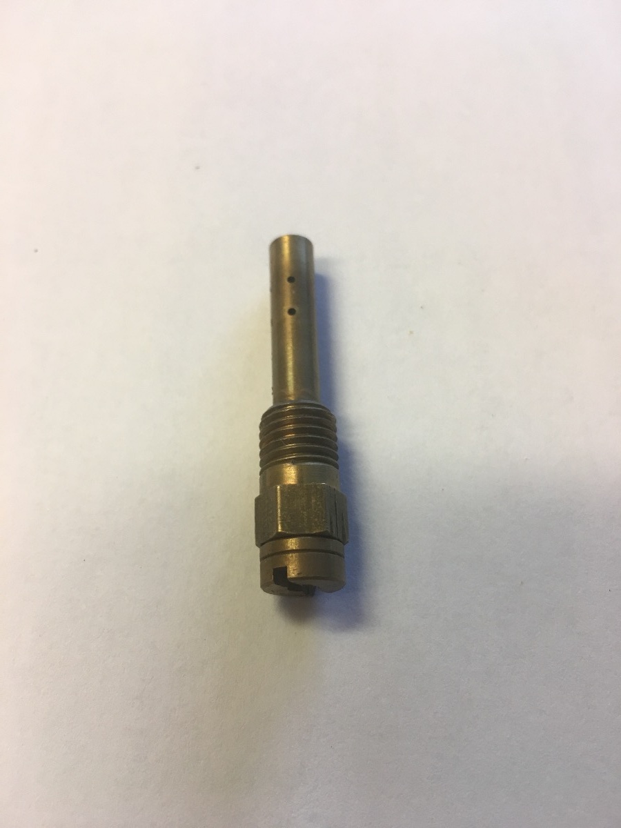

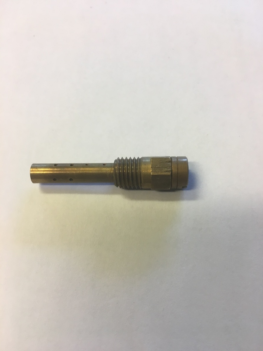

I can't identify my main jet. This is what came out from where my main should be.
Is this two parts or one?
The main for the z1 carbs says it is the large hex jet PN 04/042 however this doesn't look like the picture on the website

You have two parts there, the main jet and what is referred to as the holder.
