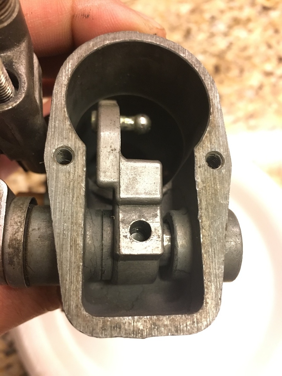

I have the carbs with the brass drain plug on the bottom instead of the 17mm hex head. I thought that was what differentiated the carbs.
Thanks,
I have the page bookmarked already haha. Based on that info I have the 75 z1b carbs. I realize now my thread still says kz900 carb re-jet. The frame is a kz900 the engine and carbs are from a 75 z1b. Sorry for the mixup.
I should probably also post the update on the jets that were in the carbs: 115 main jets and 20 pilot jets. The needles were clipped up to the 2nd position. Three of the cylinders looked to be very rich, as evidenced by the spark plugs on the last page. The 4th carb however had the slide moved waaaaay up and the sparkplug looks like that was running normal. I am still new to reading spark plugs so if anyone wants to take a look at them on page 1 please be my guest and post back with your findings.
Thanks,

Z-1B carbs differ somewhat from earlier Z-1 / Z-1A carbs. The most significant difference is the position of the enrichment jet well and tube in the float bowl and carb body respectively. Z-1 float bowl gaskets won't work on Z-1B carbs & vice versa because of the slight physical difference in enrichment circuit positions. The top caps are identical.

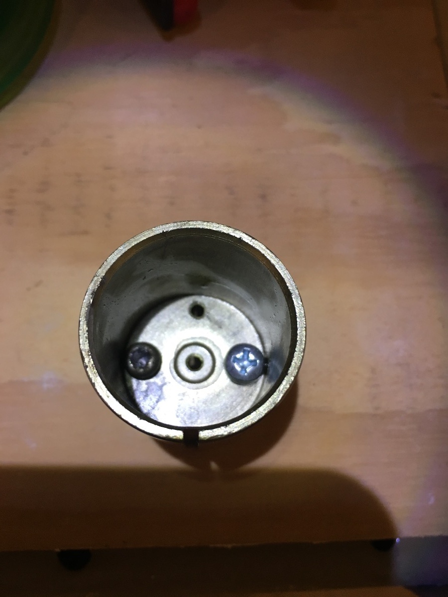

Working in getting carbs back together. Decided to buy new screws for inside the throttle body but they are going in very easily. Has anyone replaced these screws before and maybe can helmet me find an exact replacement.
Novice rider
1976 KZ900
1976 KZ900
- slmjim+Z1BEBE
- Posts: 1403
- Thanks: 896
Re: KZ900 Carb Re-Jet and Tuning
15 Mar 2017 10:09
Hi Conspiracy,
Kaw PN# 16033-015
They may or may not still be available from Kaw.
Also available from Fastenal:
www.fastenal.com/products/details/016318...22Split%20Lock%22$|~
Both of these will be JIS screws. JIS screwdrivers are strongly recommended when working on any Japanese bike.

Nooooooooo
Broke a bolt off. Have to get it drilled out probably. Ugh this is so frustrating.
