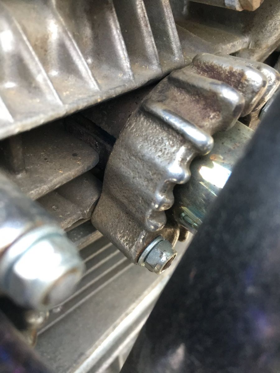

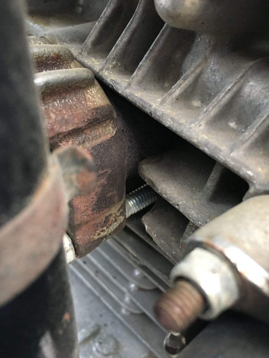

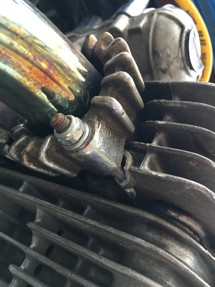

There are a few other issues that I hope to address but not sure if they are related to the carbs. One is that it seems the bolts that attach my header are not a proper fit against the engine. I will post pics to better explain. Please view the pics below. The first is what my exhaust bolts into on the right side of the engine. The next few look to be damaged where the bolt attaches the header to the engine. I have read that a incomplete seal at the exhaust gasket may also cause backfiring and think this may be contributing to my issues. Unfortunately I am not sure if that can be repaired for inexpensive.

Sure your bike is not a 75 Z1....someone could of swap the front end and by the damage on that exhaust bolt it may have been wreck.

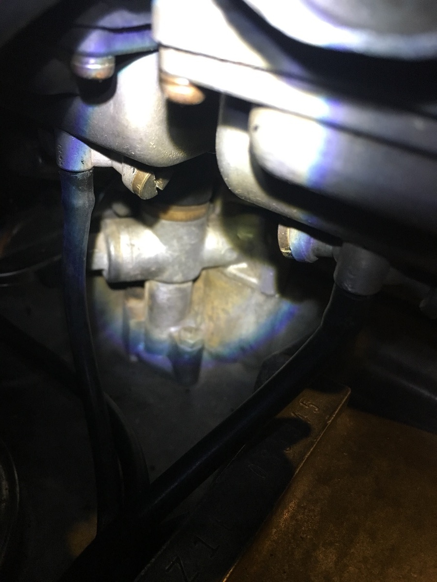

Also to note, my drain screws are pointing toward each other on each side. The example of the same carbs on wiresgeorge's website shows each side pointing outward. Is this a problem?

You will want your drain screws pointed toward the outside like shown in the picture. This way you can drain carbs bowls 1 & 2 from the left side of the bike, and 3 & 4 from the right side.
