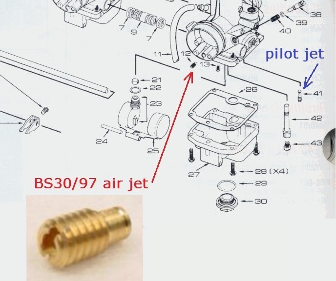

Possibly a problem with one or more of the BS30/97 air jets.
Might also benefit from new pilot jets.

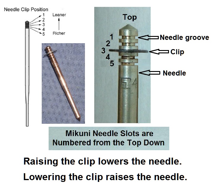

24 Sep 2015 09:26Dirtyhands wrote: . . . the PO was running a 135 main and 20 pilot with a higher needle setting . . . .
Would use the jet needle's middle clip position.
