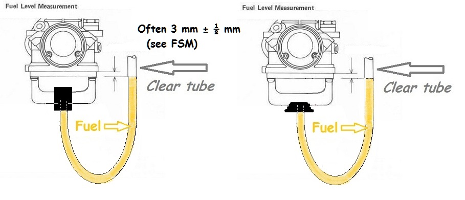

Did you clear tube test the bowls?

I have not . I bench set the float heights to 25mm but have noticed it will drip gas out of the fuel filter when parked . the bike is side stand only and is parked nose up on a pretty good hill so I'm not sure iif this is to be expected or a symptom of high float levels . I have to get the attachment that screws onto the float bowl so I can test them.

12 Sep 2015 16:53Dirtyhands wrote: I have not . I bench set the float heights to 25mm but have noticed it will drip gas out of the fuel filter when parked . the bike is side stand only and is parked nose up on a pretty good hill so I'm not sure iif this is to be expected or a symptom of high float levels . I have to get the attachment that screws onto the float bowl so I can test them.
Can use a conical rubber grommet or section of rubber hose fitted into the drain hole which serves as a connection for the clear tube.
Have never used or needed the "special tool."
Minor gasoline seepage, if it can't be avoided, doesn't affect the clear tube test.

That's a cool trick Patton, Thank you! I'm gonna give it a shot come my next day off. Would an excessively high float level contribute to fowling plugs?

12 Sep 2015 19:41
Yes and more.
