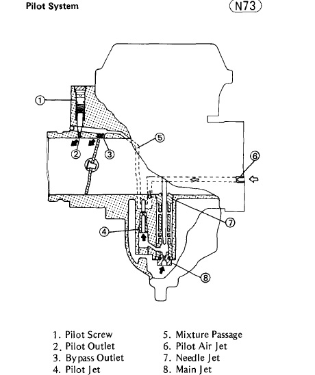

If the carbs were gunked up then some of the the jets especially the pilots are probably still blocked. Soaking isn't enough and if not done already then you will need to poke through the jets and passage ways with a fine wire or guitar string.
Pay special attention to to the pilot system shown in the schematic below (BS 34 carb I think but close enough to the Keihin CV34) and make sure you can spray carb cleaner in at 4 and have it exit at #3. There are 3 holes at #3 and you will need to operate the throttle flap/buttelfly just a bit to be able to see them. Wear eye protection when spraying carb cleaner !
Since the bike is new to you there are a few other things you could check while you plan to have the carbs off.. Start with a search here for "clear tube method" for checking fuel level in the carbs. Check the carb diaphragms for holes. Make sure all the right bits are there like caps over the pilot jets
Good luck. It will be worth it in the end
PS Get a fuel filter if you dont have one and and check if the vent in the gas cap is blocked - try running with the cap open. Petcock blocked ?

JR wrote: Hi
Hi, Thanks for the help,
Ive poked the jets through already on first clean with some nylon wire and can see daylight through all holes etc, there was however a small hole on one of the diaphragms which i have managed to repair with a small amount of silicone and seems to be holding well but i will try to replace this asap, they seem to be quite hard to come by however and quite expensive to replace! on ebay seem to be going for around 50 quid for just one so can understand why ive tried to repair it for now ;)
I've also done the clear tube method for the float bowls and they levels seem to be sitting just at the point of where the top of the bowl screw heads are which seems to be a good level to me?
I will make sure the #3 to #4 channels are clear and check that tomorrow. The pilot caps are in place and seat ok but if these were slightly loose would that cause noticeable problems if fuel was leaking past?
I will also try running her with the tank cap open, i did put a fresh inline fuel filter in and drained the tank of the old petrol and also checked the fuel tap and filter which were both spotless.
Ill see how it goes and report back,
Cheers :)
It sounds like you have been very thorough so hopefully you are almost there and the problem is with the pilot system - it took me 2 months to figure that out and fix it when i got my bike first 11 years ago
Most home diaphragm repairs seem to be temporary. Some people have reported varying degrees of success using superglue or that stuff used to dip tool handles. Here is a link I bookmarked a few years ago jbmindustries.com/ and they should be able to help and I doubt shipping to the UK would be excessive. I remember there was a similar type company in the UK and you had to send them you old slide and diaphragm and they would fir a new diaphragm or send you a replacement but I also seem to remember they were a bit on the expensive side.
Excellent ! I did find that actual measurement rather than eyeball was critical but if level at the screw top then that sure does sound like 4mm plus or minus 1.
If the caps are snug they should be fine. Hard to say what would happen if they were loose. For sure I know if they fall out then my bike wont start :laugh:
One last thing. Is there any evidence that the previous owner has messed with the carbs ? Are the jets the stock sizes ? jet size is usually stamped on the jet and with my eyesight I need a magnifying glass to see it
Last edit: 17 Dec 2014 12:26 by JR.
