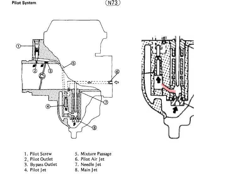

20 Jan 2015 09:20Apologies if already covered, but note the small passageway where fuel from the main jet gets to the pilot jet.
The small passageway must be clean and clear and unobstructed.
It's not enough to clean only the pilot jet and other passageways.
One method to try cleaning the small passageway is to spray carb cleaner into the main jet while blocking any escape route except through the pilot jet, and watching the spray exit via #2 and #3 orifices into the carb bore.
