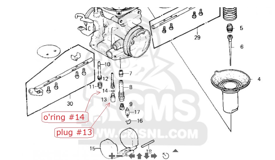

27 Dec 2014 16:46The pilot plugs do t seem that snug however so I think I will replace the o rings in those also.
Could be the problem or part of the problem. I had a problem with pilot plugs last summer and I used rubber or neoprene type pilot plugs from a goldwing I think ..... maybe a suzuki.. on a temporary basis. They worked fine for a week until they fell out at which point the bike totally refused to start :laugh: I bought 3 different sizes of Keihin O rings and best fit ones were to big on the outer diameter but I filed them down with an emory board or nail file until they fit and they worked just fine.

KK where are these pilot plugs ? Got any pics.
Been looking at diagrams and not sure what you mean.
Do your air mix screws go in top of carb bodies ?

I see - you have a rubber plug and oring on top of pilot jet.
None on the CV 32's.

Zepryrrider
The pilot jet on the CV34 gets it's feed from under one of the other jets (the primary main I think but not totally sure) via a little internal channel. No cap then to much feed/gas and poor or no running

JR is correct. The pilot jet is fed through a passage that starts in the shaft of the main jet and it goes to the shaft of the pilot jet. Make sure that this passage is clean as it feeds gas to the pilot jet. Make sure you put the caps back on the pilot jet shaft, so that it is closed, if the caps go on loose, replace the O rings, they should go on snug so that gas does not go in.
