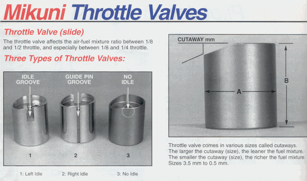

As I think mentioned, the slide cutouts can be different depending on which brand the carbs were originally built for. It would be a good idea to insure that all four have the correct cutout. There's no telling what might have been done over the last four decades.

When you say slide cutouts do you mean the holes at the bottom of the inside of the slides? I'll do a bit of online hunting to make sure they are correct, thanks.

Throttle slides among various carb designs have different cutaway sections on the air intake side of the slide.
