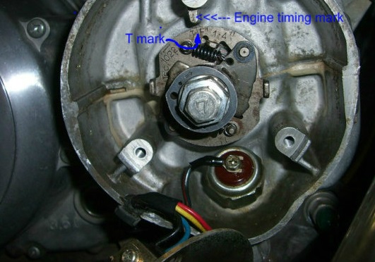

If you have not done it already then checking the advancer berhind the timing plate and making sure it is lubed up the pieces and springs are moving freely would very definitely be good. I think you may have done this though. The timing should be set from the factory and nothing to do there.

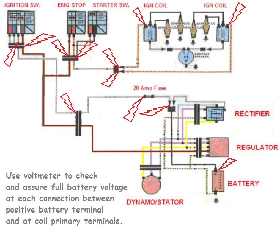

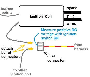

Many old bikes lose voltage between the battery and the ignition coils leading to poor spark.When checking coils try unhook the red lead from coil and connect a meter between the red and the frame or motor and see what volts read. In theory you should see 12 volts DC but less than 11 could be a problem with spark quality.

Also at risk of sounding a bit stupid and newbie here is timing advancer only on kick start engines? Mine is electric start only and can't seem to find where the advancer cover is, right hand side lower panel with kawaksaki on it perhaps?

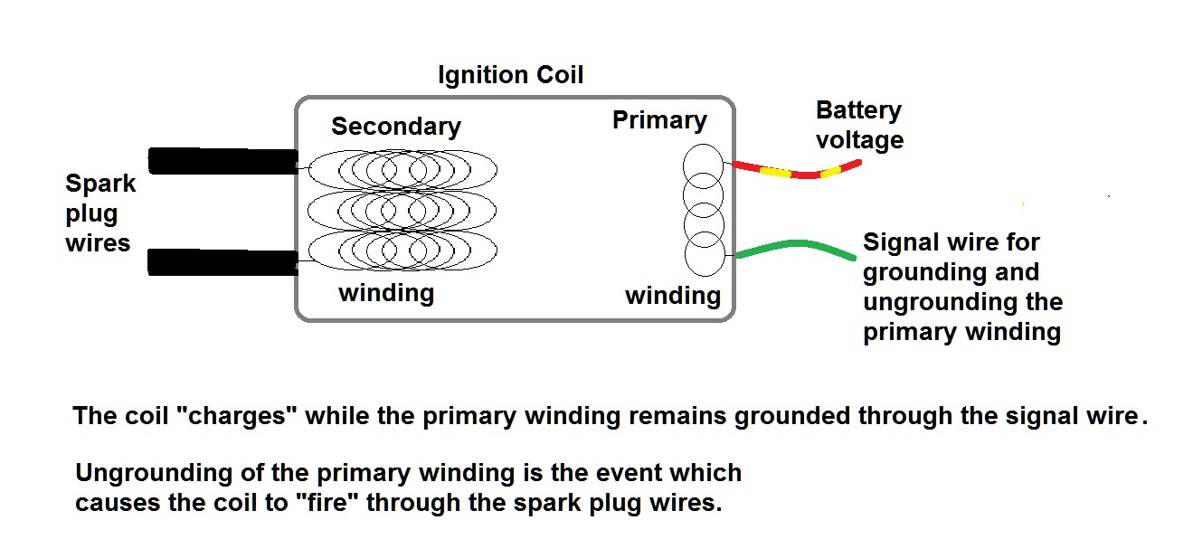

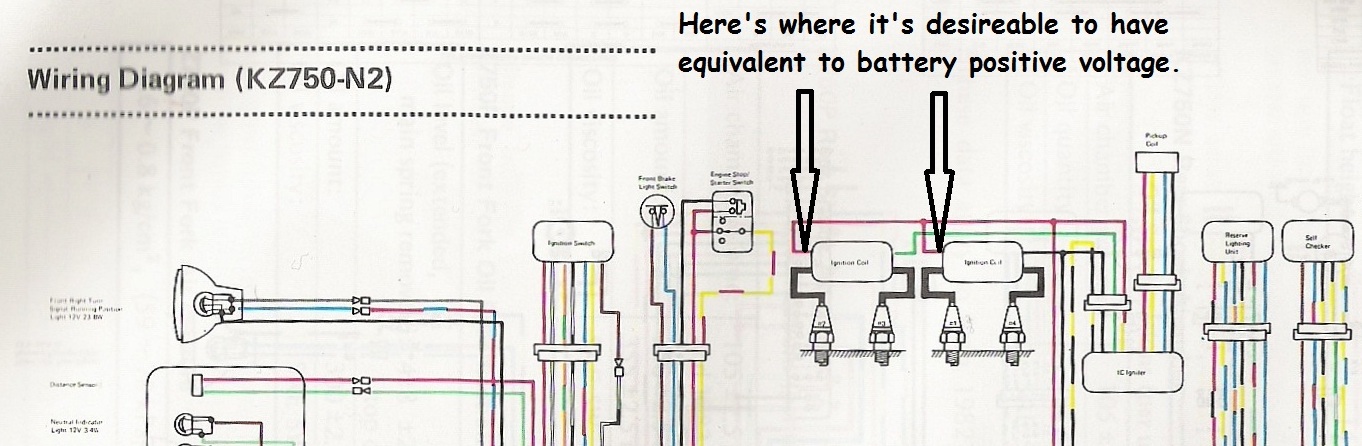

With ignition switched ON, engine running or engine not running, voltage being received at the coil primary terminal should ideally be equal to the battery's voltage as measured across the battery posts (terminals).
Perhaps these illustrations will help indicate where to measure the coil's receipt of voltage when the ignition is switched ON.
If there's a significant voltage loss somewhere between the battery and the coil primary terminal, here are are some places to measure for possible site of the voltage loss.

09 Jan 2015 08:18 - 09 Jan 2015 08:22is timing advancer only on kick start engines? Mine is electric start only and can't seem to find where the advancer cover is, right hand side lower panel with kawaksaki on it perhaps?
Yep
Right had side as you are sitting on the bike shiny CD sized cover with Kawasaki on it. held on by 2 screws. Take it off and you will see a brass plate with 2 black thingies onit. These are the pulse coils for your electronic ignition. They send signal to the coils telling them when to fire. The timing advancer is behind this plate. Remove the 3 screw which hold this timing plate and you will see the advance. It looks something like this
When the engine runs and the crank turns faster and faster the 2 movable pieces on the advancer move outwards and advance the timing. Maximum advance is usually about 3 or 4000 rpm but definitely worth a look. If crud covered and the springs are stuck it should be cleaned and lubed. Patton has better pics of this
Check your Haynes manual. Also see here mbsween.bike-night.com/kz750l3/manual.html for a factory manual. It wont be exact for your model but good enough for most things
Check manual before taking a wrench to either of the nuts in the photo. If you need to remove the advancer loosen the small nut and if you need to turn the crank use the larger nut only and please double check what I just said

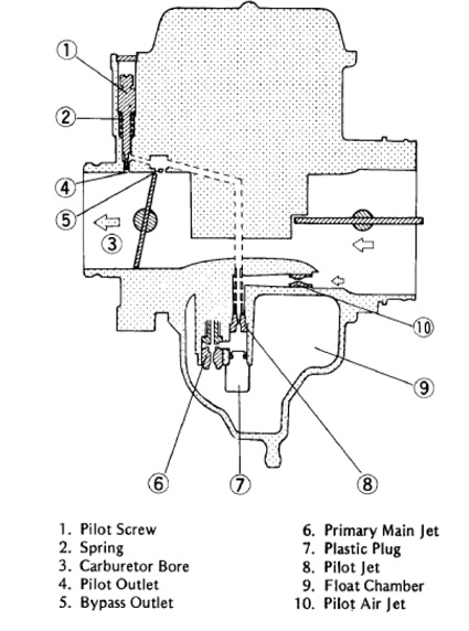

The other thing i had a look at whilst i had the carbs off (that i was pondering about before on here) was those pressed in 'jet needles' and whether they could be taken out and replaced in case i swapped the 'needle jets' for the N01A types, and they do indeed just pop out when pressed on after removing the jet needle holder. So seems this is still a good secondary option for tuning these carbs up in case the other stuff doesnt help with the non 6k+ revving side of things.

SK - do you mean the 4 little brass holders that sit in carb bodies ?

Yeah, its like this bit in the middle of the pic:

It's critical to pilot circuit function that the orifices #4 and #5 are clear and clean.
Would assure being able to see carb cleaner spray spewing into the carb bore when sprayed into the pilot screw hole (screw removed) and when sprayed into the pilot jet passage (jet removed).
Also critical that the tiny short passage between #6 into the pilot jet is clean and clear, and that the plug #7 is fitted upon reassembly.,
