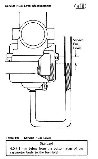

Also im a bit confused on this bit as im reading different things on fuel levels, can anyone tell me where i measure the float bowl fuel level from? is it the top of the bowl as in the line where the bowl separates from the top of the carb (where the gasket is) or lower down from where the top of the indented bowl edge bit is?
Cheers
The idiots at Royal Mail managed to lose my new diaphragm i ordered from NRP carbs after taking it back to the post office and subsequently filing it in some god knows where place, so frustratingly havent been able to change that out yet, Lucky i have those other carbs coming next week though so i hopefully get a good one off them even though my second fix appears to be holding for the mo.
I took the bike out again today for a quick ride, it still feels like a big lean issue, the bike bogs a bit when revving from idle, and the revs hang or go back to idle really slowly from 3k downwards. i can get the bike to rev a little higher in neutral now, still only up to 6k or so but hard to get it over 4-5k when riding.
Im wondering, if im getting hanging/slow back to idle revs is that more likely to suggest an external air leak rather than an 'in carb' type of lean fuel condition?
Thinking again about changing the manifold to carb rubbers for new ones just in case.

Hanging idle could be a small air leak, sticky throttle cable, carbs badly out of synch
Measure the service fuel level at the seam between the carb bowl and the carb upper body. Use a ruler or mark the tube. I found that eyeballing the level was not good enough. If the level is out of spec then turn the carbs upside down, measure the float height and bend the tang so that the float height is adjusted the required number of mm.
The pic below is taken from the Kawasaki shop manual - the one from mbsween's site. The carb section is worth a read
Good luck
Good luck
