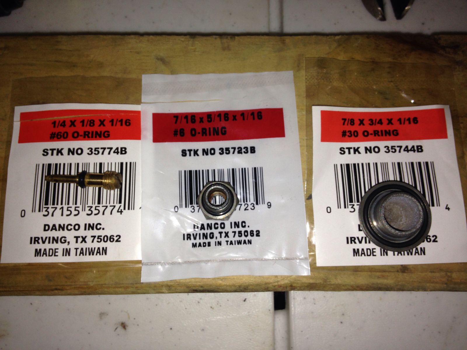

So z1E is out of the parts I did for the 29mm. Walk in to Ace Hardware and found all the O-Ring I needed.
Choke Plunger , Air Jet and Bowls O-ring
Here's a pic and # and dimensions of each O-Ring
I will be making my own gaskets . Pics on that later.

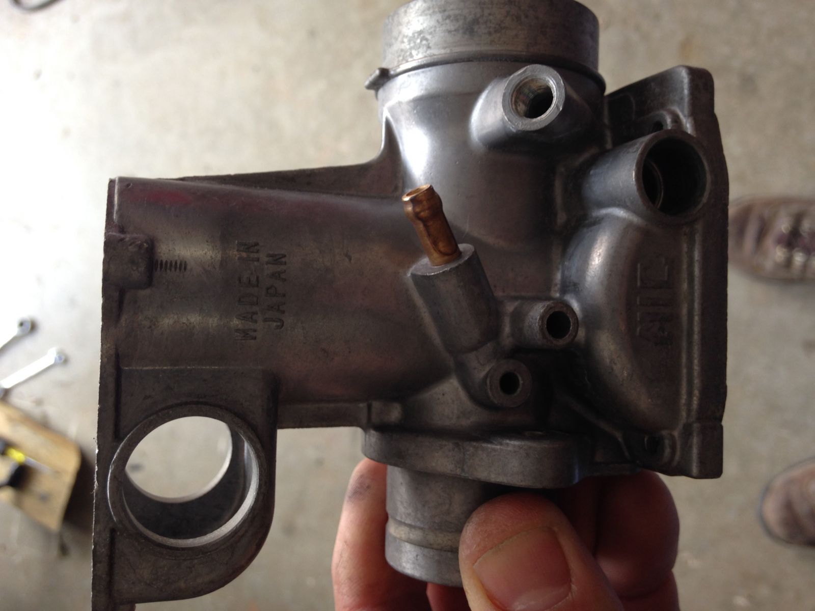

Also having a hard time seeing the # on the Pilot System jet thinks it's say #6.

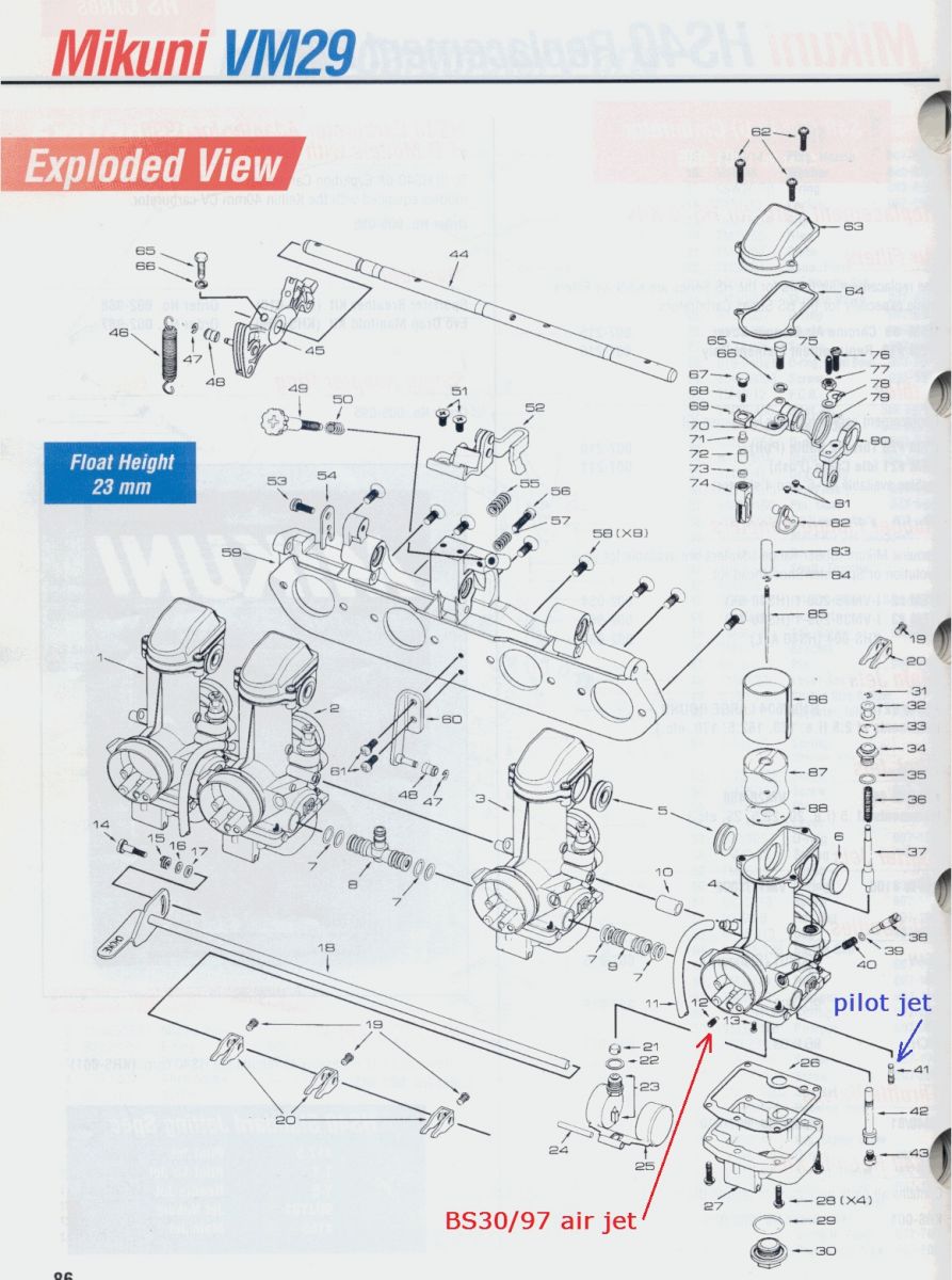

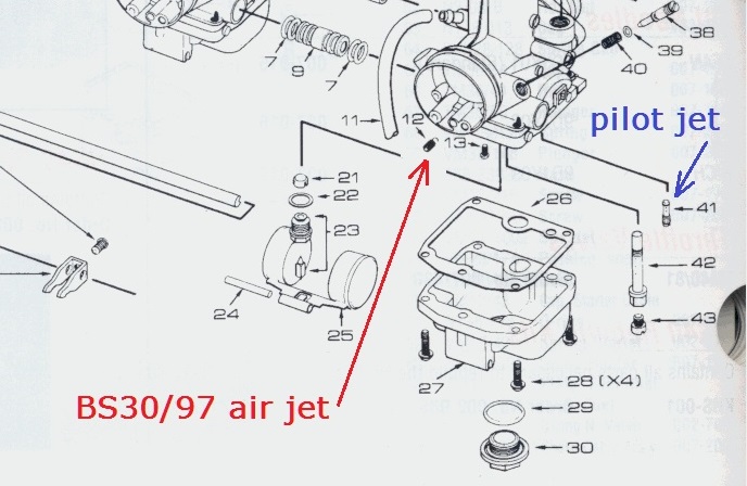

24 Jan 2015 14:09spdygon wrote: ...29mm...Also having a hard time seeing the # on the Pilot System jet thinks it's say #6.
The carb guide at Z1E shows:
Pilot Jet 17.5 or 20.0 (or 25 in the later versions)
www.z1enterprises.com/Z1CarbGuide.aspx

That was a air bleed jet. Shouldn't be bad if clean. Try your local MC dealer or jetsrus on line.
- Posts: 18567
- Thanks: 2103
Re: Clear tube float adjustment on 29mm
25 Jan 2015 03:39 - 25 Jan 2015 03:58Z1E lists the BS30/97 air jet.
www.z1enterprises.com/ItemDetails.aspx?i...hbore&item=SU002-154
