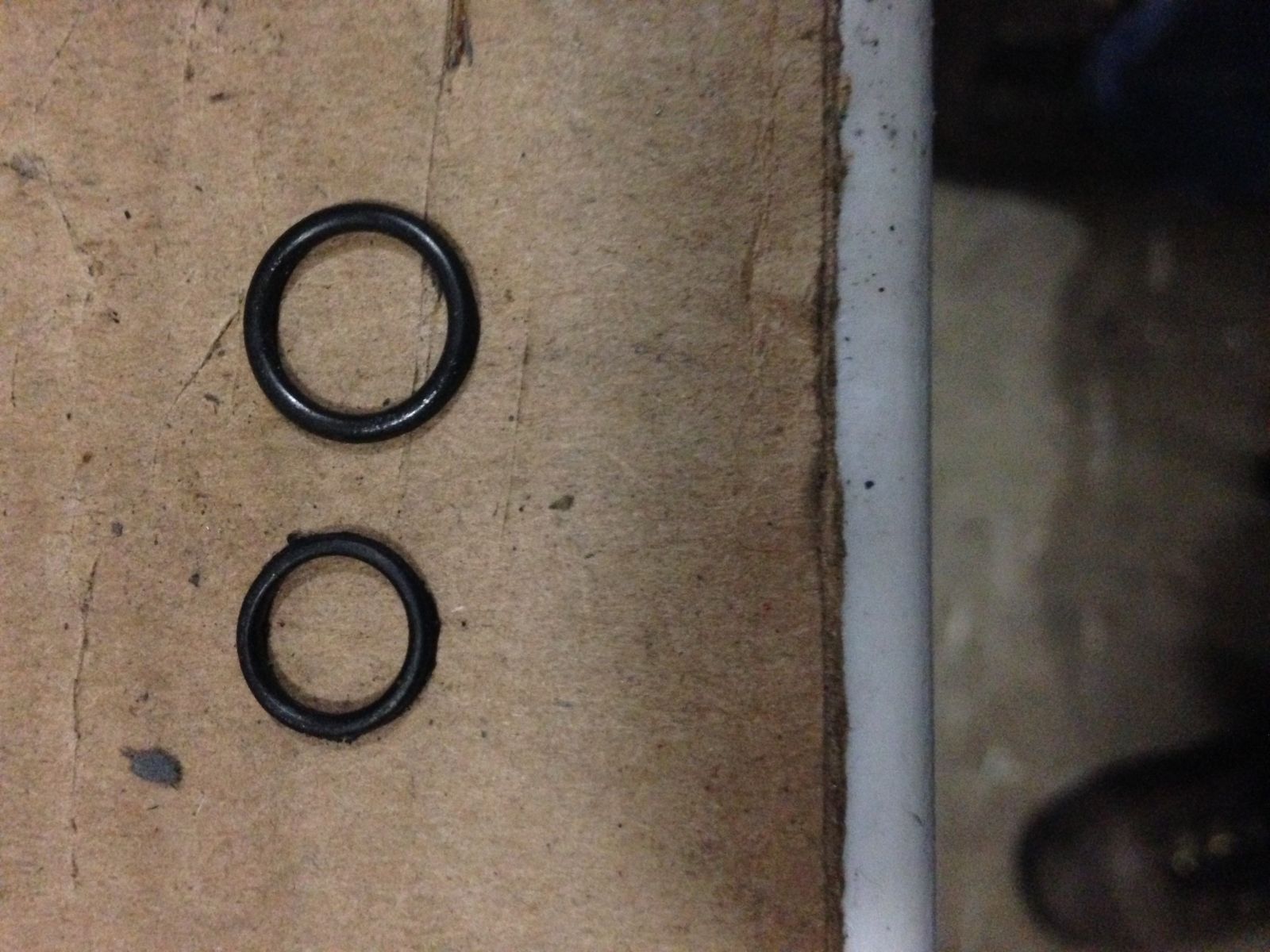

finally fix......as metion before. i ordered a carb repair kit from z1parts.net for my 26mm.
was able to work all o-rings in place ( being they were little over size ) except for the choke plunger o-ring. those were to big so i had left them out as they seem not to bad.
Patton suggest to bench sync...so decided to do that again with same result. today i stop by ace hardware and match 4 new o-ring.
and that fix the problem....idle fully adjustable from 0 rpm up to about 4k rpm.
i called z1 last week and left a message with no return call yet....so i email them yesterday with pics and no responce yet.
Pic are the choke o-ring..left original and right is new
