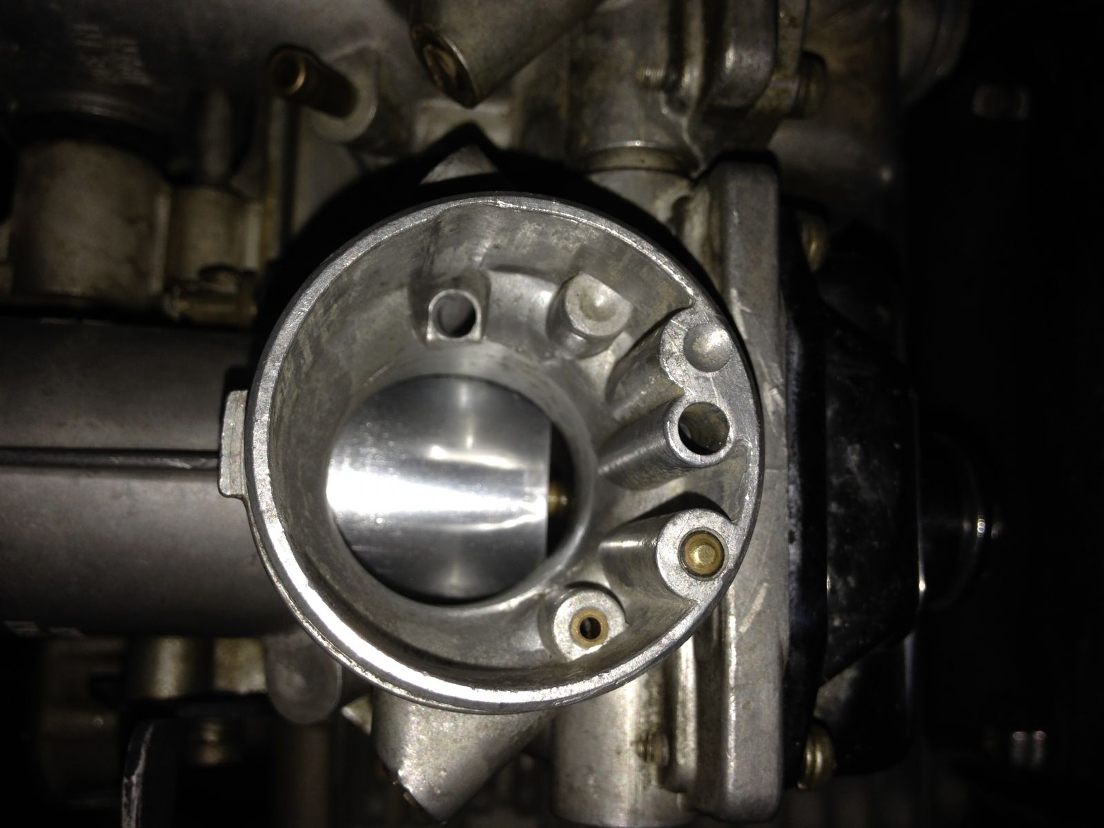

Ok I was wrong the air jet down in the hole next to the brass plug.
When I got mine one of the pilot's was stripped so I used a VERY small drill bit and a ez-out
to get it out.

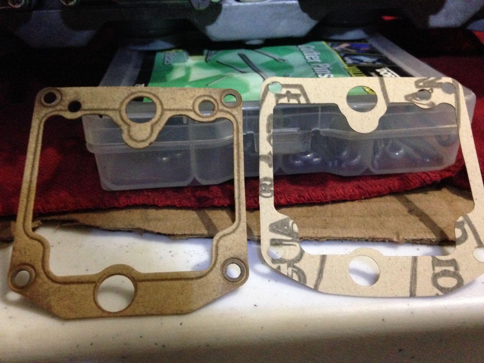

more work done.....

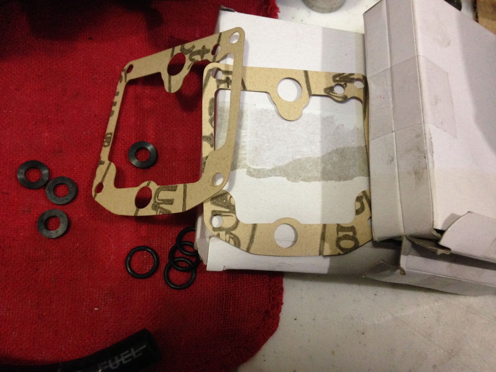

while back ordered and rebuilt carb kit , card screw kit , aluminum T's among other parts for my 26mm.
so i finish rebuilding the carbs yesterday install on my bike and fired it up....sounded graet all cylinders now firing correctly.
10 minutes later notice gas ( wetness) from carb 1 , 2, 3 not 4. so i check float level and adjust.
today i did a bench test to check for gas leak and found gas wetness coming from between carb and bowl. gasket not sealing correctly.
kit i got seem to be universal...as pic show....gaskets are paper..
no one else had this problem?

What brand kit? There are some bowl gaskets that are too thin and dont seal correctly and others that are thicker and give enough squish.
Or your bowls could be tweaked

so found why the gaskets from the bowls were leaking....
pic on left has a hole on left side of gasket
as u can see the other gasket is a little wider then the first one use...still work them on

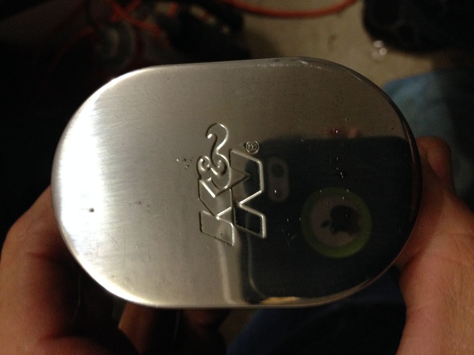

went looking for my orinigal K&N filters to clean and use
