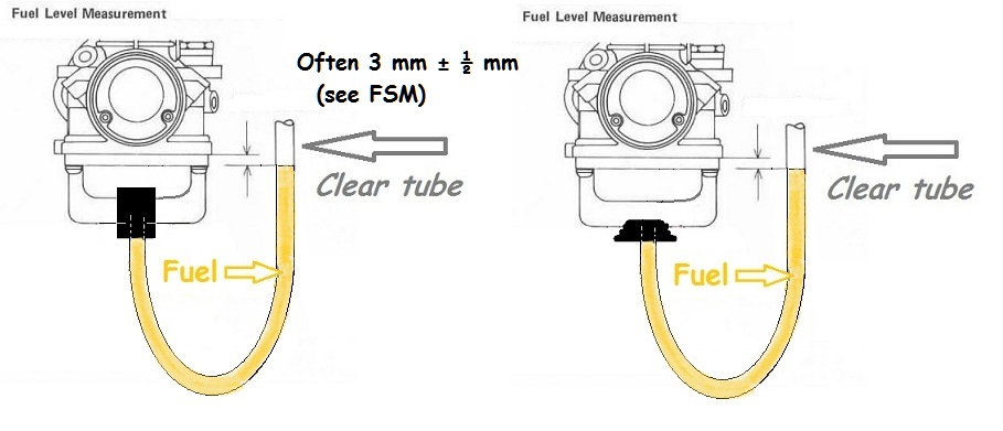

My 79Kz1000Ltd came with 29mm carbs.......where can i get a nut witha drain tube ?
I need to adjust the float level...

Can just use a larger piece of hose (self-threaded into the open drain hole) or a conical shaped rubber grommet (pressed into the open drain hole) to seal the drain hole and accommodate fitment of the clear tube.

I found that it's best to use the smallest diameter tube you can find. That way it's easier to expel all the air from the downward section of the tube. Any air trapped in the down section of the tube will result in an inaccurate reading.

went back to z1enter and found them....$25 for one thats alot.
back in the days i use to do them by measuring the height ....carbs up side down.
clear tube seems like alot of work.....

It can be but think about it no two float's weigh or float the same
so measuring them can be off.

Tube is best.

11 Nov 2014 12:34Yes it is additional work, but you get it right the first time. I tried the dry float upside down thing and it is not accurate. After 6 times and the carbs still leaking I gave up and bought the clear tube tool. It took all of the fustration out of it and they were spot on the first time.spdygon wrote: went back to z1enter and found them....$25 for one thats alot.
