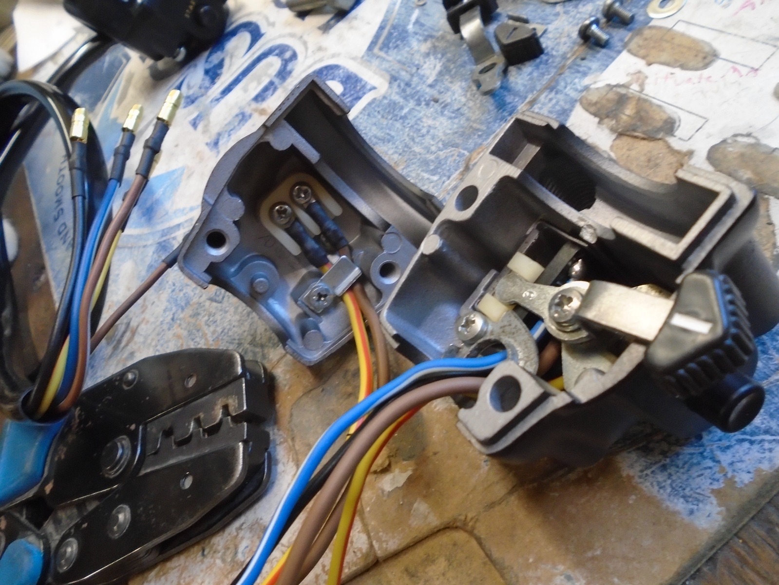

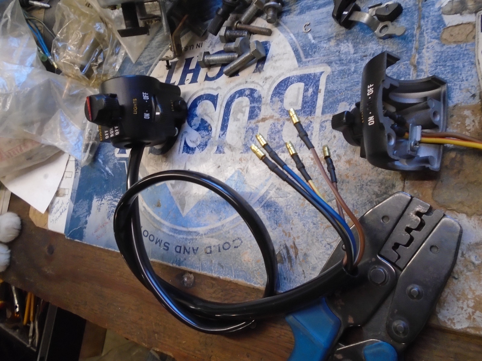

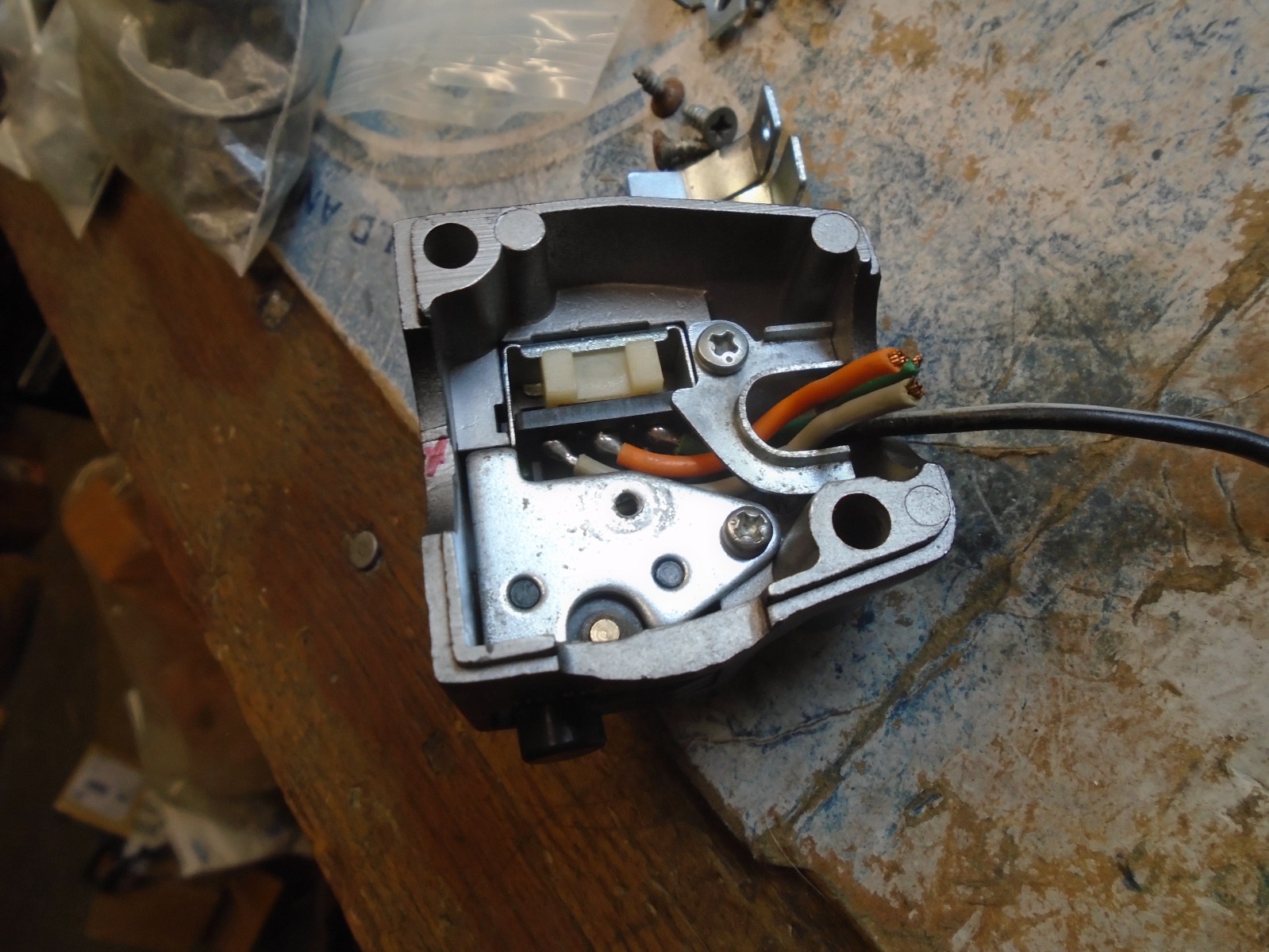

Some pics Rich. Seems my old little camera takes better photos then my "smart" phone. Finished out the "ready to apply" one with proper 4mm male terminals with sleeving.
The following user(s) said Thank You: MFP-Joe, kimchella

Re: Handlebar switches
07 Mar 2025 08:50
#909768
Looking great Clay 👍👍👍

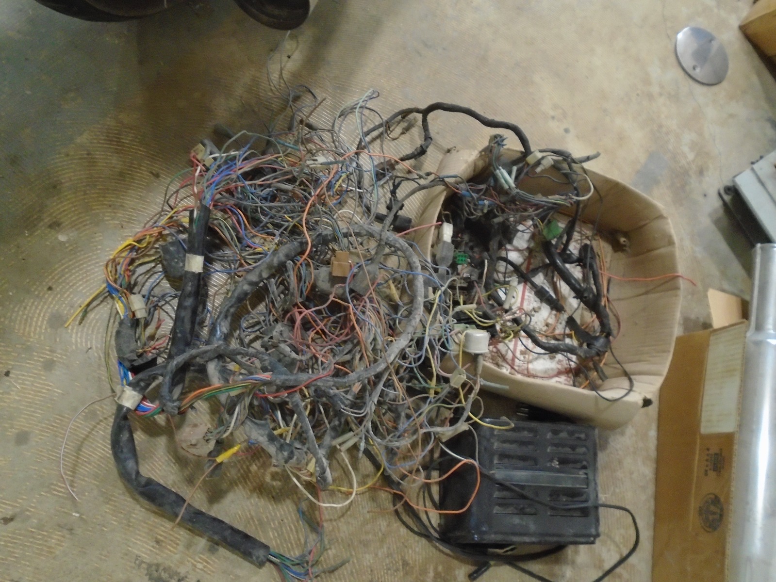

Considering where the starting point was, yes, keen. Really just have to have stuff to rummage thru, this i have. A little from that box, little more     from another and before ya know it..gathering is complete.

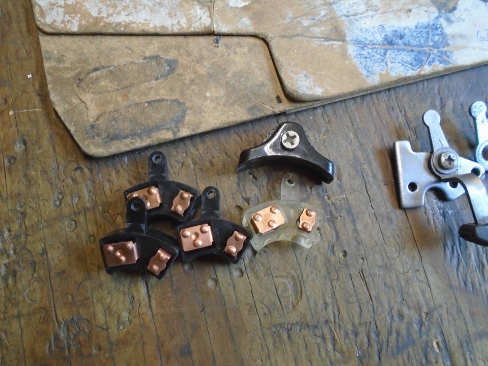

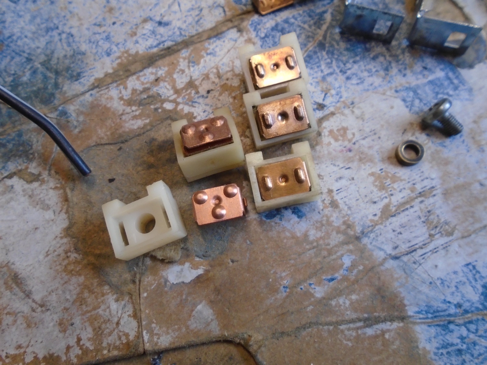

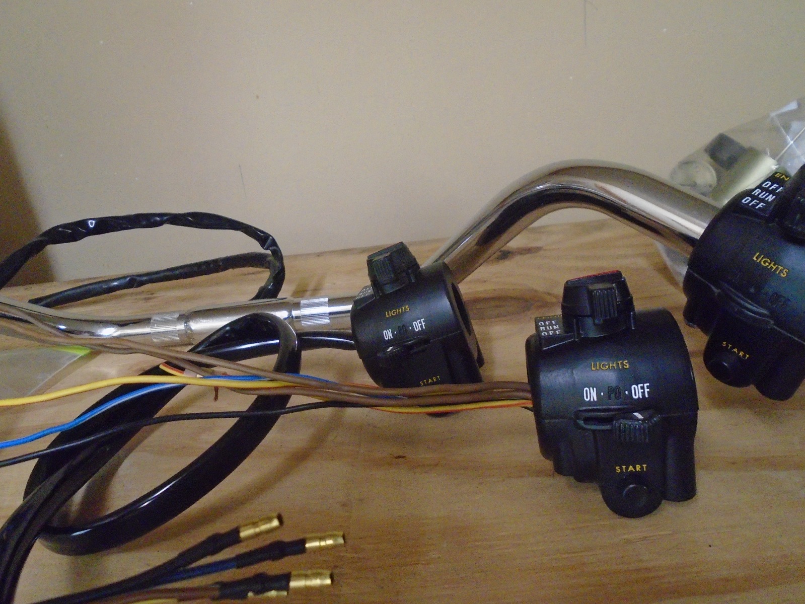

#909808
Thank-You Joe, i revel in authenticity. Just my bag i suppose. Some last pics Rich before i bag/tag and post. Shown is the starter of what You'll need if in case you need another. All the stuff is within, fully functional sans wiring and sheath. I just truly wish Asahi Denso (AD) had maintained the material used on the earlier Hi/Lo switch. Earlier ones were almost indestructible, black plastic. They changed to the brittle translucent ones starting in 1976. They are a bear because they "snap-off" and even NOS ones are so paltry they too crack. Anyhoot, ones you'll receive are fully intact. Straight breadboard and selector, just have to be handy with a pencil soldering iron. Groovy..
