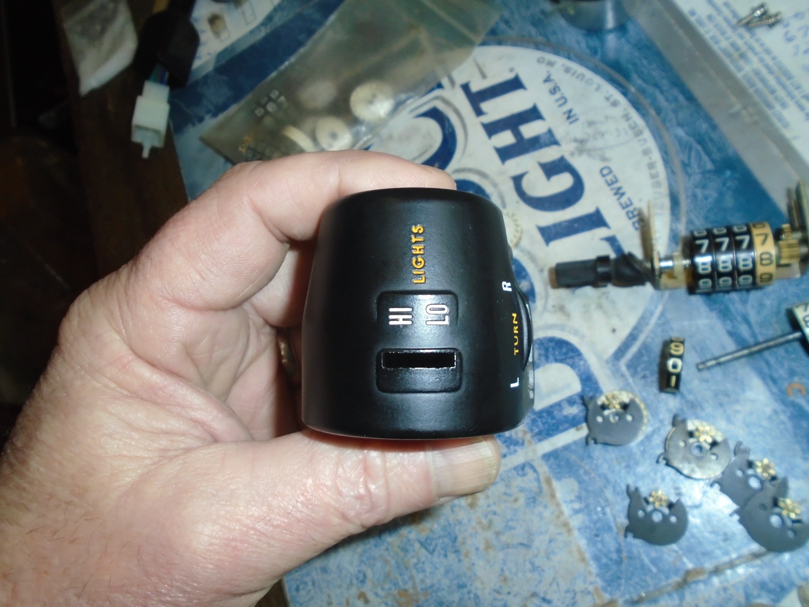

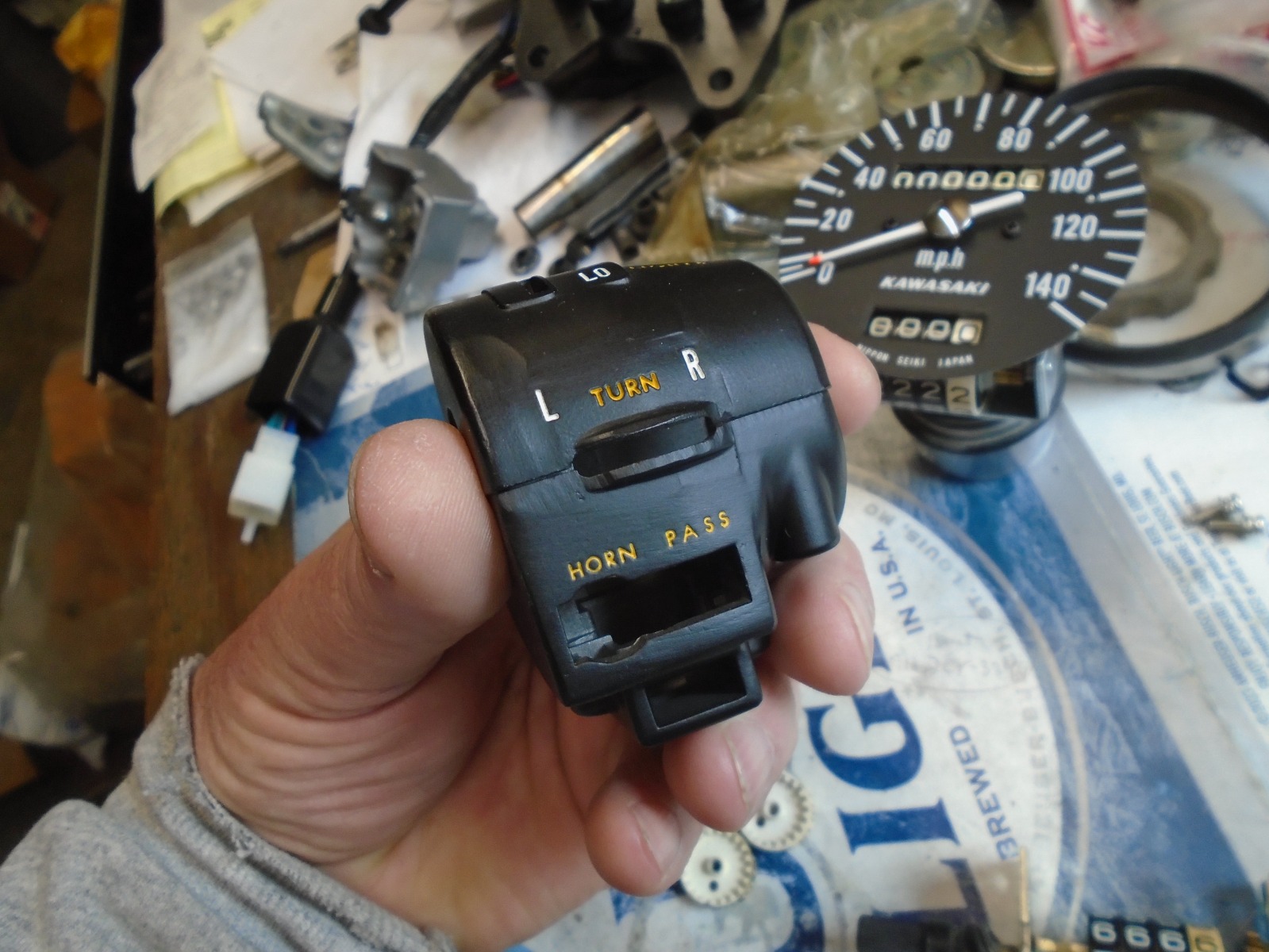

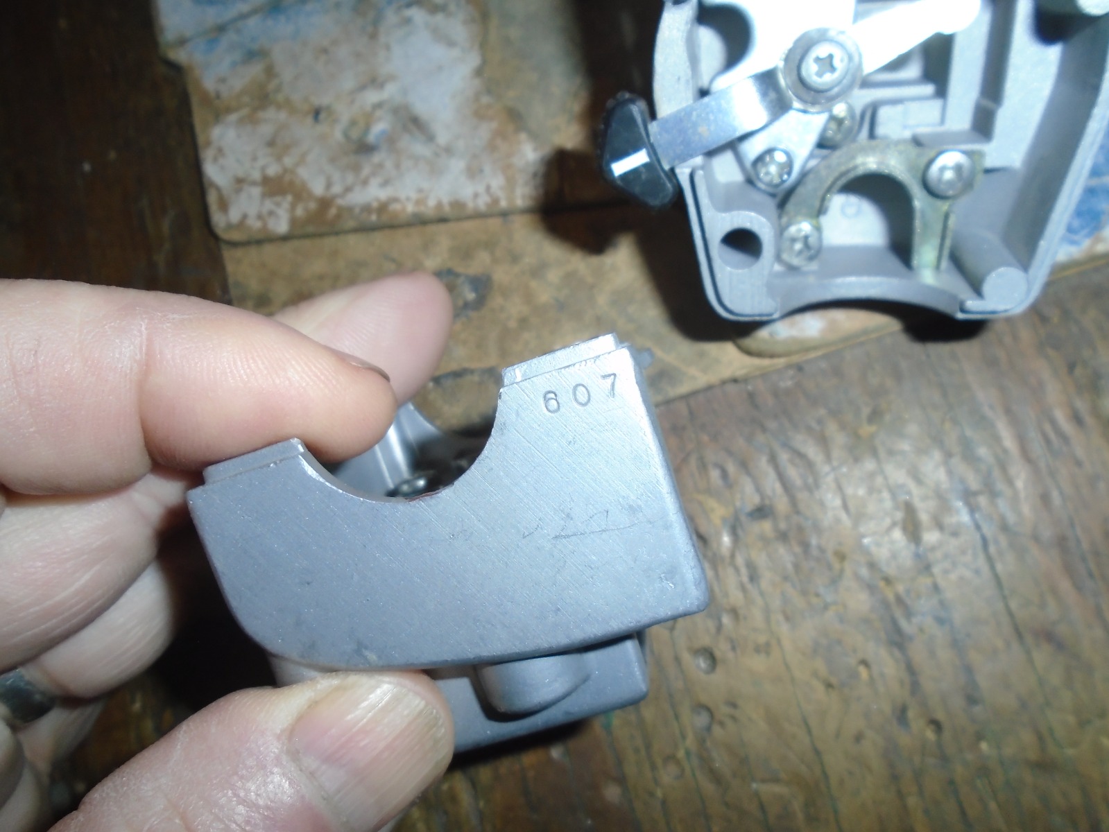

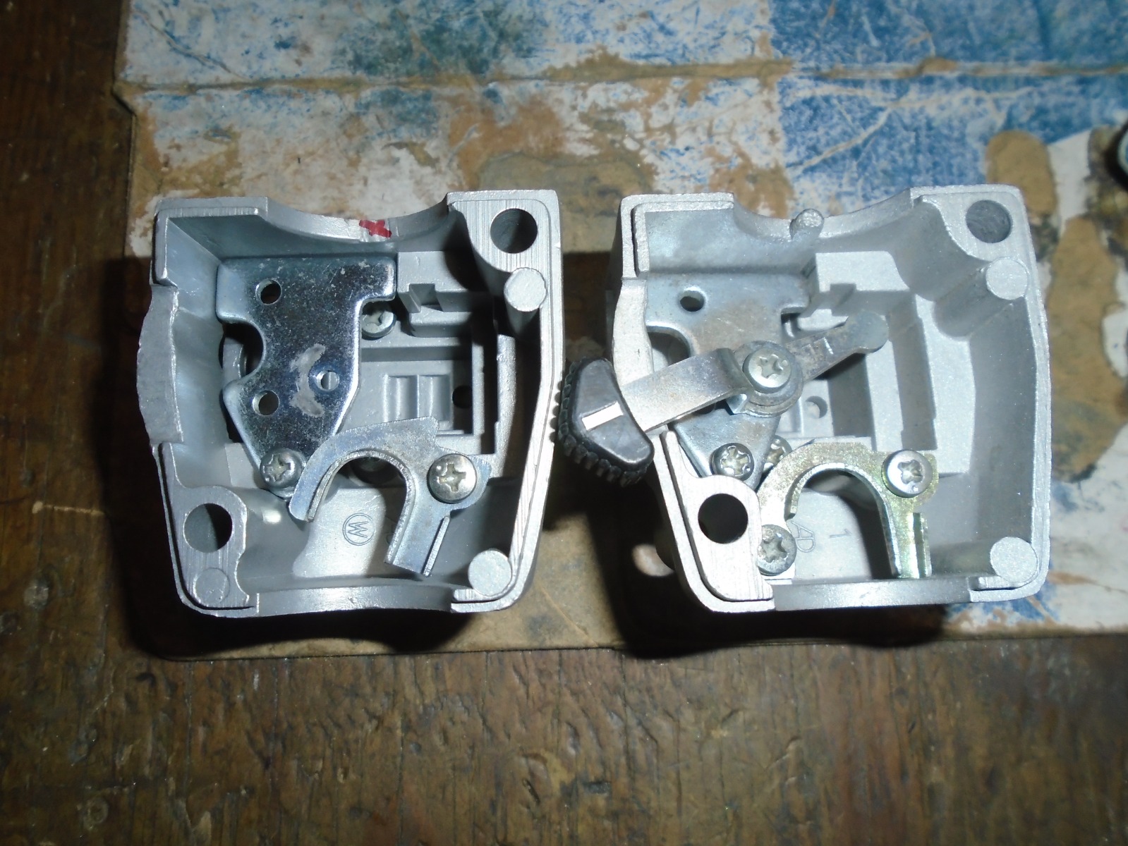

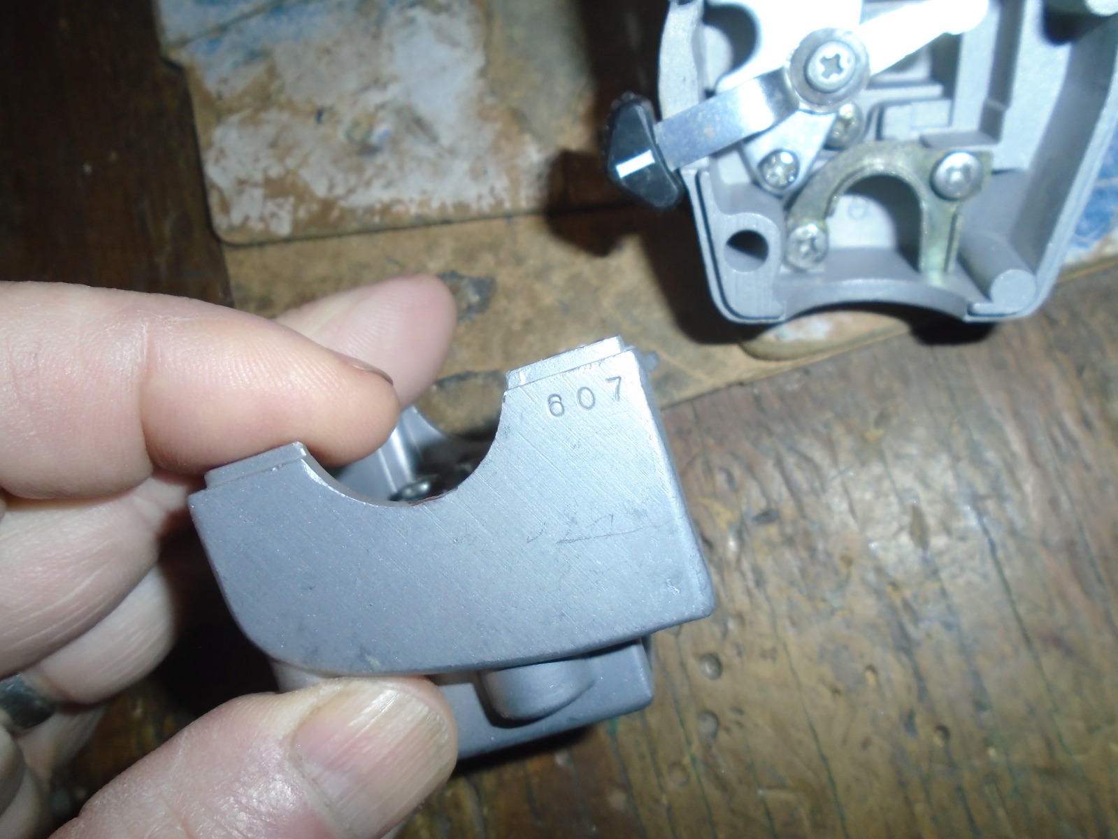

That's a bummer, thought You were in the states. Not a problem though, well versed in International shipping. I don't think the PM system works here anymore? Saw the Picture of Your bike in another post, looks Great! Something to look at please. If original handlebars i believe you'll have a singular locating hole on the bottom side of handlebar on LH switch, note in photo. Also they slightly changed the design, still manufactured by Asahi Denso (AD), thru the years. Note first generation used just one screw to retain harness bracket, later changed to two and bracket changed to accept. One shown is July of 1976 or 607. I have all the parts here.

In the meantime figuring out the possibilities for communication, wife is off on weekends ya know. How handy are you Rich. seems you've gotten this far without assistance! Here's an option. Because you already have the bones of what's required to make it "pretty". I can just send you bits to glam it up..and info where needed. took it on myself to finish-out that 607 lower date-coded shell for the LH switchblock. I can easily tell you how to achieve the same! Nothing special tool wise, just technique.
