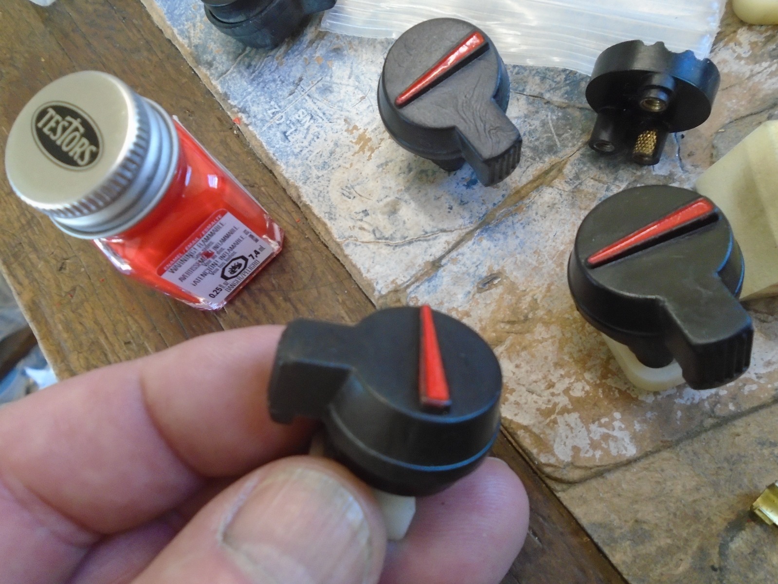

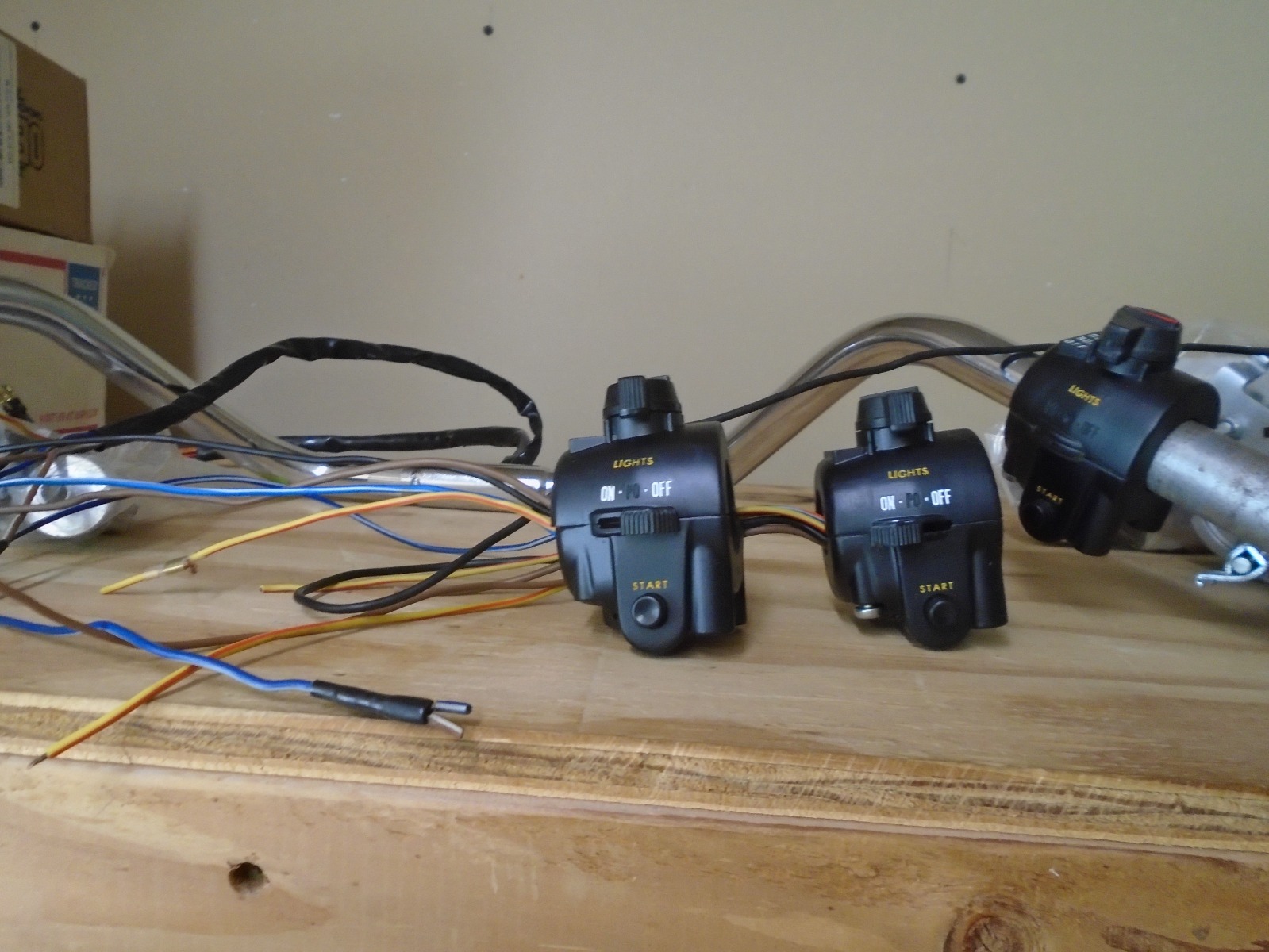

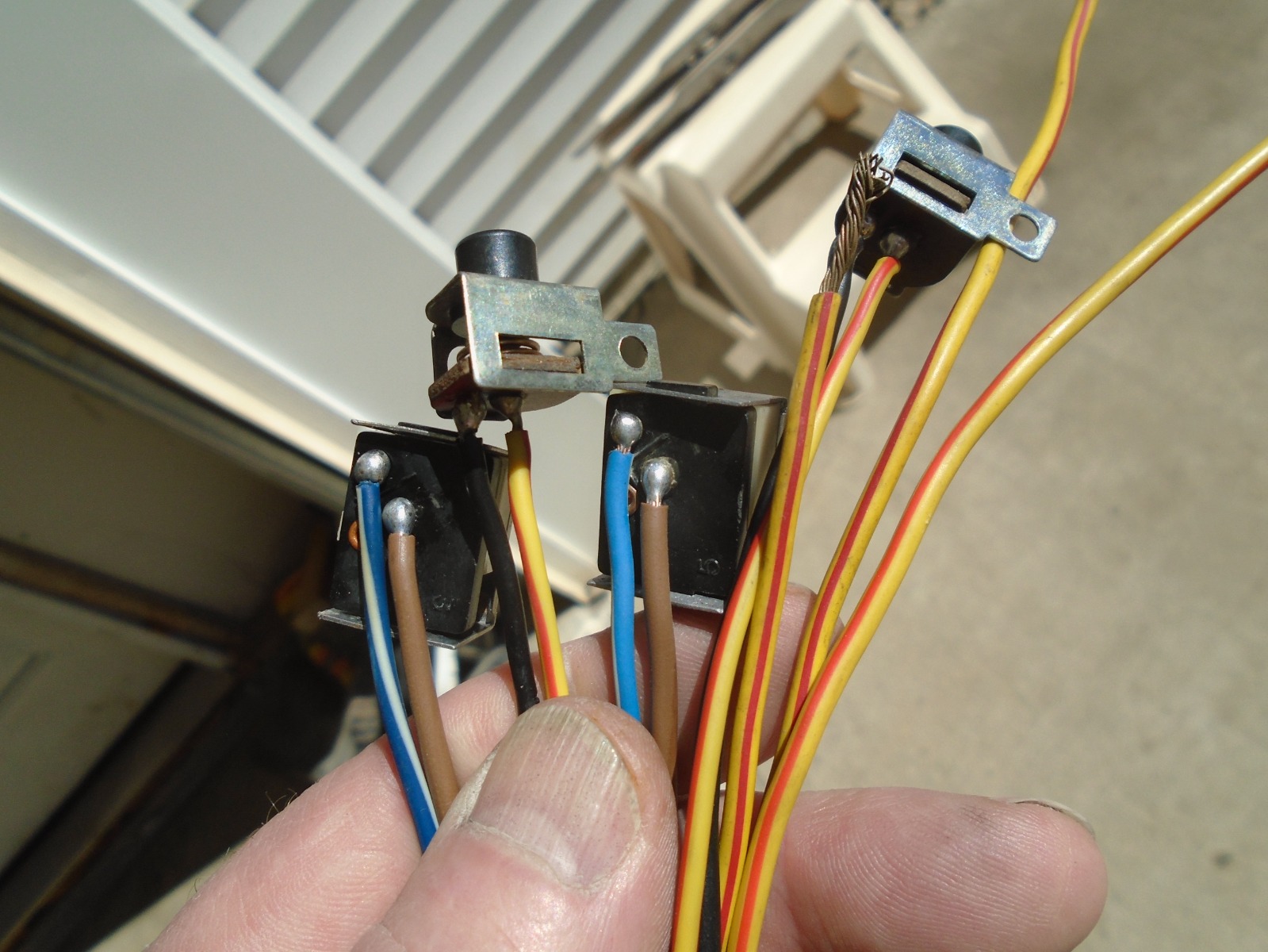

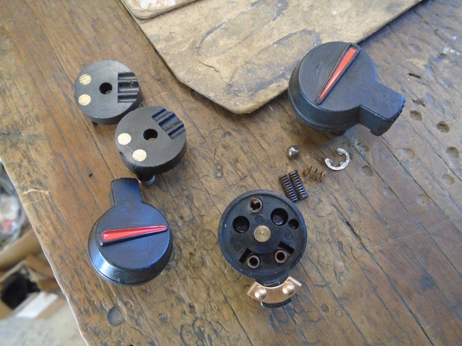

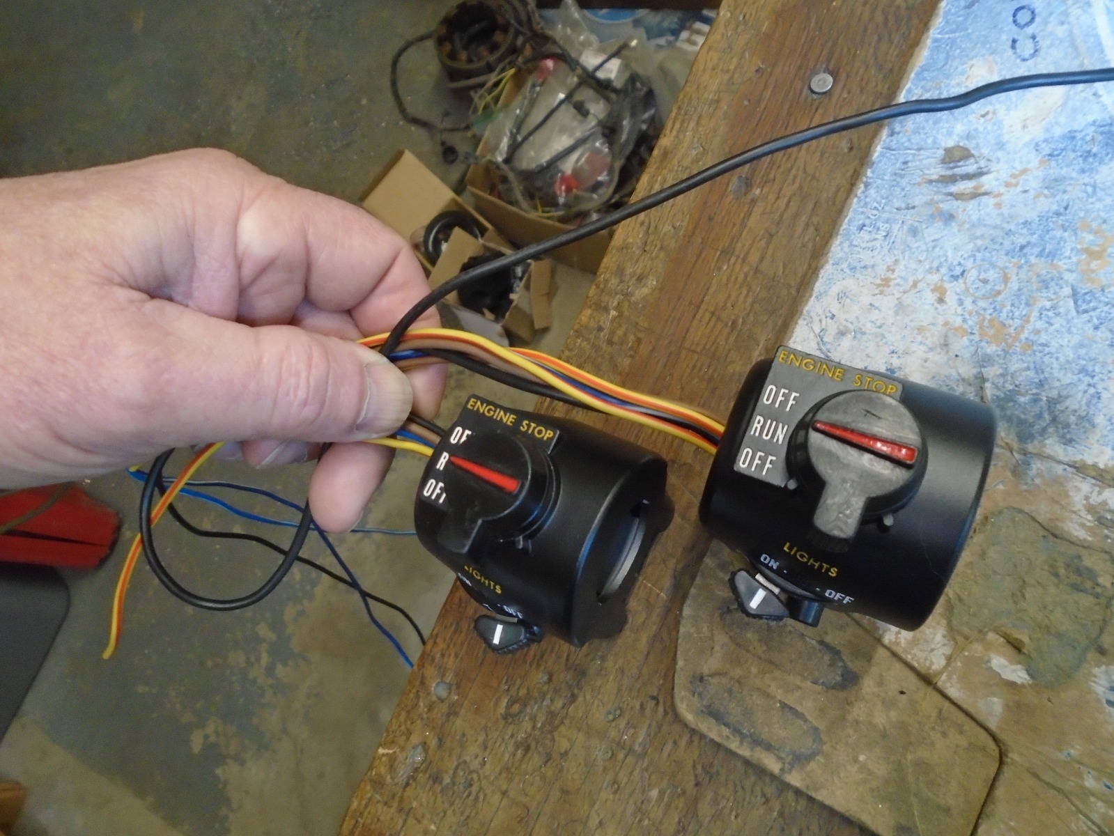

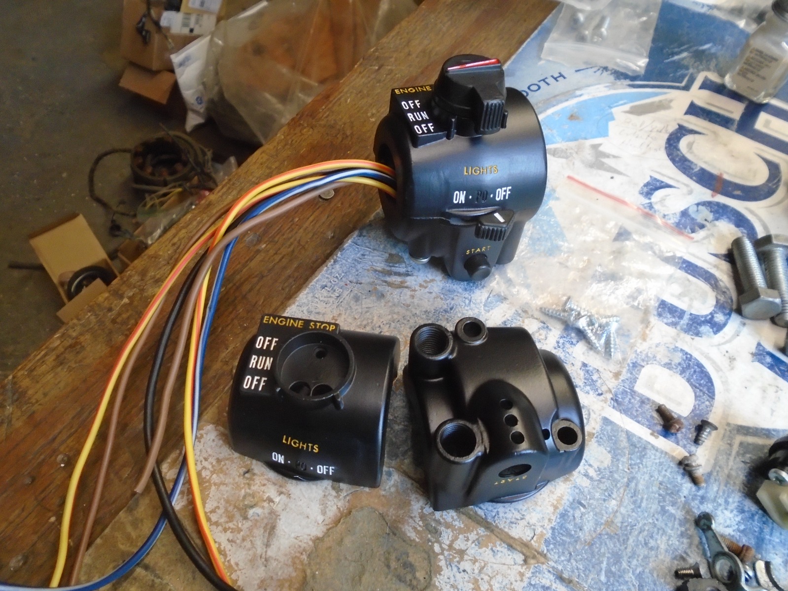

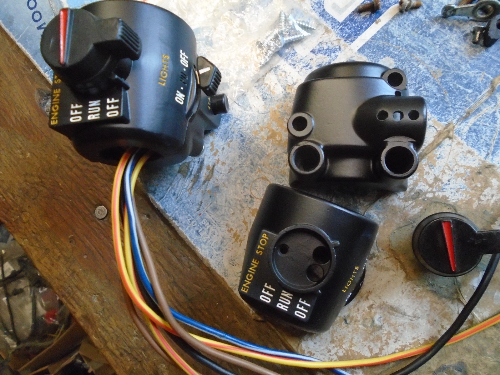

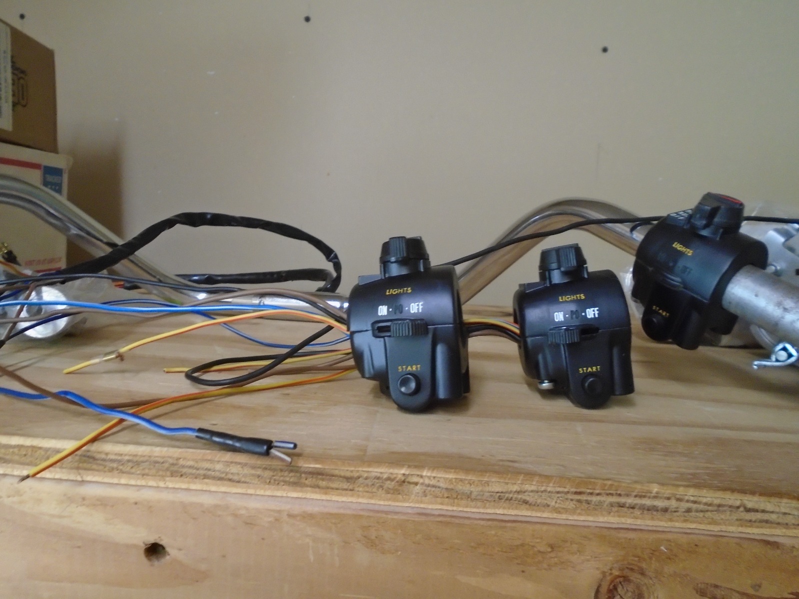

Some stuff Rich. Have been fussing with/gathering the best bits, and drinking beer the whole time, gotta be proud of me. Some persons hide it, i revel in it, ha. Some relevant crap that will be applied. Note the Biggest issue with the On/Off/On switch is the "ramp" of lower housing. It gets decayed by the singular ball bearing making its way up/down but often rusted. This just saws-away at the 3 detents. The ones i'm including are fine as rain. Also building You a wiring harness with proper exposed colors for assembly. And never said i was super fancy. Testors enamel red is a balls-on color replacement for the "arrow" of engine switch, just have to know a little goes a long way. Won't be long now...

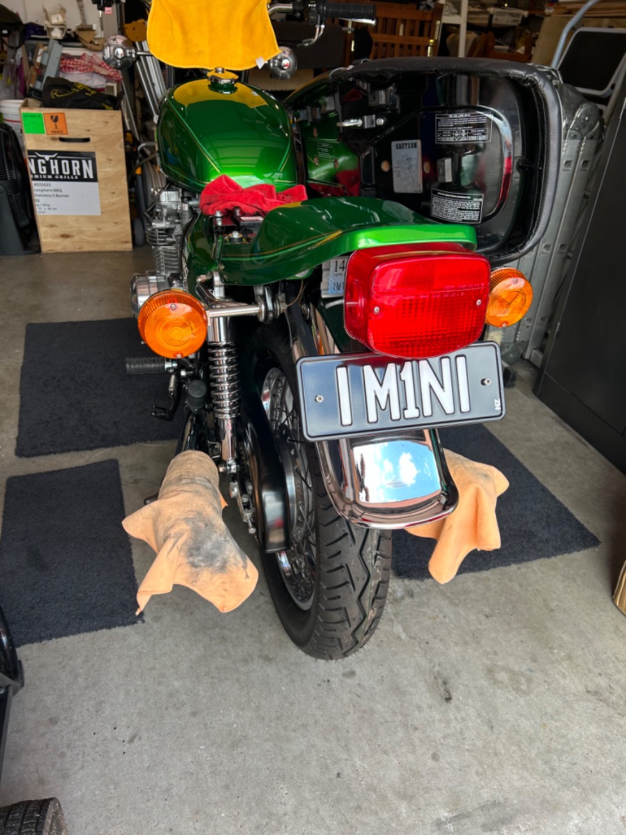

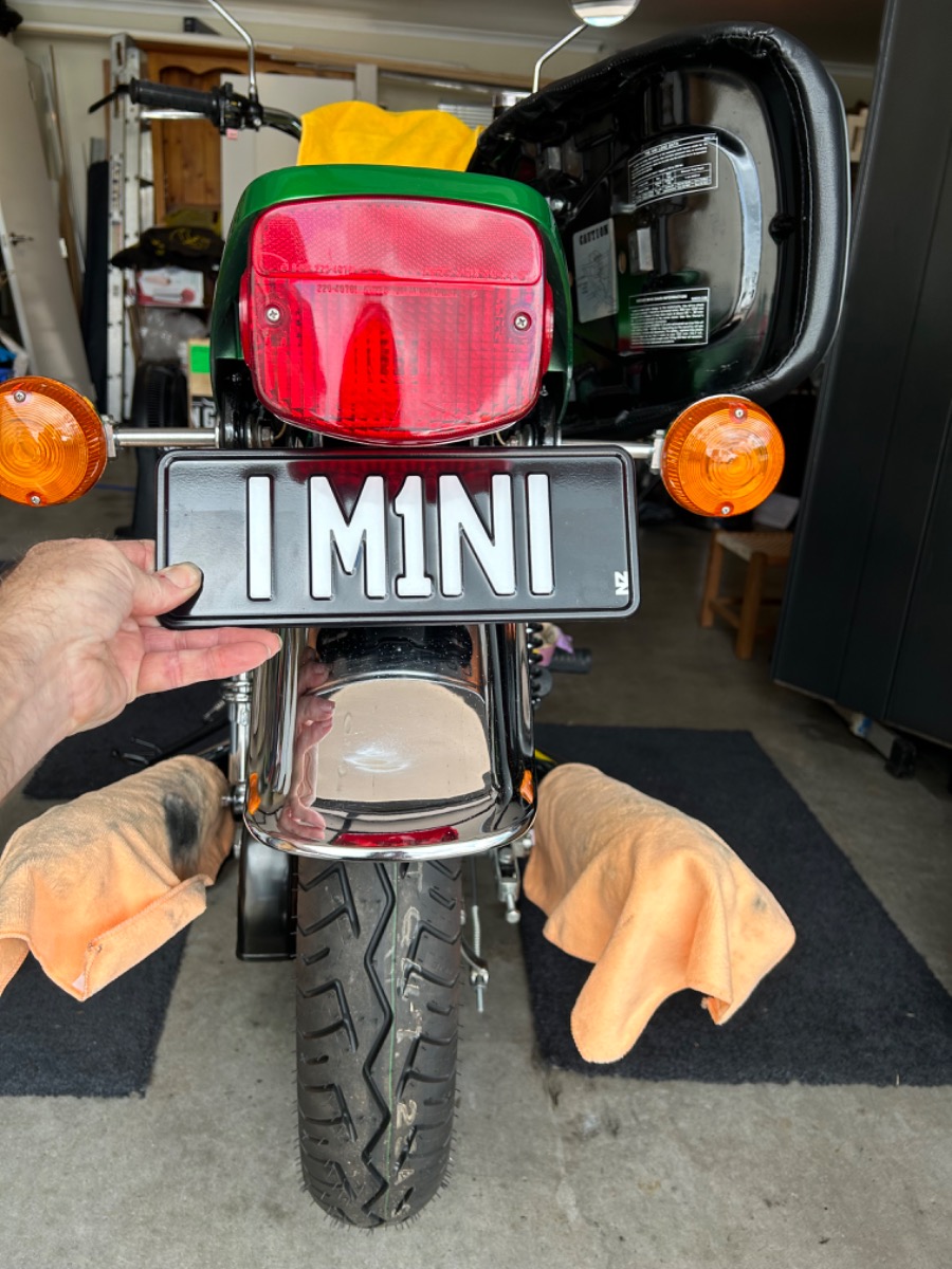

Awesome work 😁 the beers obviously help creativity, I had better grab one as I am in the process of mounting my number plate, so need inspiration to make it sit better 😂 OCD definitely setting in. Now making a bracket to go over the original mount so the new plate hangs nicely below the light 🤪

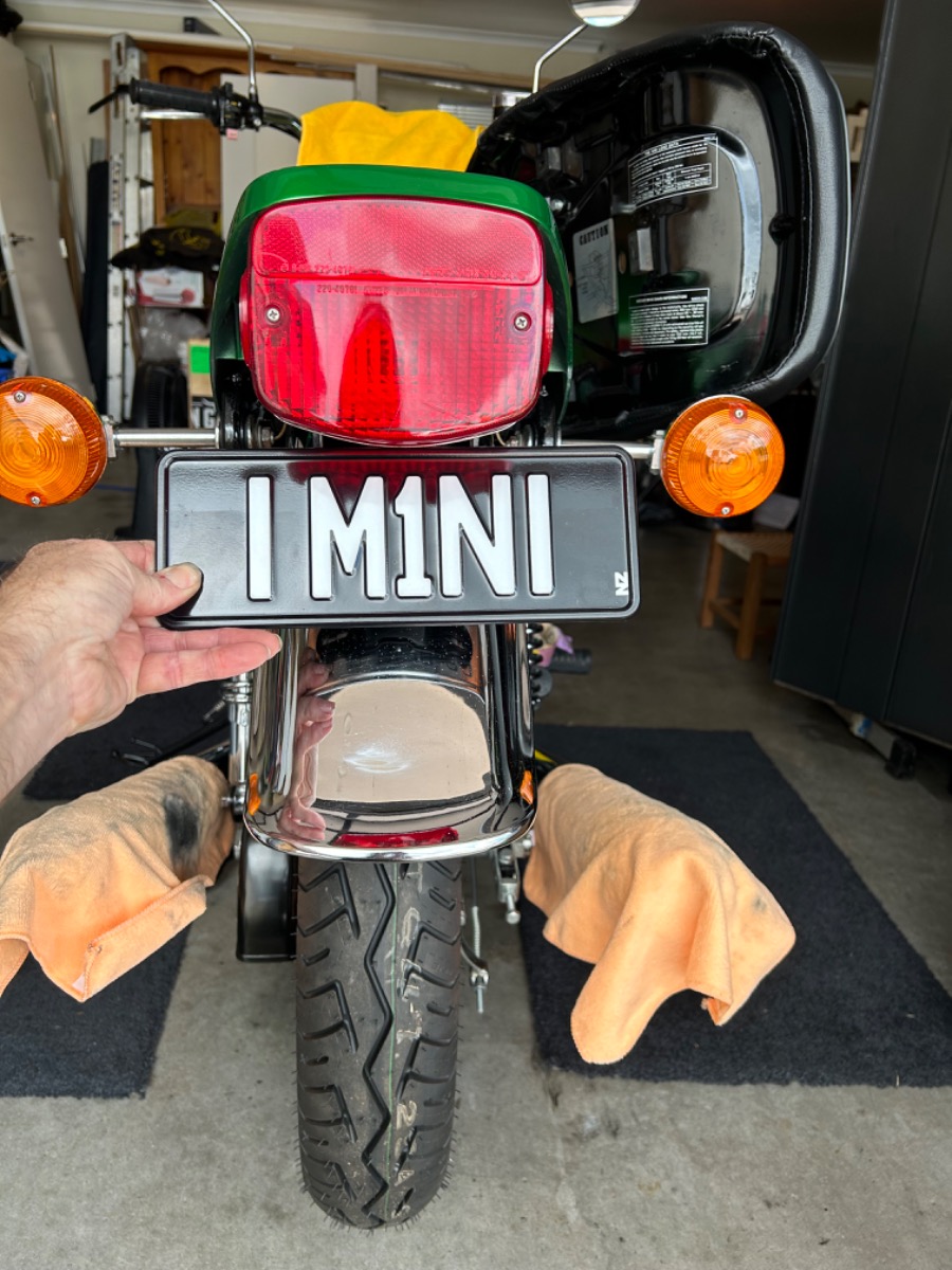

Plate now mounted, just got to get some better black stainless mushroom security screws , but nice and stable 😁
I now have a mini Z1 😂

Clay, they are looking fantastic 😁
Yes, the tag is a legit plate, I bought it a couple of years ago and registered it for the bike. I also have Fixx1t on my work van 😁

Very interesting registration plate, probably some built-in thingy that a sweep cop camera can capture? Tech is good but too much is infringement. Are You sure YOU need two completed sets of the Right hand side? I can but seems You already have one functional, so maybe just needing the bits without a completed harness?

They are looking fab, yes agree, 1 complete r/h and one bits will be perfect please , and the left hand 2 sets will be awesome , as the one on the bike is wrong and for a later year.
