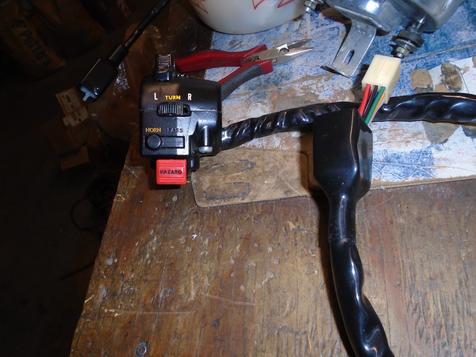

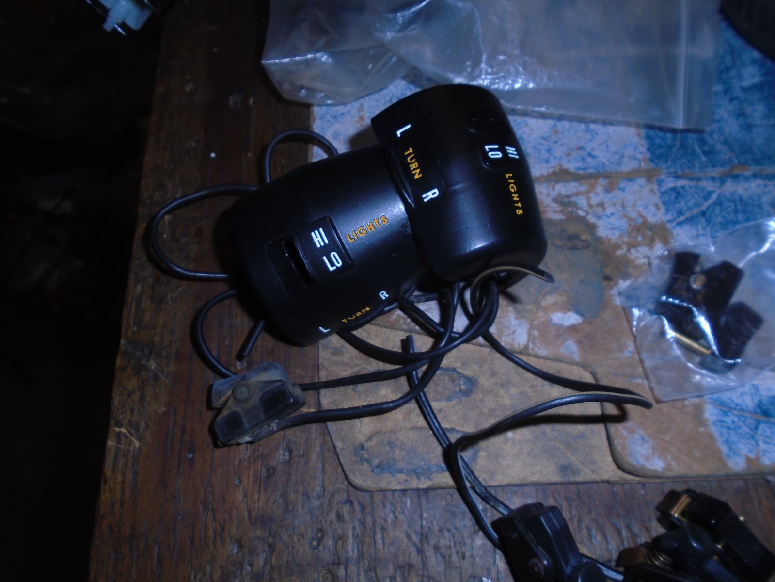

Hey Kim! Not anything "exclusively" 1977 B1 650 but that doesn't really matter, latching shell halves are basically the same during this era. The difference lies within the wiring and wiring overall length. Do You already have an original set but just fugly? Most times persons just send me their originals and i redo them. I like to keep the original date codes, even though you don't see them or takes effort to. Send me a couple photos of Your's Please! Picture shown is what i believe your LH switchblock will resemble. The one with the almost always dreaded discolored "Hazard" push/pull button. This one is NOS but has wiring for external routing

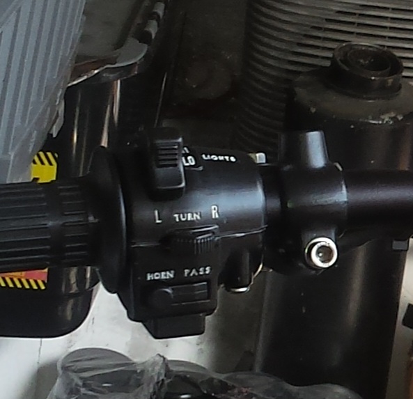

I don't think any region b1 had hazards. Hazards wasn't added until the C1
My US B1
My UK B1

I don't doubt it Warren! I don't work on a lot of the mid-sized KZ's, that's why it's always preferred if persons send me their originals. I do see yours has the lower casting boss that would be later used/cut-out for the "Hazard" red knob though. Also yours has all the recessed features painted in white. This was indicative of a Kawasaki "replacement", they did away the yellow paint in any sector.

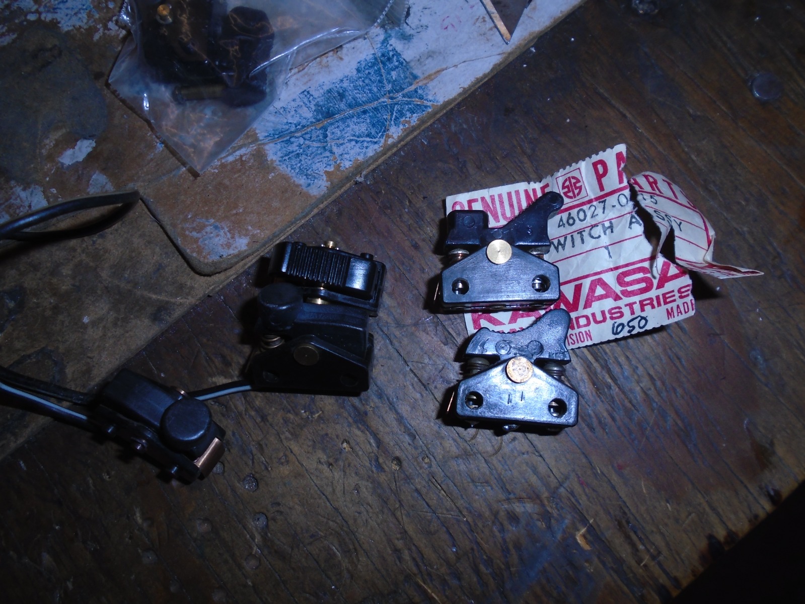

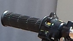

Cool story about Your original Z650 Warren!! Your pic of the switch is a tiny thumb and i can't make it any bigger but i can note the existence of a hump on the "Horn-(Pass)" toggle bar. Your Euro version had a SPDT switch and while part number didn't change the plastic toggle bar did, more pronounced "hook" for pass in superseded bar 46027-015. This resulted in an extra wire within the wiring harness for city light. US models used a simple SPST and came in two versions. Photo of the 4 different style switches used from 1976 to 1980. And a couple finished tops. Kim.. i have a couple boxes of these assorted switches, let me check before you buy one! Now that Warren sorted me out, Thank-You Warren!! I know what to look for now.
The following user(s) said Thank You: Warren3200gt, kimchella

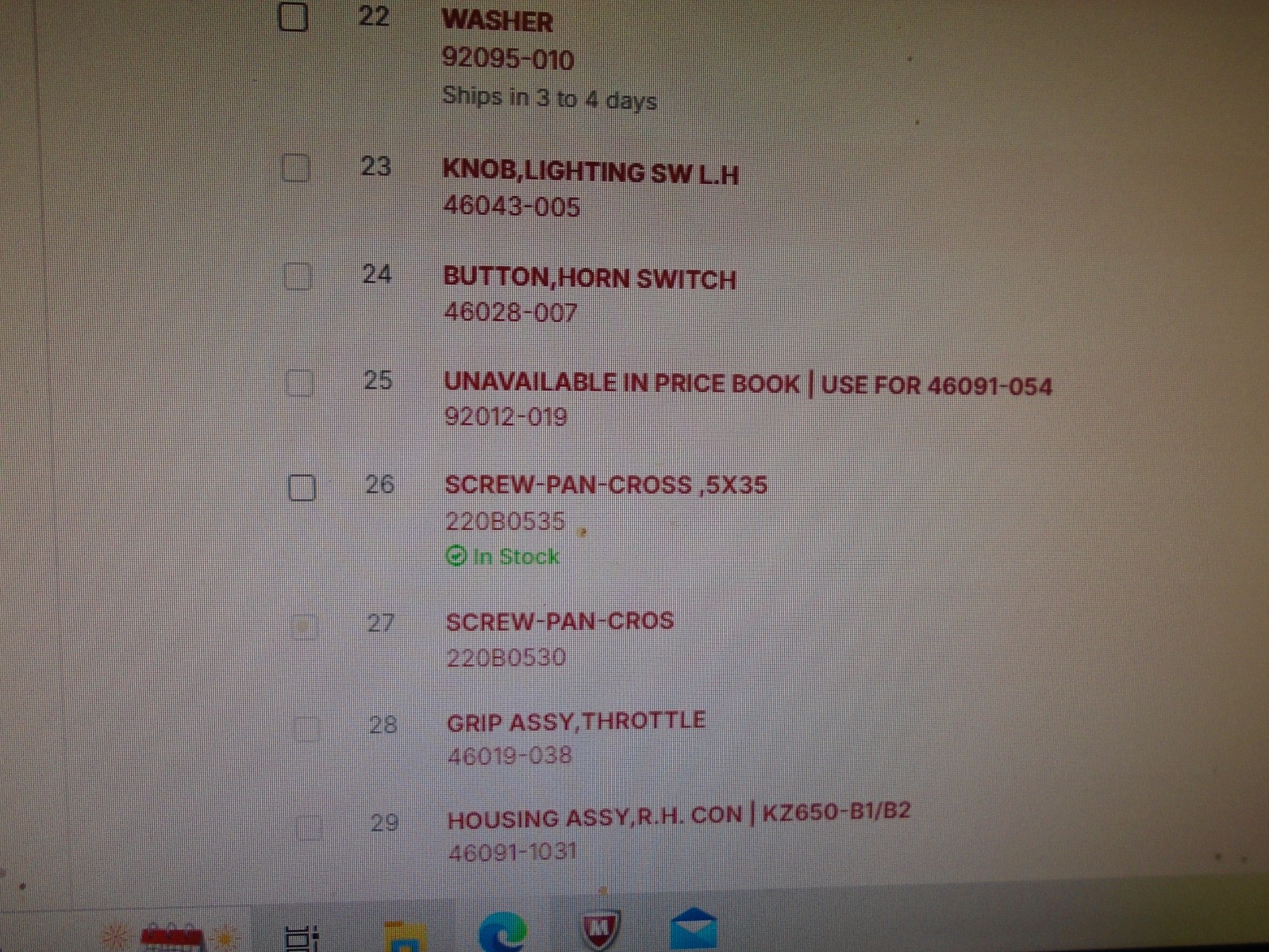

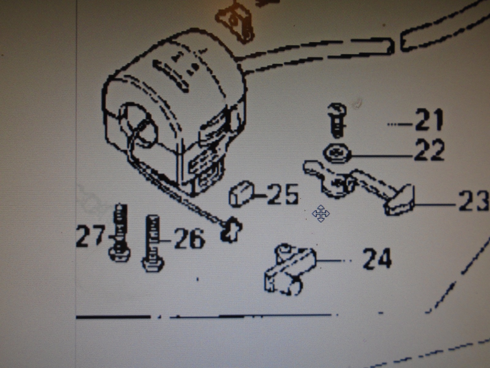

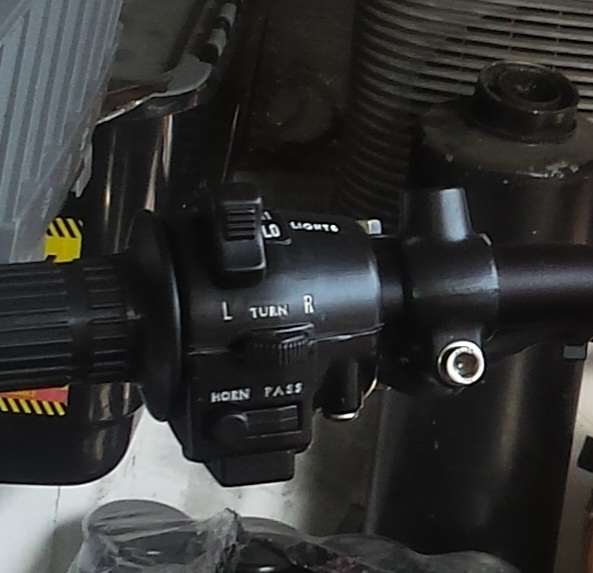

Did a little research for you Kim. Just wasn't that familiar with the 650. Appears the 1977 was a unique bird like warren mentioned. What i thought was a different lower LH half i "believe" is the same..except they used a rectangular plastic plug, number 25, to cover the hole. Part # 92012-019 but seems elusive to find but would be easy to make if You're crafty. Seems the B1 didn't have the Hazard feature, that started in B2 model. Noted the wiring harness is different and absent the relay needed for the Hazard. So..what you have is fine, just remove the red button. And you can lessen the amount of wires going thru the bars. The wiring is easy.
The following user(s) said Thank You: kimchella

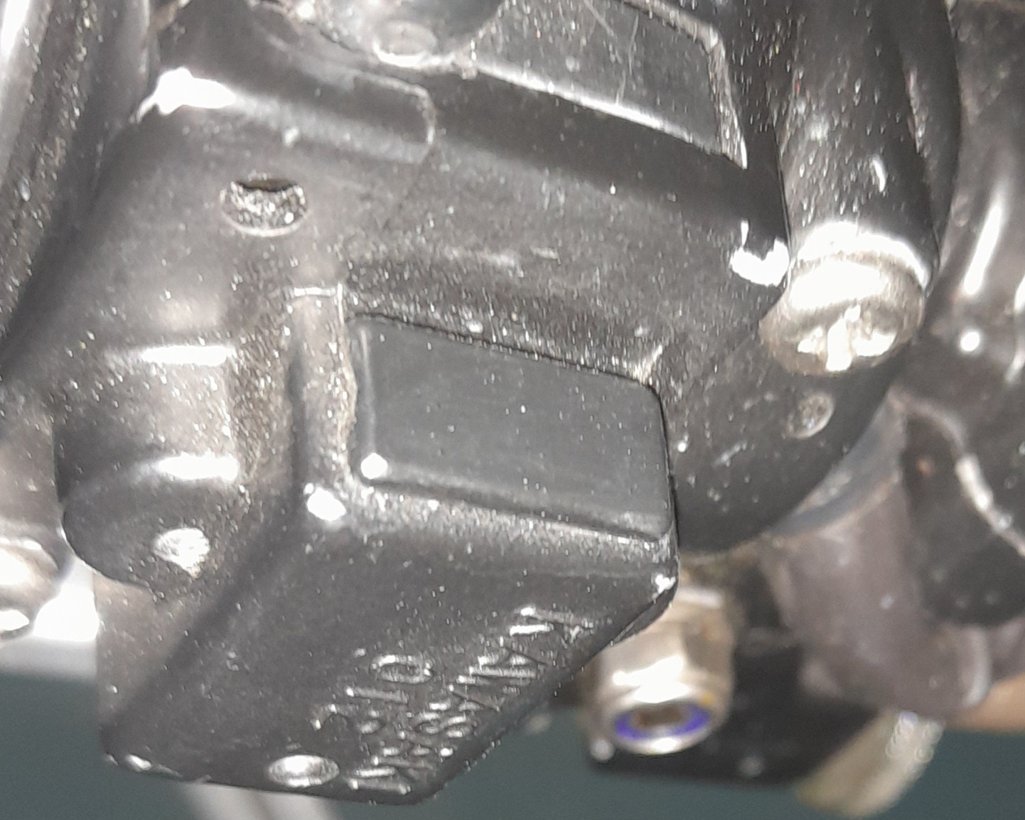

Just checked both my bikes and they both have a plastic cover 👍
This is my US bike but the UK bike is the same.
Last edit: 11 Feb 2025 05:04 by Warren3200gt.
