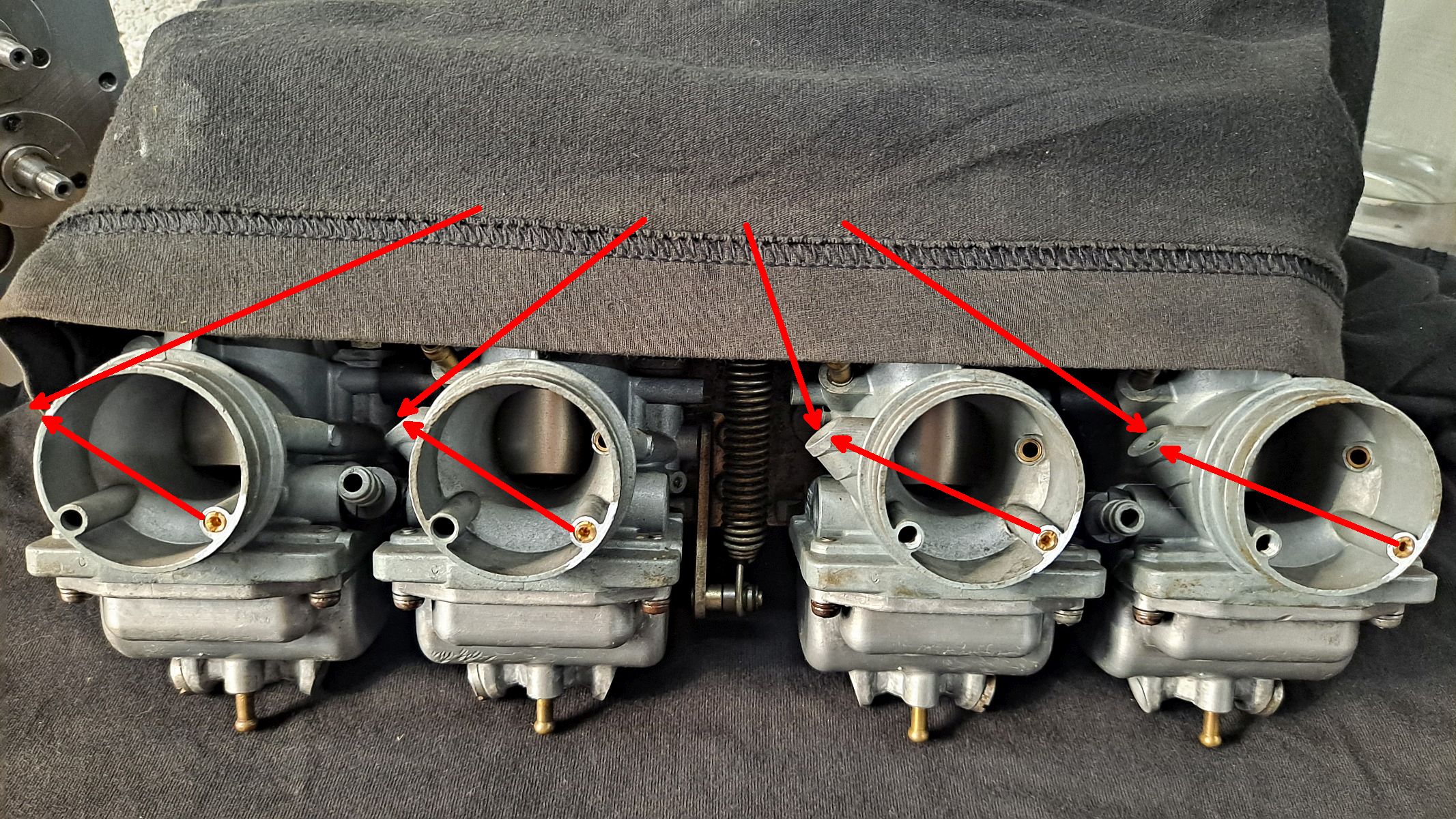

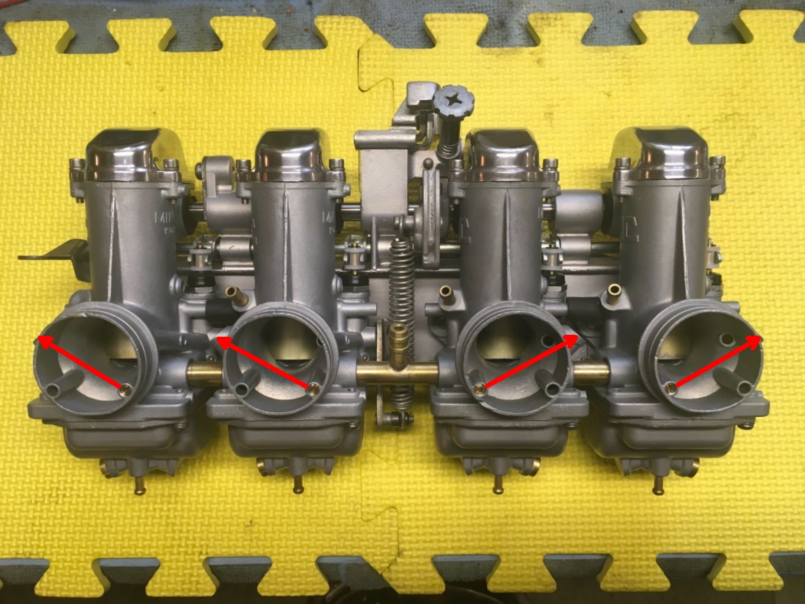

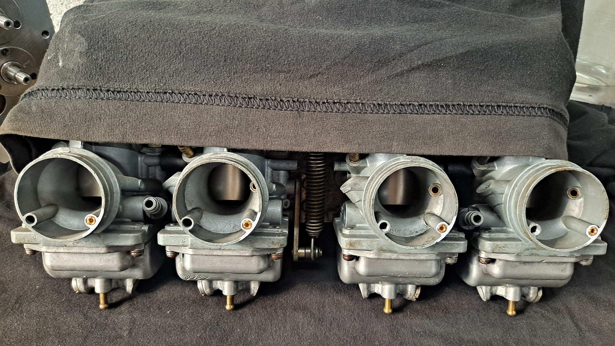

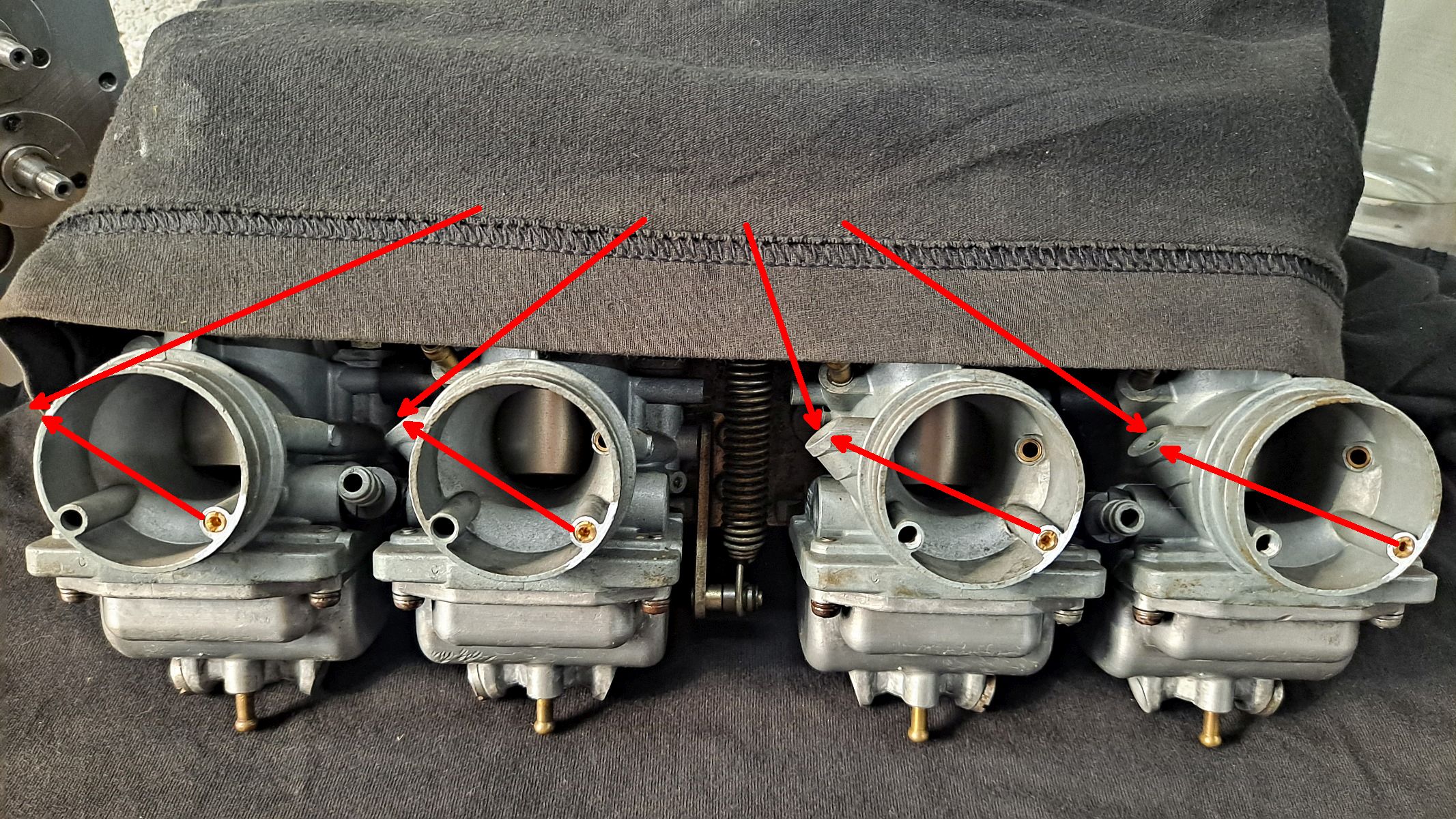

Thank you for the update. I’m concerned now. I just installed your corrector jets into a Suzuki set with both air and fuel pilots screws. Please look at included photo. Hopefully I got the right. Thank you.
Yes! They are correct.
It's only some sets of KAWASAKI VM26 with a singular fuel screw that are not handed.
It does not occur on any of the Suzuki carbs or Kawasaki VM28's.
