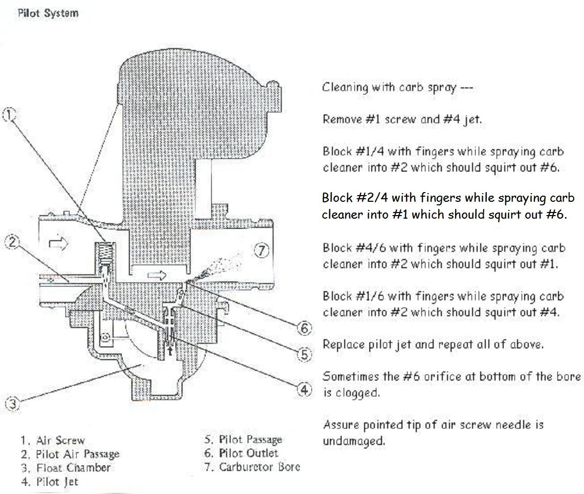

Not sure if this is what you are seeking but here are 2 pics for showing differences between air screw and pilot screw within the pilot circuit. The first pic is of an air screw, note its path. An air screw allows for more or less air to premix with the fuel pulled up via the pilot jet. Turn it in to lessen air and turn it out to increase air. This exits into the carb throat below the throttle slide.

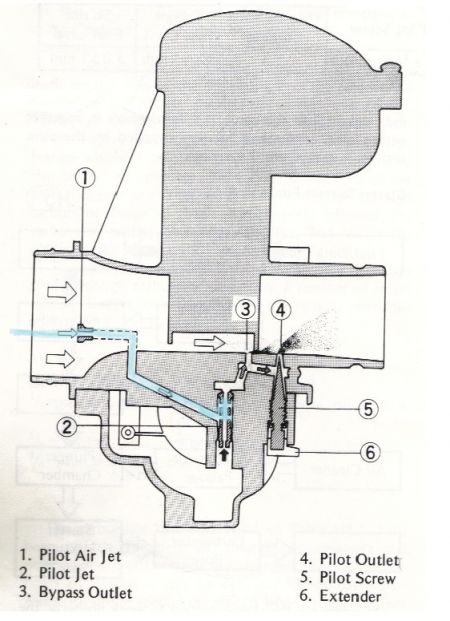

The second pic shows an pilot screw, sometimes called a fuel screw. Note its path and the differences between it and the air screw pic. The pilot screw does not have anyway to control the amount of air allowed to premix with fuel pulled up the pilot jet. Rather what ever the mix is (due to pilot jet size and pilot air jet size) to enter the carb throat on the engine side of the slide. It also has what is called a bypass located below the slide.

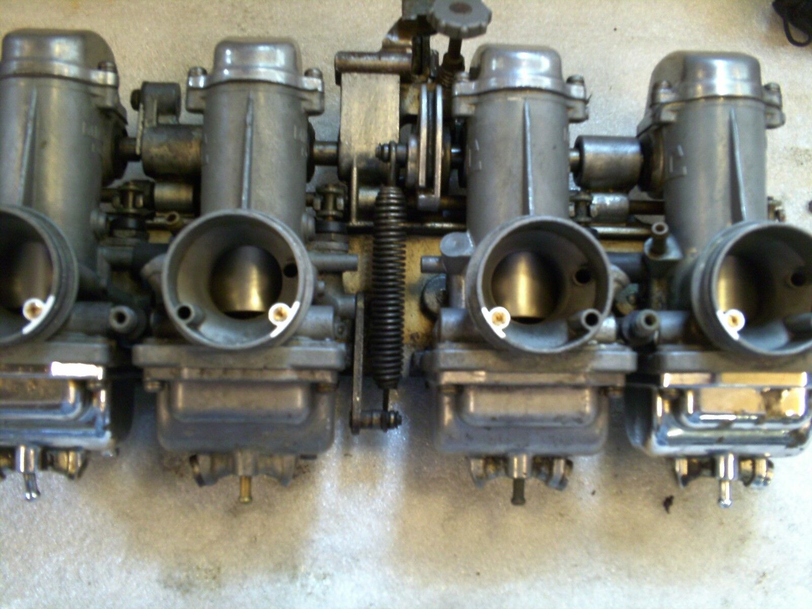

28 Jul 2023 14:00 - 28 Jul 2023 14:02It is only some VM26's with the fuel screws underneath that are made up of left hand bodies.Awesome, thank you. Just wanted to make sure I was drilling in the correct holes.
If yours have the AIR screw on the side then just fit them as highlighted in white in the pic.
It is always the air passage diagonally opposite the air screw.
