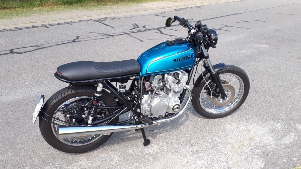

Is it possible to use these Air Corrector Jets on VM22 carbs (Suzuki GS550)?

16 Jun 2020 06:31 - 16 Jun 2020 06:47Hi, Scirocco.Scirocco wrote: Is it possible to use these Air Corrector Jets on VM22 carbs (Suzuki GS550)?
I don't know if this is a coincidence but I have just been asked this by another member from Germany and while the advertised jets are only for VM24 to VM28 I have agreed to make a special set for his GS550's VM22's .
The reason for only covering 24 to 28 is just because the jets I make for the Z1 Owners Club GB happen to be correct to cover VM24,26 and 28 applications for Z650,Z1,Z1000 and Suzuki GS750 to 1000 so I advertise them as such to serve a wider audience.
The jets for the VM22 are smaller and while I have no intention of going beyond a club hobby service to cover bikes outside my interest I have agreed to help the member as this smaller size will also suit the VM22SS as fitted to some US Z650's.( we only got VM24's on UK bikes).
If anyone needs jets for the VM22SS they should clearly state this as I will only make them individually to order .

No coincidence but he, (Maver), ask me about to use these Air Corrector Jets on VM22 carbs is possible.
Pot filters are very popular on those cafe racer bikes here in Germany.
