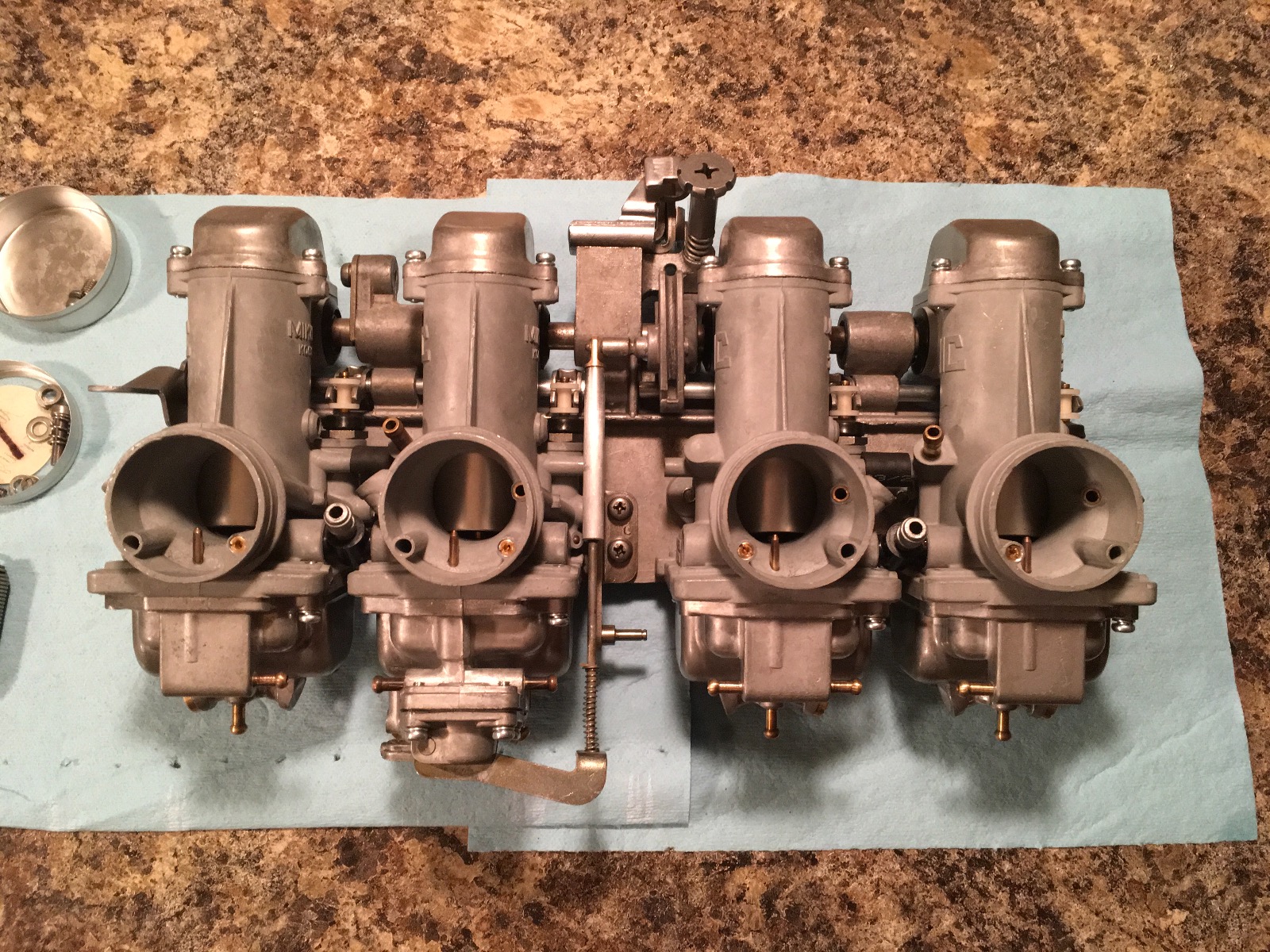

I just rebuilt a set of 28MM with the accelerator pump. I installed the air correctors. Not sure if your ‘78 Z1R has the pumpers or not? I have to say in the few short rides weather has permitted sense Install I can say they really help low end acceleration and the power is much more linear. And as mentioned before hats off the Zed1015 for his help and his willingness to share his expertise. Thanks Zed!!!
