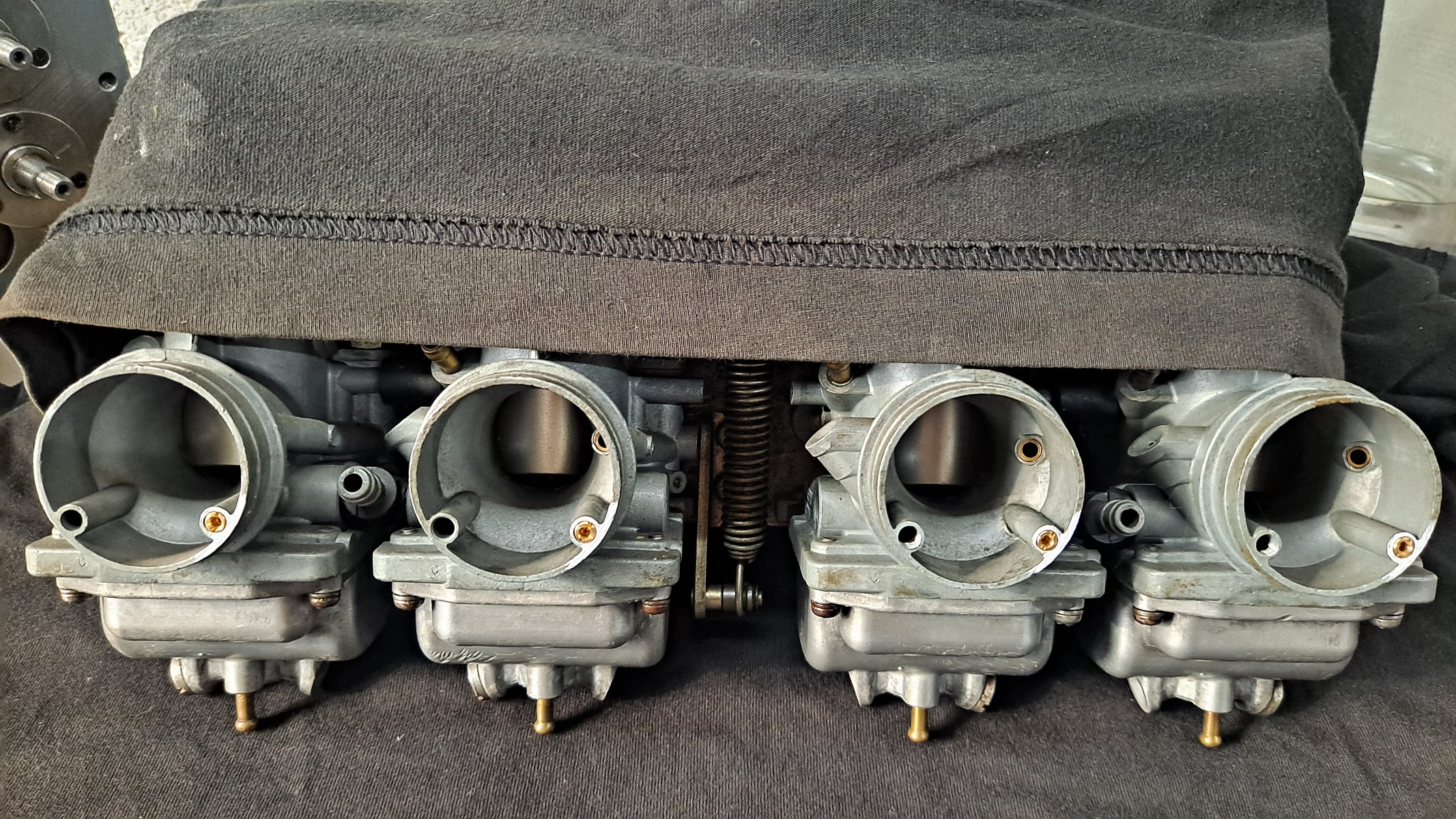

A little update to this thread because i'm unable to edit and add a pic to the first post..
A reminder to be aware that some VM26SS carb sets that are equipped with the FUEL mixture screws underneath are made up of all left or right handed carb bodies..
In this instance the jets must be installed in the air passage furthest away from the unmachined air screw boss.
In the case of left hand bodies ALL the jets should be fitted at the 4 o'clock position and on right handed bodies all at 8 o'clock..
See attached pic for example of a left hand body set with the jets installed in the 4 o'clock position..
Thanks.
Thanks.

Re: Air corrector jets for Mikuni VM 24, 26 and 28mm round slide Mikunis.
01 Jun 2022 15:05
Thank you for the update. I’m concerned now. I just installed your corrector jets into a Suzuki set with both air and fuel pilots screws. Please look at included photo. Hopefully I got the right. Thank you.
