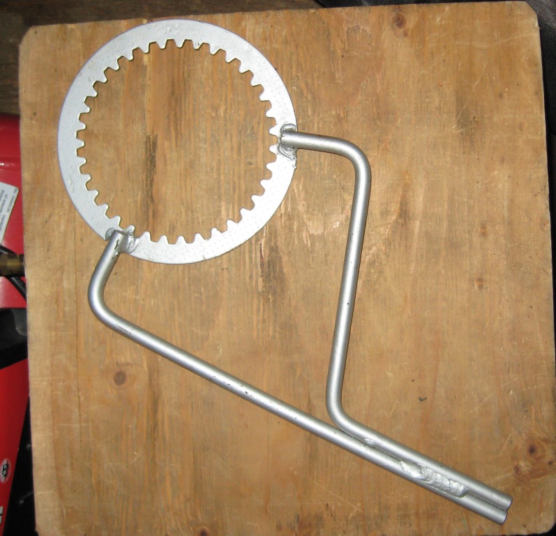

Just an update: I've been hesitating moving forward with fixing the engine since I dont have a title but I've got that mostly figured out now so I'm ready to move forward with the build! I think step 1 will be getting that piston kit from cruzin image. I also want to split the case to take a look at the bearings and general condition but I cant take that clutch hub nut off. It's a real bugger. Does anyone know how?

02 Feb 2026 08:03Clutch basket holding tool and electric impact gun.I also want to split the case to take a look at the bearings and general condition but I cant take that clutch hub nut off. It's a real bugger. Does anyone know how?

Do you know of any specific tools that have worked for others?

04 Feb 2026 17:02All the KZ/GPZ four cylinder bikes use the same clutch plates so any clutch hub tool for those will fit that basket (650/750/900/1000/1100)Do you know of any specific tools that have worked for others?
I made my own tool out of a steel clutch plate in 1985 before they were commonly available.
