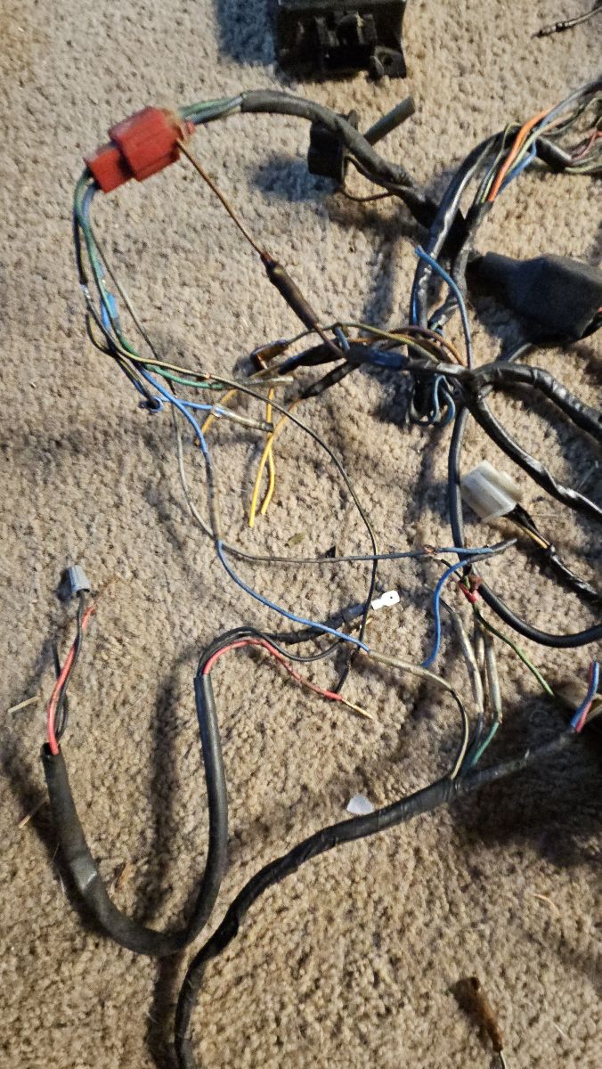

That's probably a good observation. I mean just look at the wiring harness
That's just some of it so you can imagine what the rest is like ... I don't know what the loose wires are even for. Whoever took this bike apart must have been really sick of it. There's more to come...

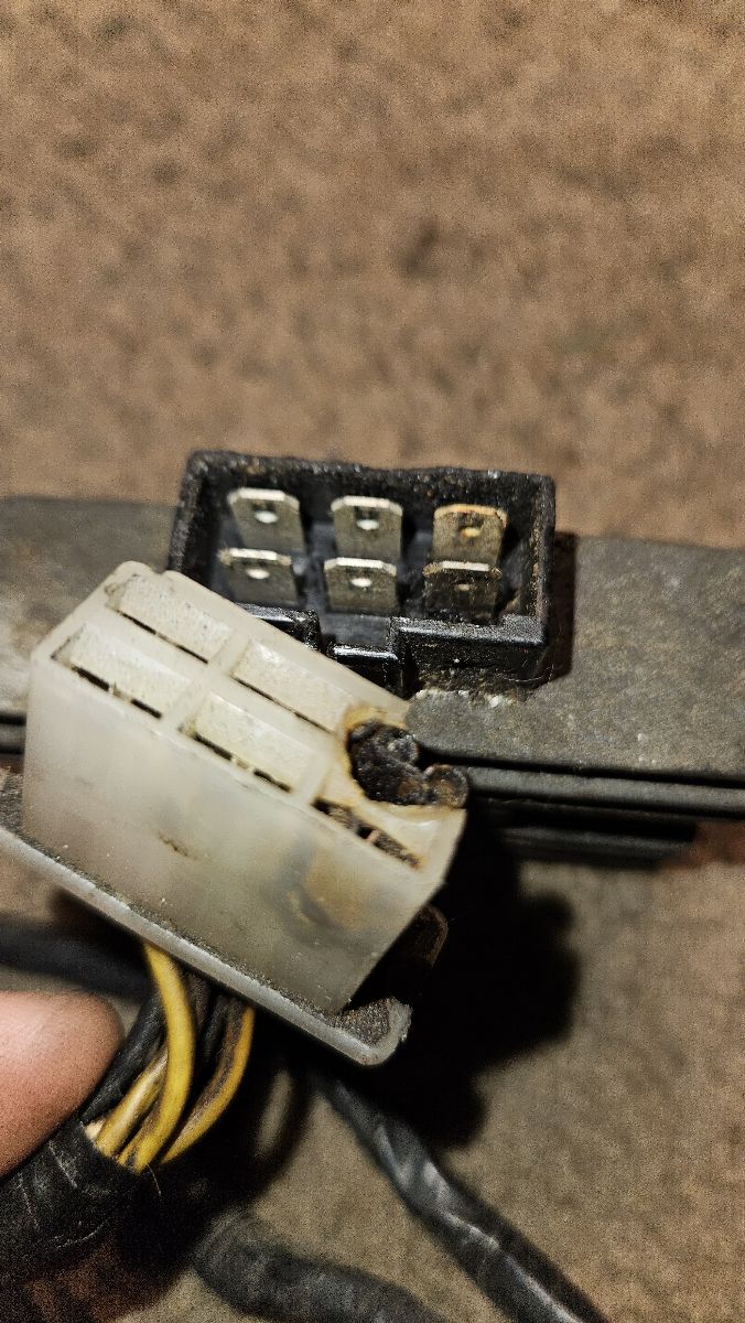

That’s not uncommon, the terminals corrode over time and lose tension then start arcing With the wiring it is common for people who don’t know what they are doing to just pile into a loom looking for a magic answer to their problems

I didn't know that it was common for the regulator to heat up like that, I guess I'll be cleaning the terminals for my other bikes then... I'll get this wiring mess all sorted through once I can get a good look at the wiring diagram.

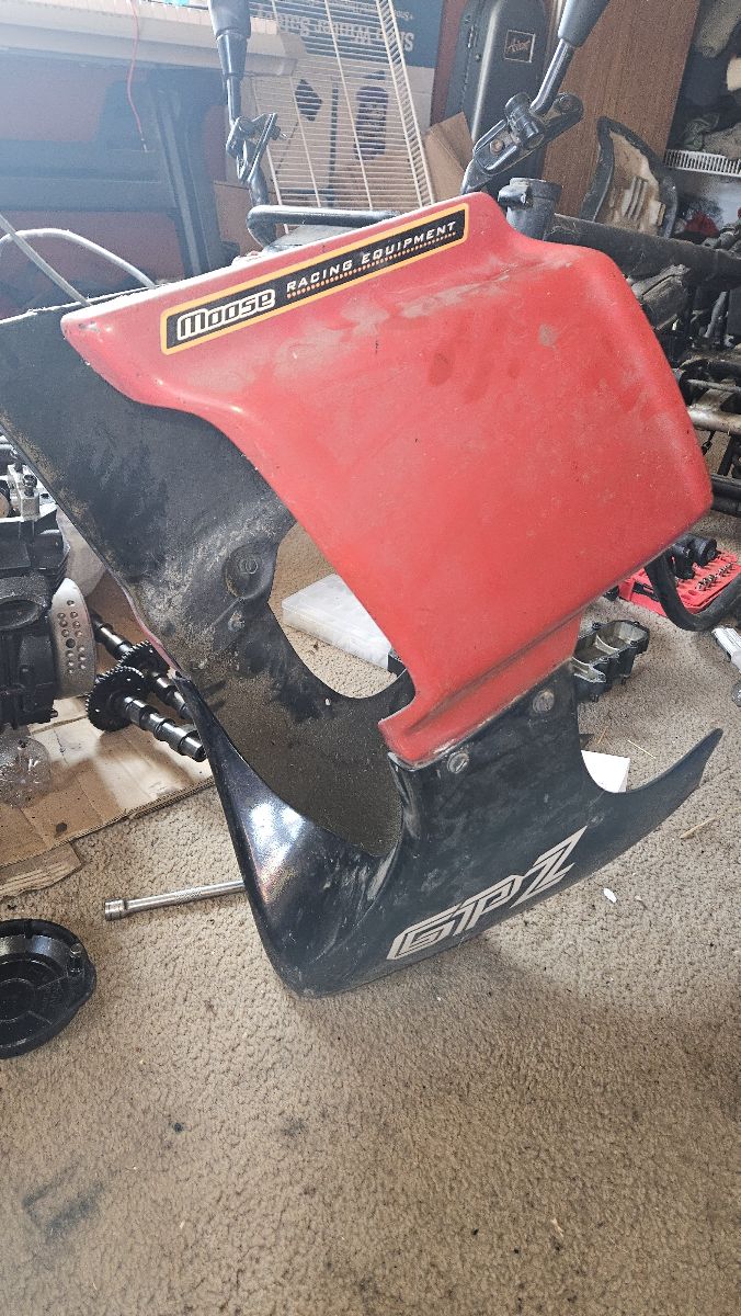

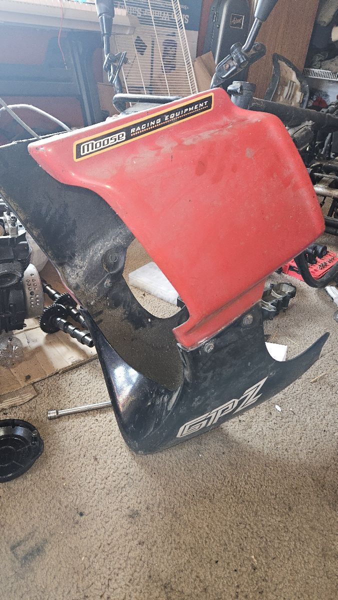

Could someone help me ID this fairing?
1984-1986 gpz550 did not come with this fairing. I was wondering if someone fitted a gpz750 or gpz600 fairing of the sorts onto this... i dont know what the moose racing equipment sticker is but I looked it up and nothing popped up.

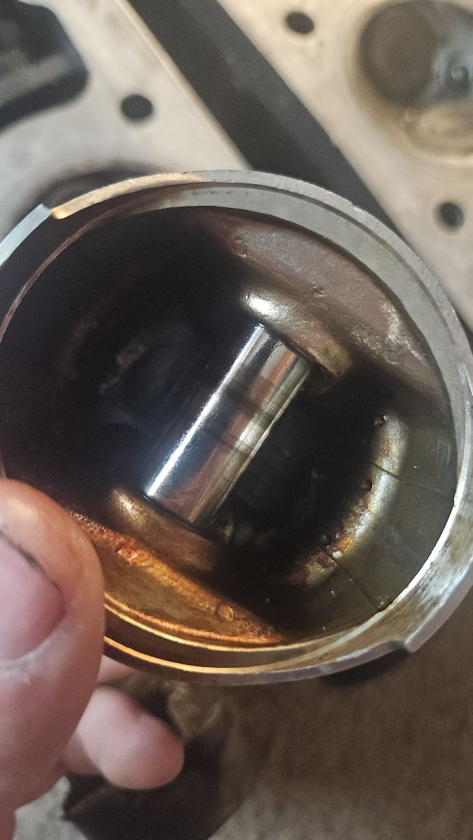

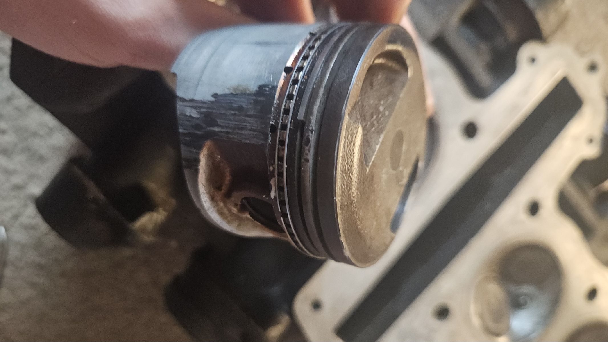

I followed nessisms advice and removed cylinders and pistons and well, I think the pistons are junk... I'll need your opinions on that though. To give you guys reason why I think that, I went to take pistons off and the wrist pins were STUCK. I had to hammer them out with a socket and ratchet gently to get them to budge. The manual said they should pull out freely.
there is also scoring on the pistons and cylinder walls that correspond with each other. 3 of the 4 pistons have that scoring.
Finally the oil rings are completely stuck and can't remove them. I ended up breaking a couple and the ones that I couldn't get out are pressed in completely. Im not experienced with engines though so I'm asking for what you guys think. I'm thinking new pistons.

When the skirts "pick up" like that it's normally down to overheating or a lack of oil (possibly both) I guess you would be looking at a rebore and new pistons. Tight wrist pins isn't that unusual, warming the pistons with a hairdryer can help and then carefully polishing the pins with 1500 grit wet and dry with WD40 should resolve (however not really relevant in this case with the scoring)

16 Jan 2026 13:18 - 16 Jan 2026 13:20The KZ/GPZ550's/750's/KZ650's and ZX600's all used the same oil pump up till 1994. There is a known hot low oil pressure issue with those bikes when the oil pump gets worn. The only other way you would have low oil pressure is if the crank bearings are worn.When the skirts "pick up" like that it's normally down to overheating or a lack of oil (possibly both)
There is a procedure in all FSM's that cover a test to check for this.
