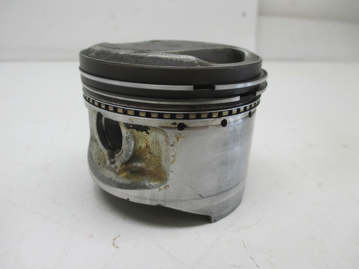

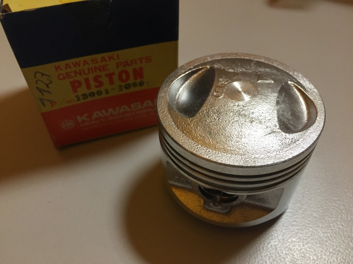

Maybe these pictures will help show a difference: 13001-1166
13001-1127
Clear difference in dome shape. Does anyone see any other differences?

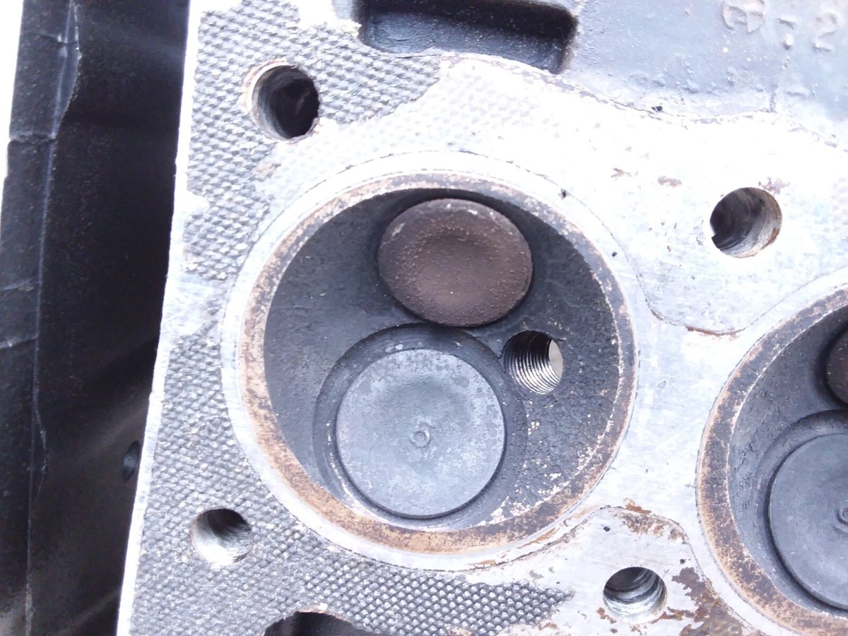

If one year has a classic dome and the other year a "shoulder" you need to take a look at the two years combustion chamber design on the heads, one might make accommodations for the piston with the shoulder (squish)
The one with the shoulder does not have any flat land at the edge, and that may cause collision in the "wrong" head.

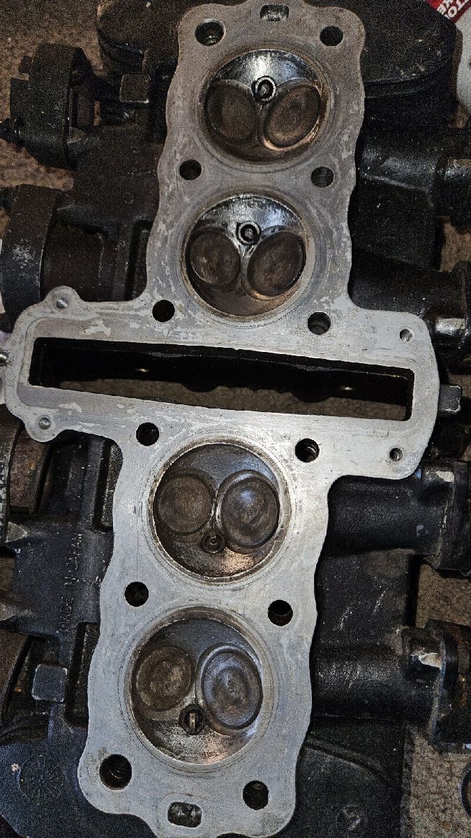

It might be an optical illusion in the pics but the valves look bigger in the later head ? what is the point of this comparison ? do cruzin image not list pistons for you model year ?

The valves are the same size, I'm just worried about the dome shape as Injected pointed out. No, cruzin images only shows pistons available for the 1981-1983 gpz550 so I'm trying to figure out if those pistons for the earlier gpz550s will work with my head.

18 Jan 2026 10:29You could always make a clay mold and make sure you have at least 1mm between head and piston at TDC.The valves are the same size, I'm just worried about the dome shape as Injected pointed out. No, cruzin images only shows pistons available for the 1981-1983 gpz550 so I'm trying to figure out if those pistons for the earlier gpz550s will work with my head.

I suspect even if it clears mechanically the compression will likely be too high - these aren't performance pistons you are looking at so dialling up the pressure on them may not end well ??
