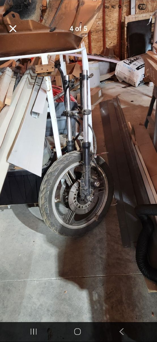

All of this. The forks on the 440 are 33mm and the forks on same year of 550 are 35mm, which should tell the OP something.

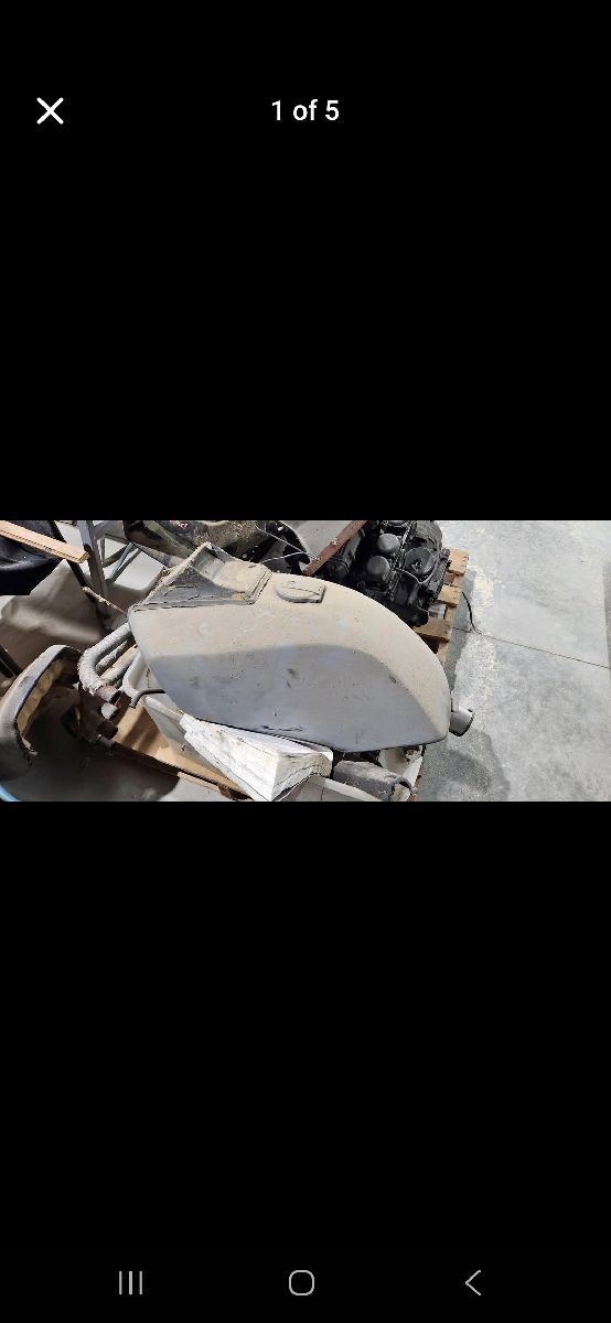

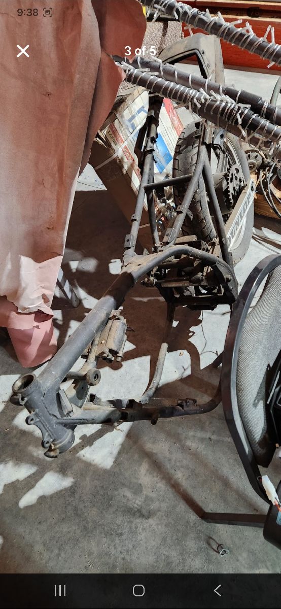

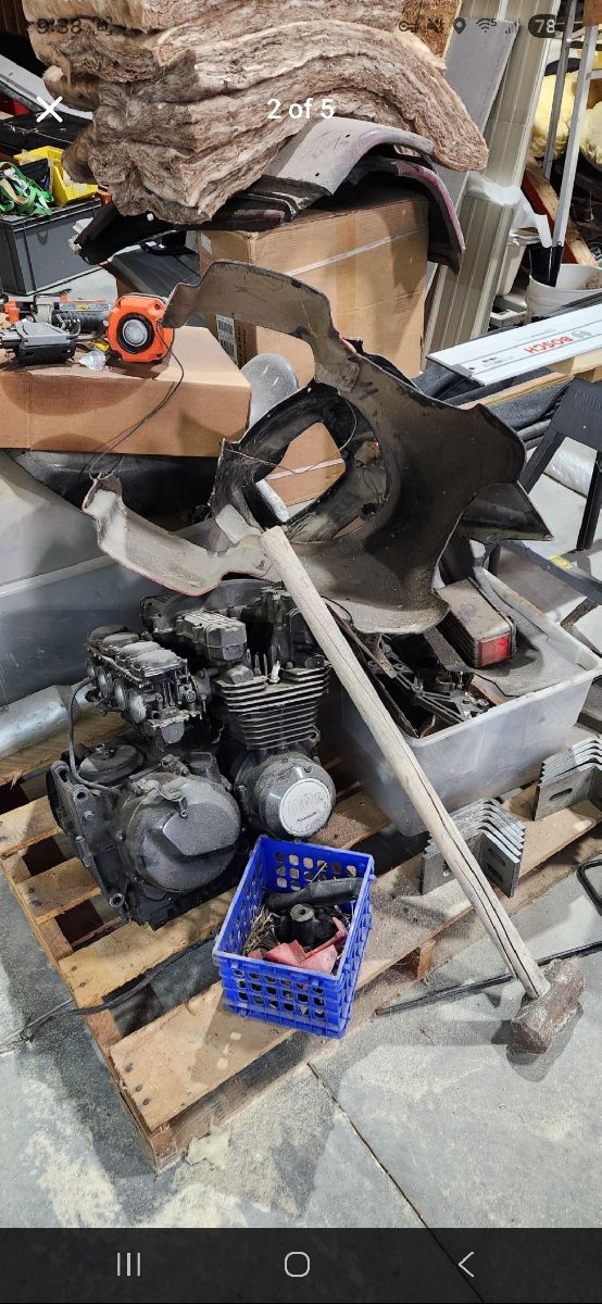

Thanks for all the considerations everyone. At this point I'm just trying to justify the purchase. Is everything in the photos worth the $100 (that may be subjective) and is it possible to "get my money back" by reselling the parts listed in the pictures? Just a lot of thinking to be done considering the alternate routes. The main thing right now is I'm not sure if my parents would be supportive of this decision since I already have two bikes in their garage

22 Dec 2025 15:34 - 22 Dec 2025 15:34I would say yes. The cams alone are worth that, depending on which performance grind they are (I’ve been looking for some myself, still waiting to hear back from another forum member who might have some). Parting out bikes and selling them on eBay seems like a lot of work, but I know several people that do it and they seem to turn a profit.Is everything in the photos worth the $100 (that may be subjective) and is it possible to "get my money back" by reselling the parts listed in the pictures?
