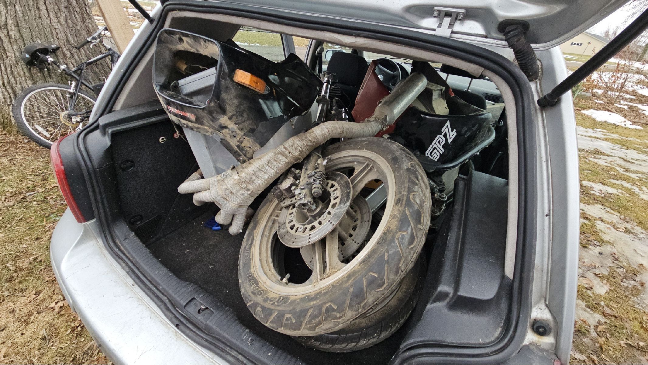

Update: I got the bike! It's not in the best condition but the price reflects that. Im not sure what I'm going to do with it yet but its pretty cool. It turns out it is a 1985 gpz550. Fitting it all in my little vw golf proved difficult

Ooh - a puzzle! Looks like it's probably all there.
Now for the fun part
Plenty of help here on KZR, just ask.

Yeah most of it is there just missing some parts like the instrument cluster, ignition switch, battery tray, airbox, and a bunch of bolts. I think I'm going to follow Wookies advice for now and try to put it back together.

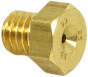

Alright guys I need your help! I can't tell if these jets are different from standard sizes. My main curiosity is to see whether they are jetted for pods since it didn't come with an airbox. Thanks in advance!

The jets should have a number on them, and if they are Keihin carbs, their stylized K. The number tells you what size they are, and you can cross-reference that with the factory service manual (FSM). POD filters will require a size or two up from stock.

I just did some research and these are tk27 carbs and the main jets are supposed to be hexagonal to take out with a wrench
My main problem is I dont know what size these jets are since they dont have numbers...
