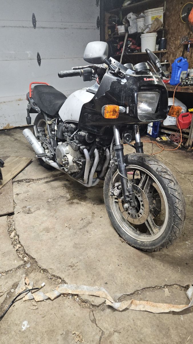

IT RUNS!!! The beast lives once more. She runs about as good as she looks but i still have to put makeup on her
The reason it wouldnt start was because im using the kz550 pickup coils paired with the gpz550 igniter which have different wiring. With a little bit of swapping wires she booted up!
There is a high probability of us replacing the rings and doing a valve job on it in the future but I need to get it running good first. It's very rough at idle but if you are able to get it above idle without killing it, it'll smooth out and rev up nicely. This sounds like the pilot circuit is messed up, right?

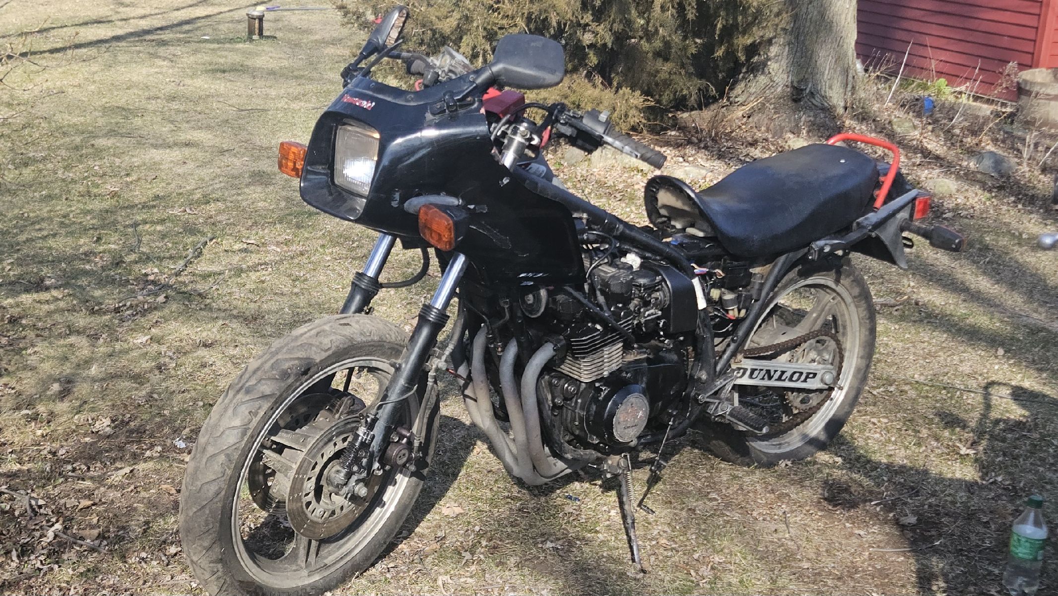

After fixing some odd loose ends I got her running!
a valve clearance check was much needed... no clearance on intake 4 and after putting my smallest shim i had in i got 0.002" clearance. Not enough but is better than 0. Psi on that cylinder went from 90
To 150
. All cylinders now read about 150 psi.
I had a leak at the carb holders and fixed that but it still runs really rough, albeit still better. Opening the enricher circuit makes it rev to the moon but with no choke it'll barely idle and i can hear the primary chain slop around.
If I raise the idle then it sometimes won't move until I blip the throttle but then the revs won't go down and flies to the moon again!!! If I get it idling decently, its at like 600rpm and it'll rev OKAY but will slowly come down. Anything above that, it acts weird. Sounds like a lean condition.
Float bowl level is set with fuel mixture screw 2.5 turns out. I cleaned the carbs twice. I need new bowl gaskets but I dont think that would be a huge issue.
Another thing is there is an audible metallic tick near the middle of the top end on the left side which is why I originally checked valve clearances but it didn't get rid of the tick. I also put new exhaust crush gaskets in and that didn't rid the awful noise.
I only have half the airbox which isnt ideal but I have the side that connects to the carbs so I just put an air filter around the opening but I wouldnt think that would cause such an erratic problem. On my kz1000 I couldn't use the airbox for a bit and just put cloth around the carbs and that was enough to safely drive the bike but this is not.
Aside from that, I had beautiful weather and its almost there! Fuel tank will be all painted soon and on the bike.

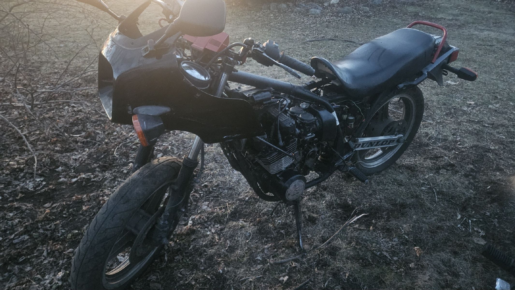

Okay I have an actual issue. The neutral light doesnt work, which would be fine, but i did some testing and pulled the neutral switch, grounded it, and pushed in the button and the neutral light turned on so I know the switch works along with its wiring.
What scares me is that with it screwed in it doesnt work. To me that means I put something together wrong and the button isnt being pushed in when at neutral. However, the bike does go in neutral and 1st gear so whats happening???
Edit: I fixed it. Aparrently I put the thing that screws onto the gear drum in the wrong notch so the switch wasnt making contact with the metal... whoops. You live, you learn.
Im now onto fixing carb issues but I'm glad to say the case swap was a success! Thanks for all the help.
