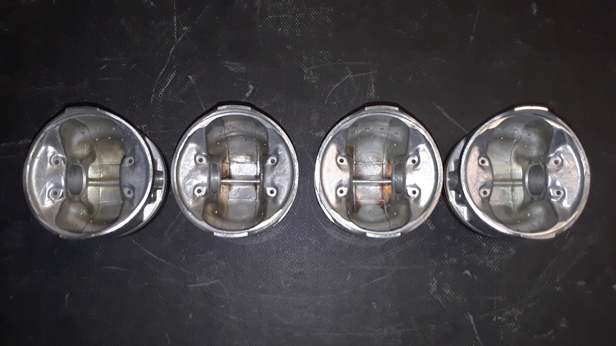

31 Dec 2023 14:21Does the heat damage appear severe enough to adversely affect the piston performance if cleaned up and reused?.

31 Dec 2023 14:24
- Posts: 6878
- Thanks: 4330
Re: Somebody Blew It
31 Dec 2023 14:52Agreed, definitely got real hot on the centre two but there is no obvious signs of damage (crowns look good and all the flashing on the underside haven't burned off and the wrist pins look good) as long as they are still round (within factory tolerance) a good clean should sort them out (if you are replacing the rings a broken piece of the old ring (with the end ground square) makes a good tool for cleaning the carbon out of the grooves
- Rolf1976_KZ900
- Posts: 500
- Thanks: 261
31 Dec 2023 15:17
Pistons looks fine.Wristpins not blue .Measure the ringlands and pistons if in spec they are good, but put new rings on.What about the liners are you going to put new ones in?

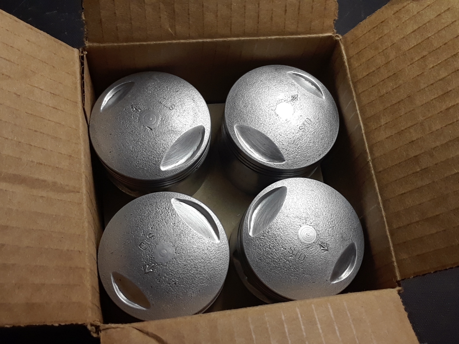

The liners are getting fitted to a set of Wiseco K1172 10.25:1 pistons, which I plan to install on this motor.
Would it make sense to sell these pistons with the 18mm crankshaft as a matched set versus individually?
Otherwise I need to come up with a plan for the functional engine that is currently hibernating in the bike for the Winter...

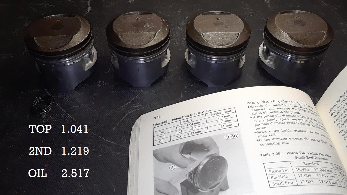

01 Jan 2024 10:22 - 01 Jan 2024 10:32Pistons looks fine.Wristpins not blue .Measure the ringlands and pistons if in spec they are good, but put new rings on.What about the liners are you going to put new ones in?
Ring land measurements:
Cleaned up nicely

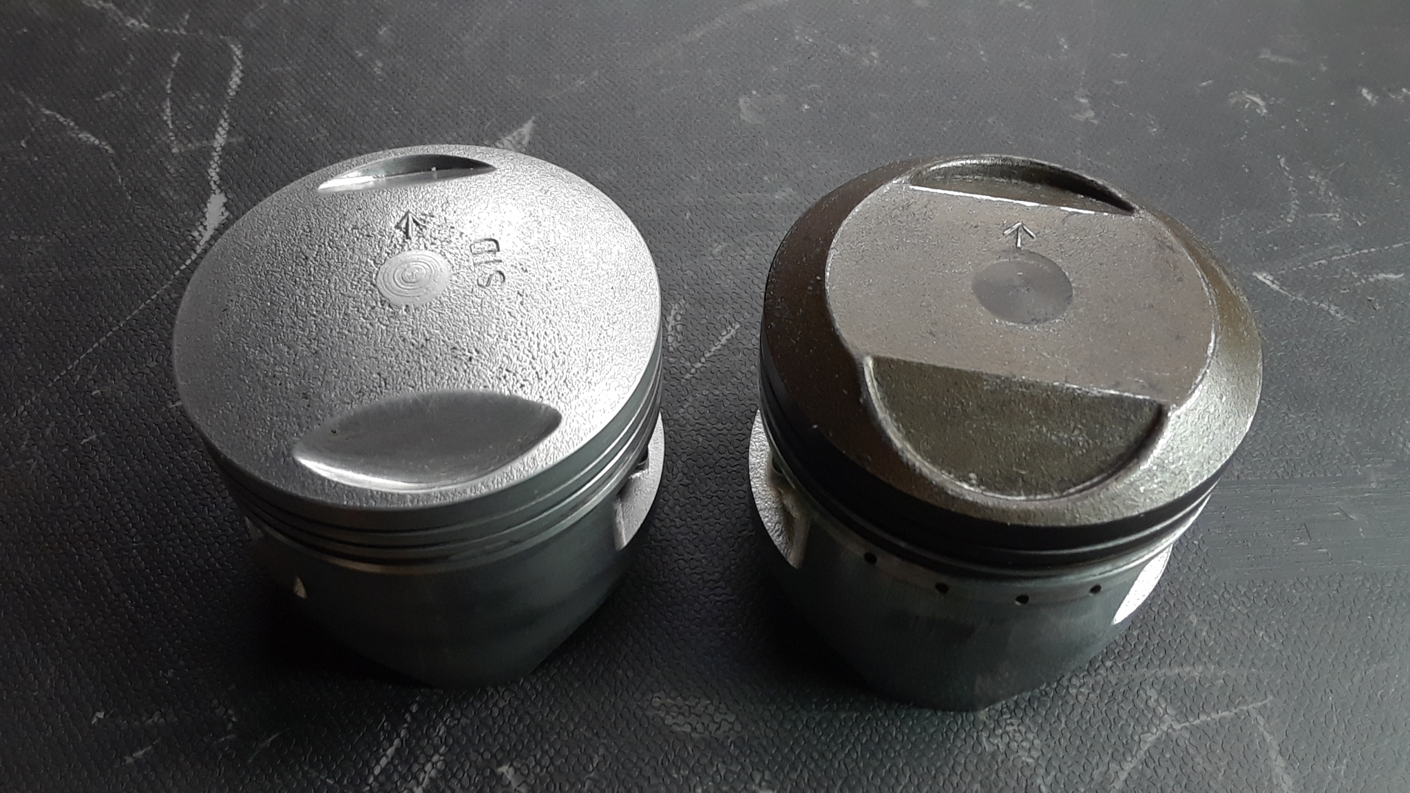

This piston set was originally installed with a bathtub head on my 82 motor in 2015. The set was replaced with MTC pistons in 2019 which as of now have about 22K miles on them.
kzrider.com/forum/2-engine/596933-can-i-run-this-on-my-engine
These pistons differ radically, but share 13008-5037 piston rings according to the Z1 Enterprises "details" but not "fitment information". I have requested verification, though this subject has been addressed previously on the forum. The ring land widths are essentially identical, and the skirts of both sets measure 42.47mm OD:

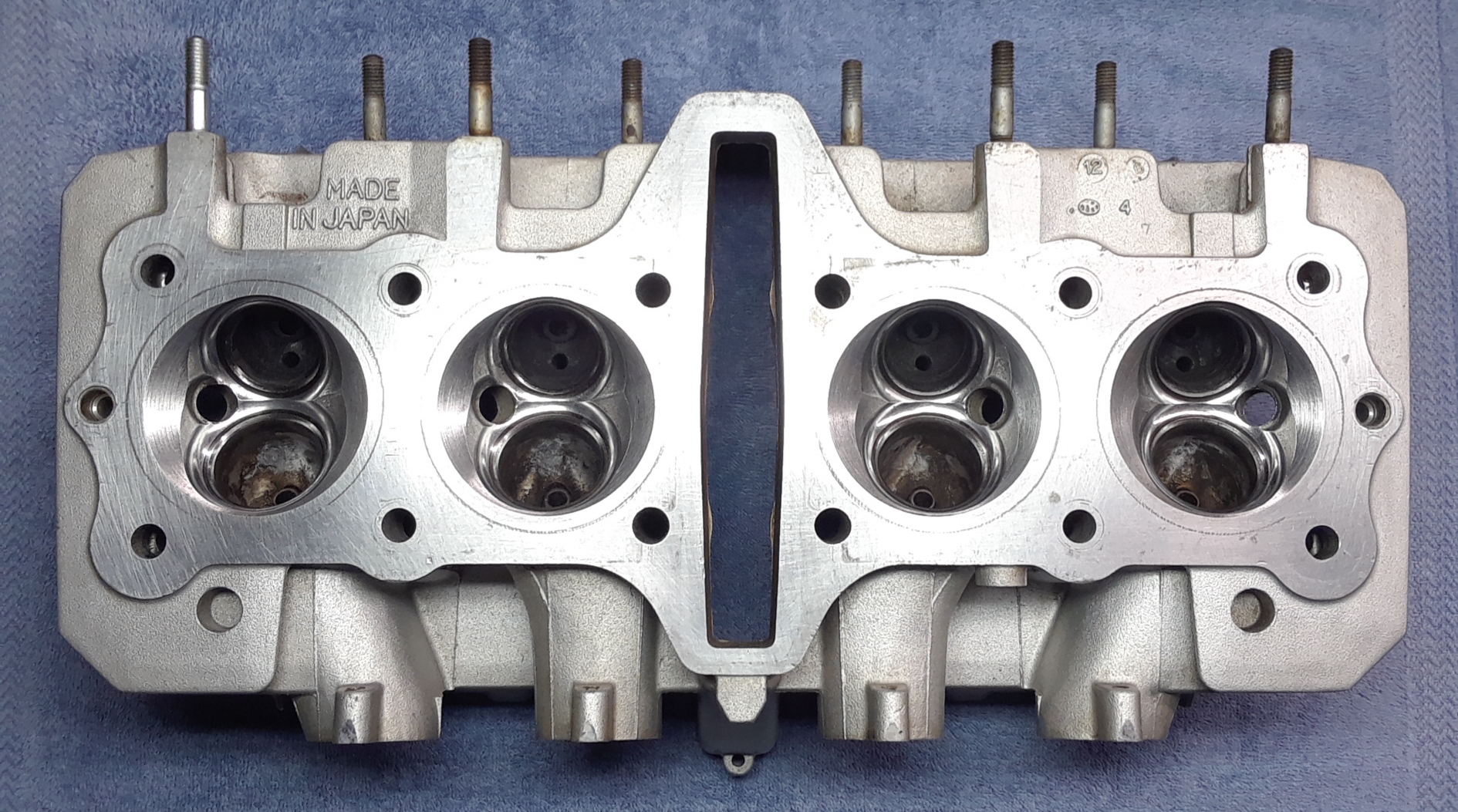

Hmmm...should I Time Sert the spark plug holes before having valves/seats done, or after?
