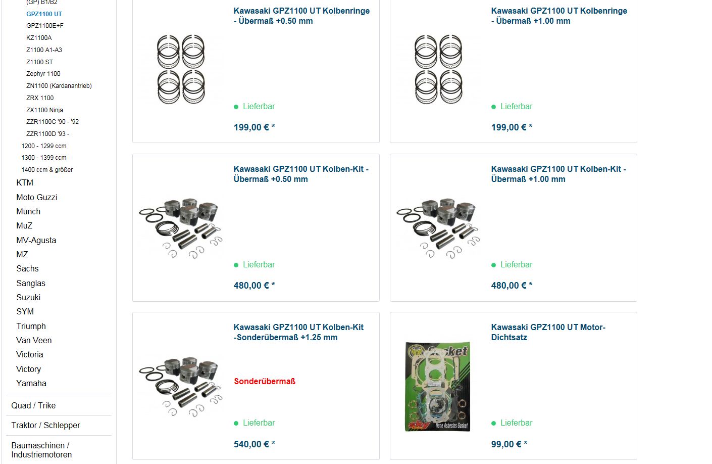

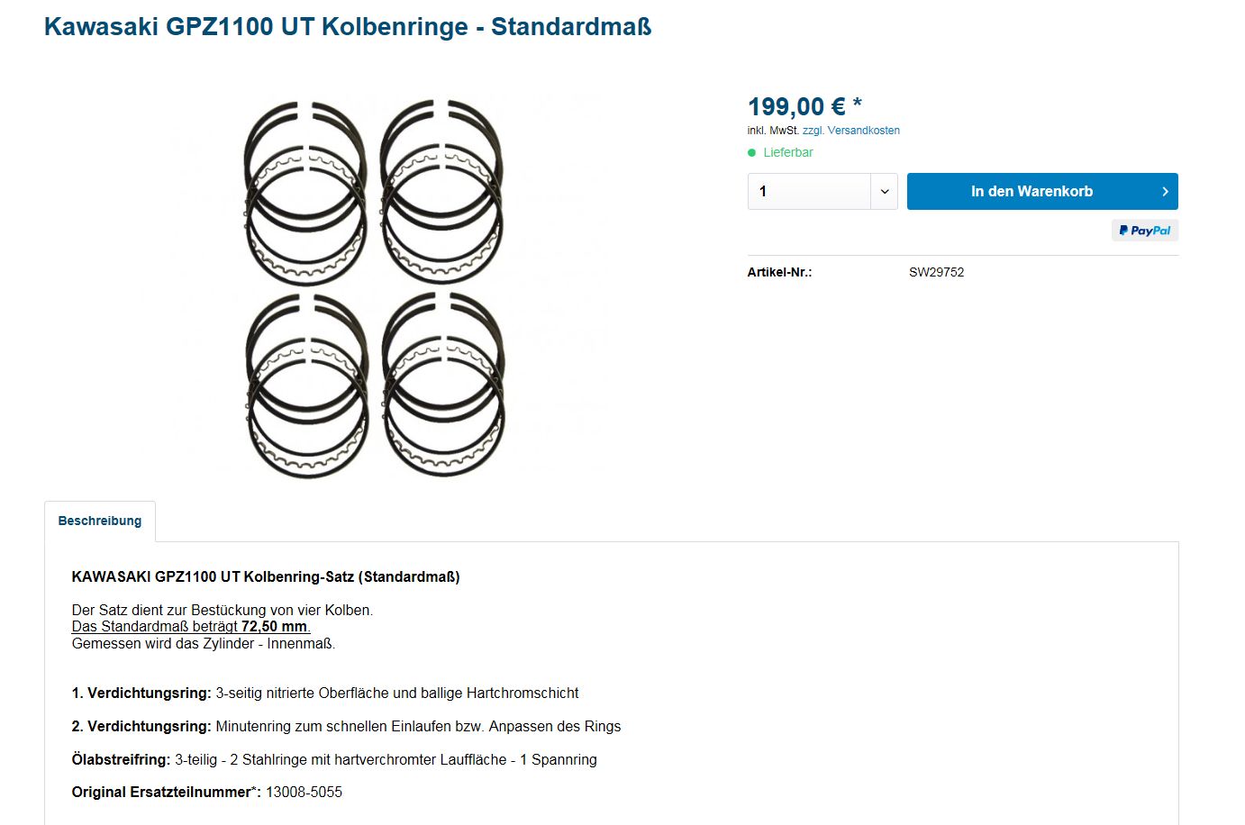

This seller and motor services listed the same standart bore (72,50 mm) piston ring oem# 13008-5055 on all 1100 ccm 2 valve engines
www.scheuerlein-motorentechnik.de/motorr...enringe-standardmass
www.scheuerlein-motorentechnik.de/motorr...1199-ccm/gpz1100-ut/
