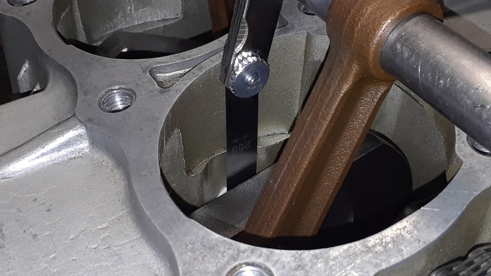

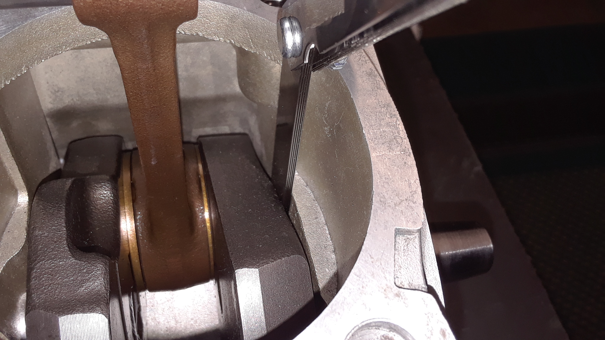

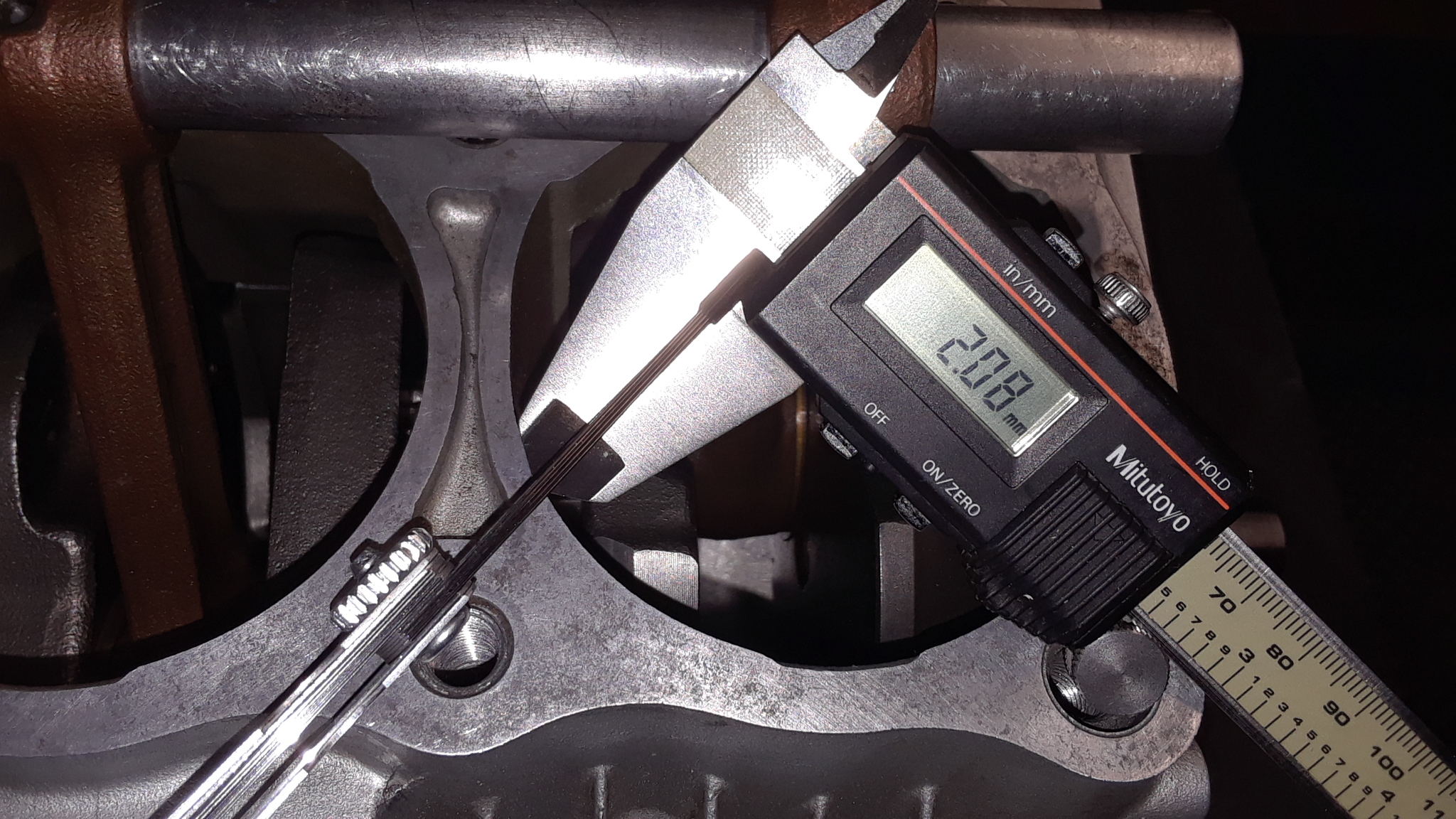

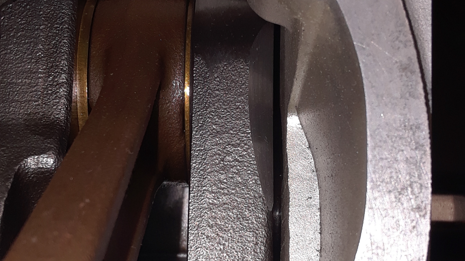

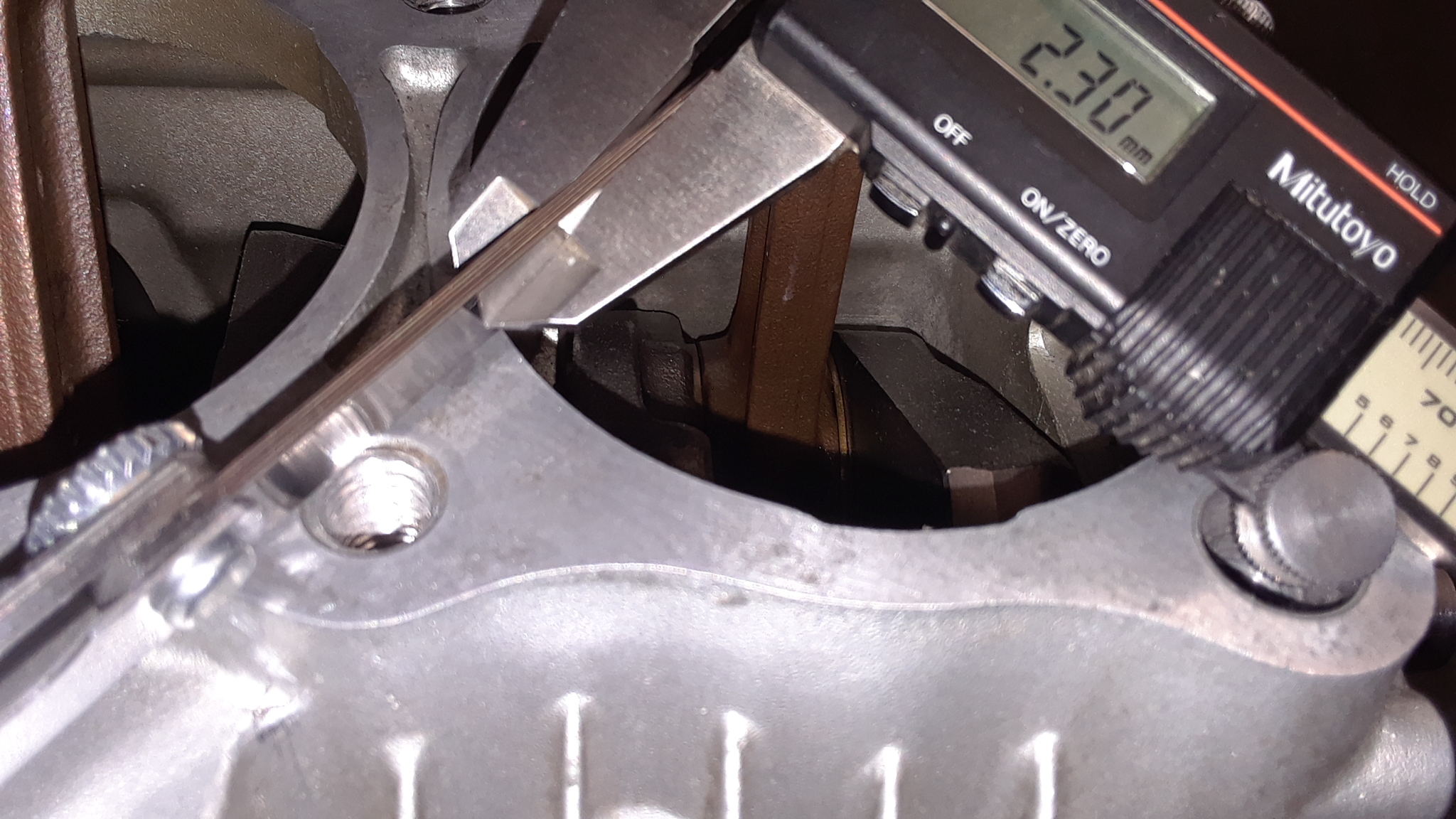

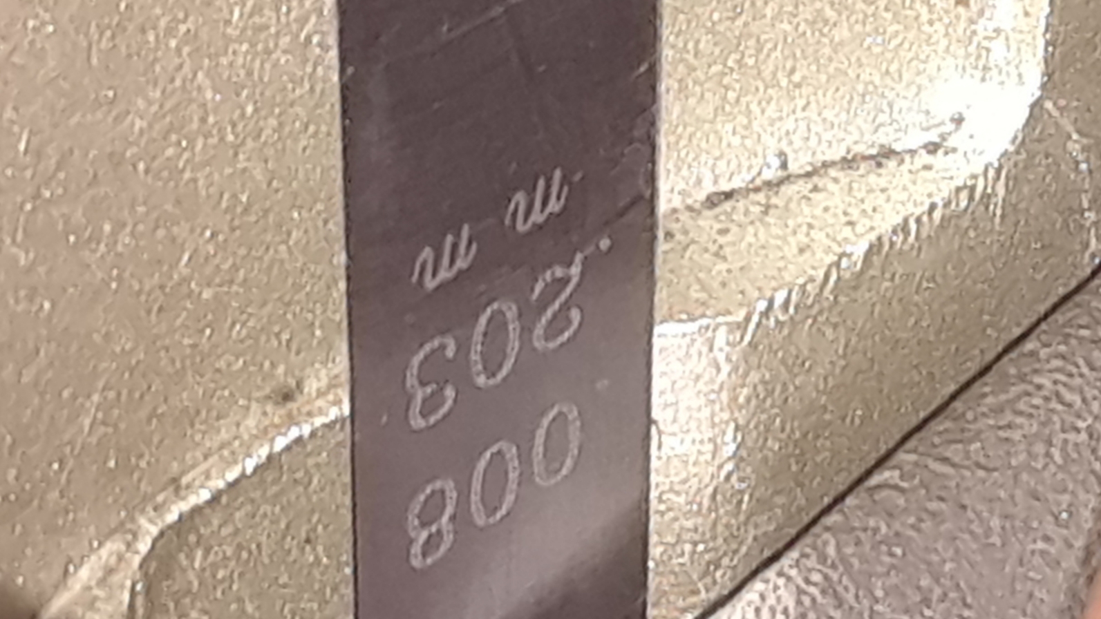

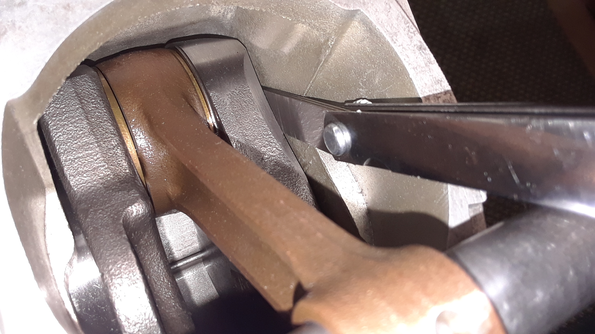

This measurement was easily obtained, and no side-to-side movement of the crankshaft could be detected.
Newly installed welded crank thrust bearing clearance:

Re: Somebody Blew It
10 Jan 2024 02:43That doesn't matter as long as it clears.
2mm is a country mile in engineering terms.

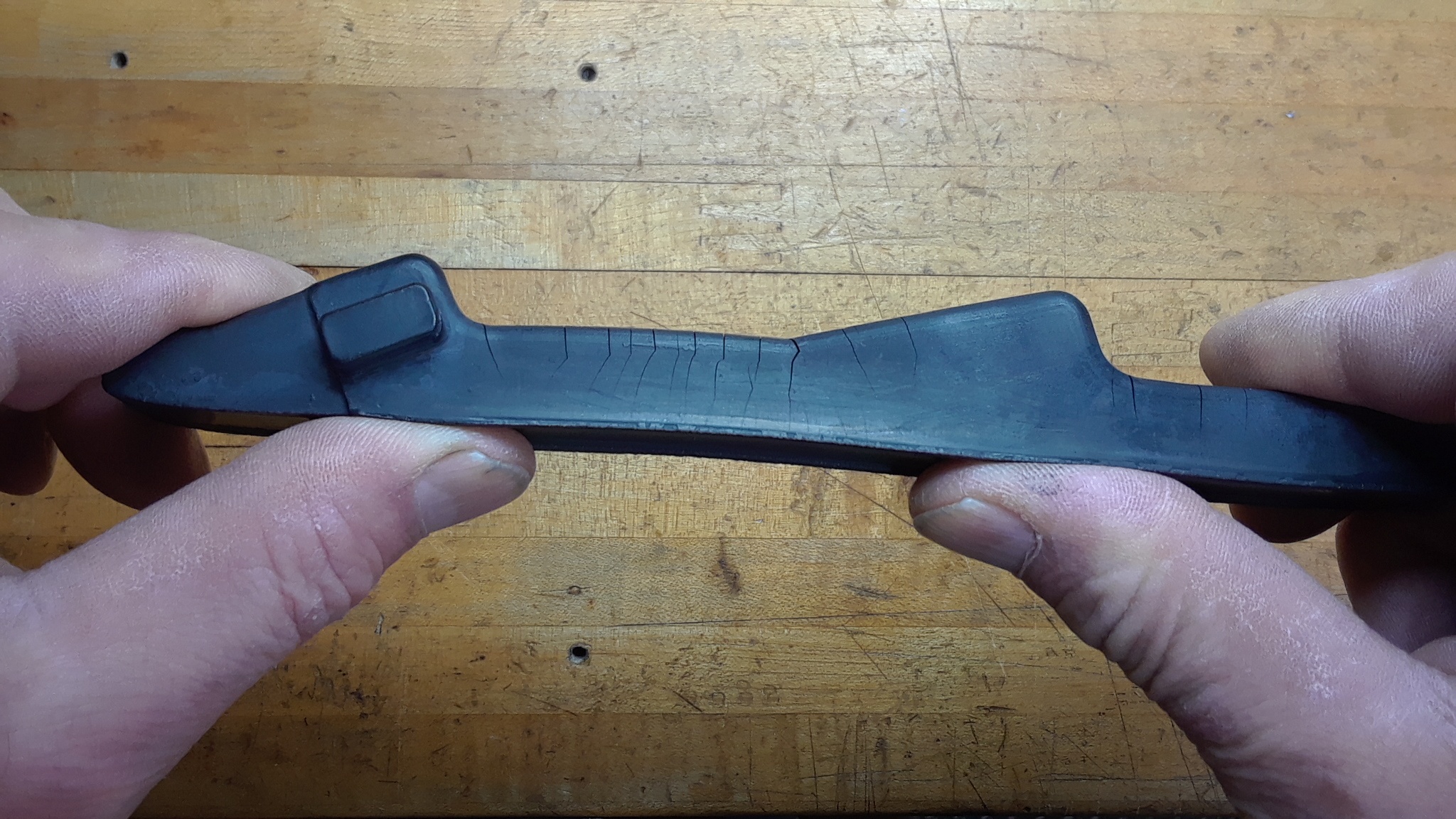

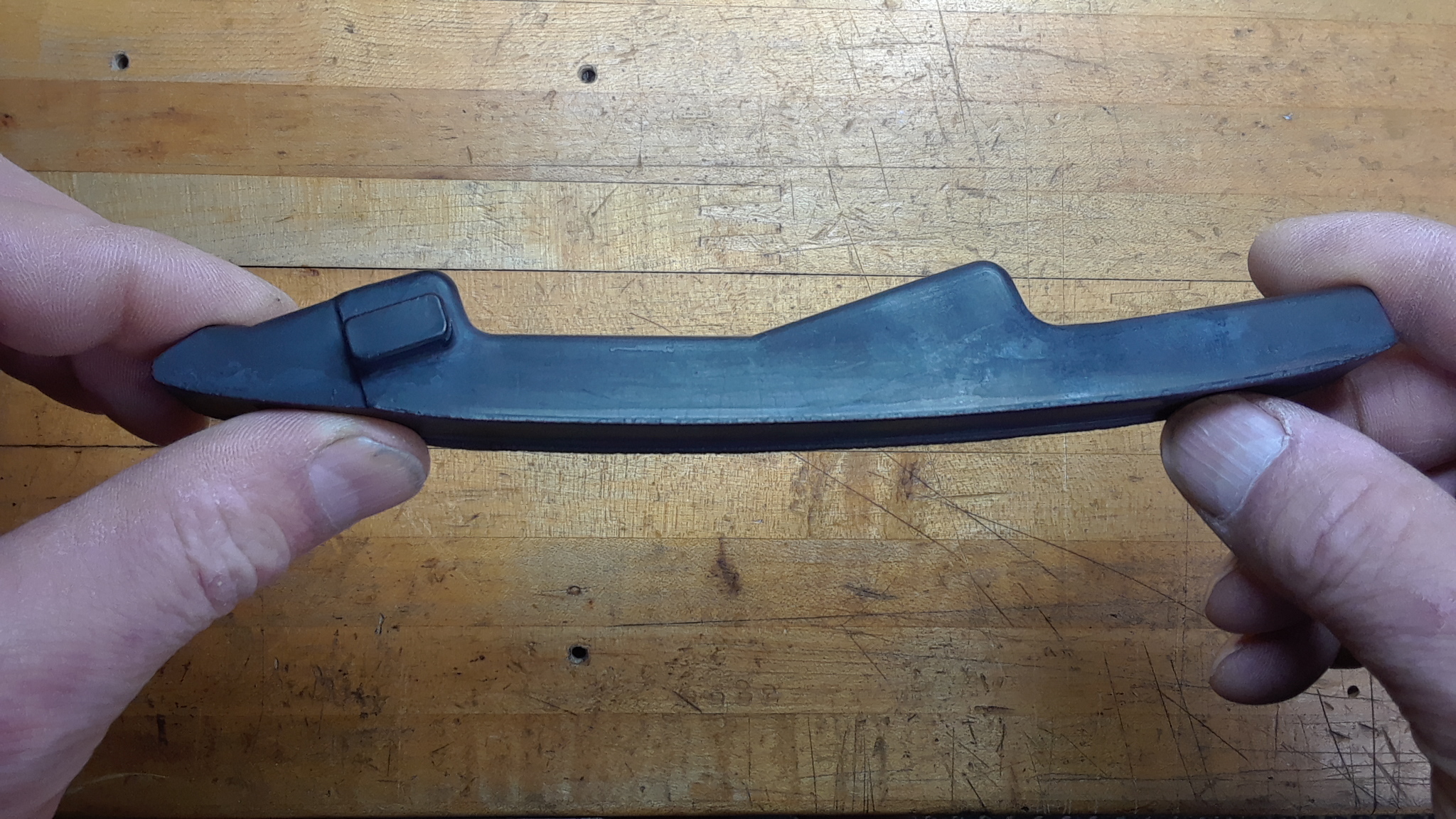

This is the front cam chain guide from a J motor.
Should I feel confident reusing it?
Former guide:
photos.app.goo.gl/zYhL3D86nTu8CJE98

- Posts: 23781
14 Jan 2024 08:58
I wouldn't
- Posts: 6884
- Thanks: 4332
14 Jan 2024 09:30+1I wouldn't
