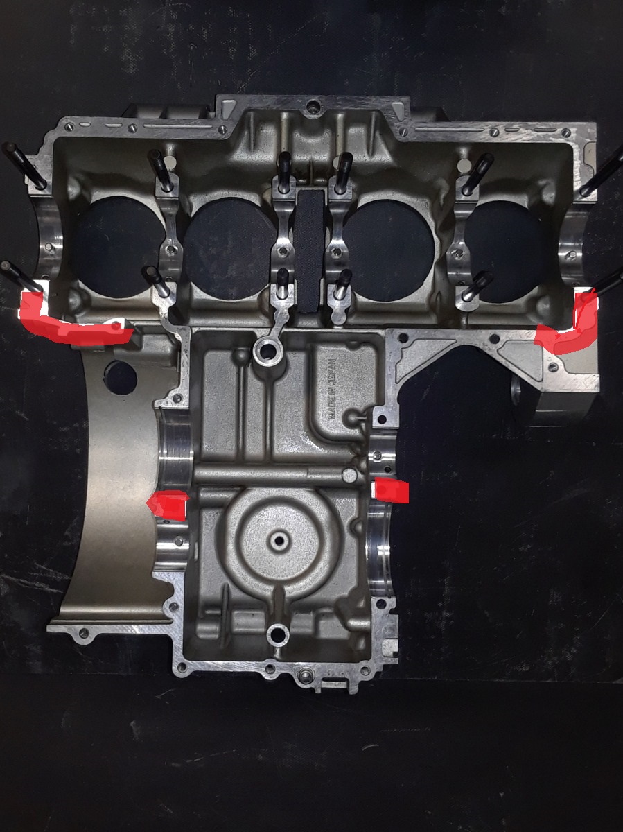

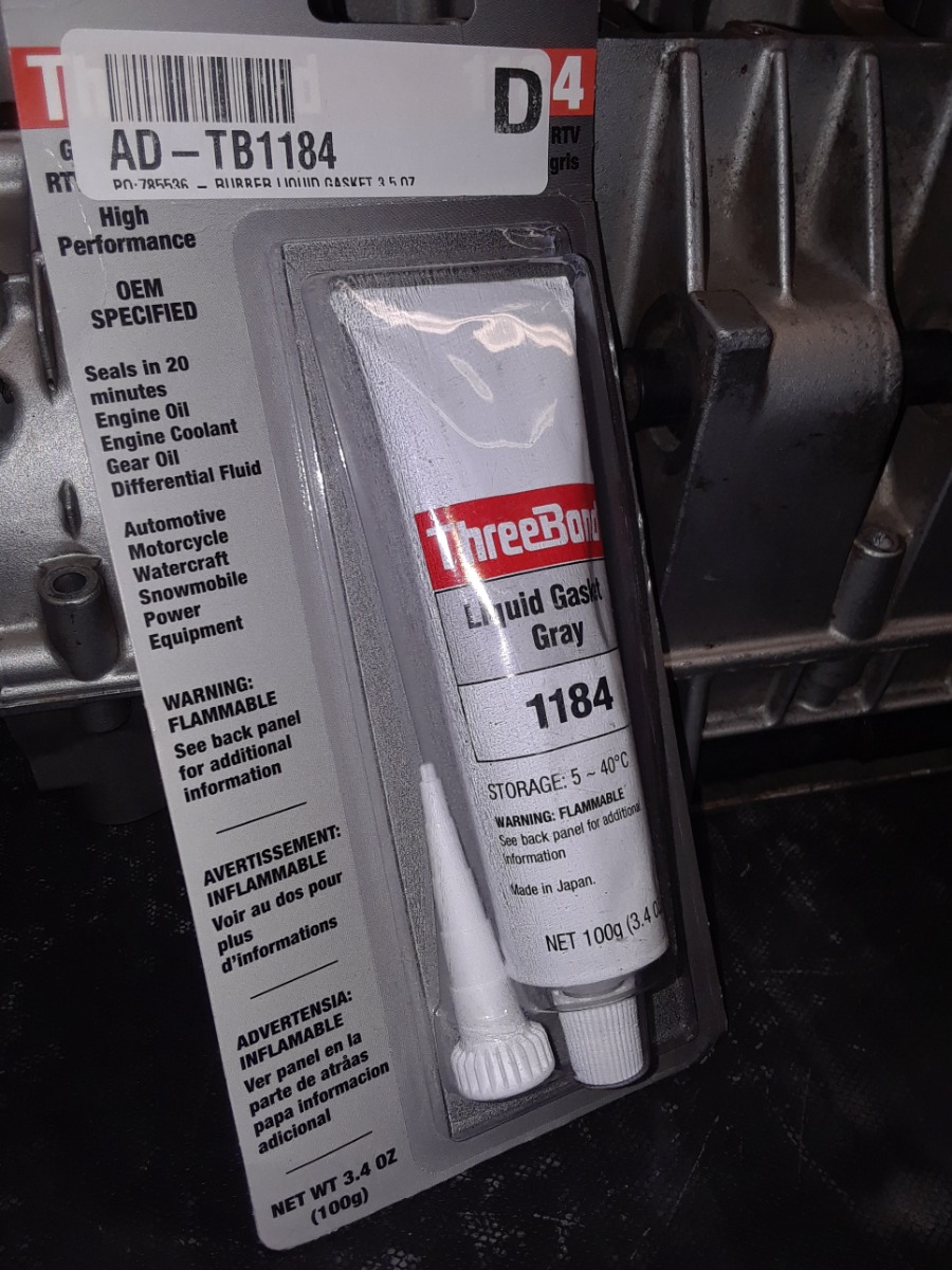

Please highlight in red where sealer needs to be applied on the case image.
Assuming that will be all contact areas where the case halves meet, except the curved bearing surfaces where nothing gets applied.

29 Dec 2023 13:18 - 29 Dec 2023 13:23SWest:
YUP
The package directions recommend usiing a brush or putty knife to spread as even and thin coat as possible on both surfaces, and wait one minute before mating the parts.
Somewhere else it was noted that you have four minutes to get this done.
WAIT A MINUTE. HELLO!
1982 KZ1100-A2/1170 sleeper 😀
Last edit: 29 Dec 2023 13:23 by daveo.
- Posts: 23782
Re: Somebody Blew It
29 Dec 2023 13:22
I wouldn't use it where the bearings are. I use a light smear with my finger and put it together right away wiping off the excess while still wet.

Start watching about 45:32. it’s fast forward but you can clearly see he spreads sealer with his finger on both case halves. He puts the trans in after spreading sealer so it appears you have good working time
Last edit: 29 Dec 2023 19:47 by Mikaw.
29 Dec 2023 19:55
Aslo here at 5:10.

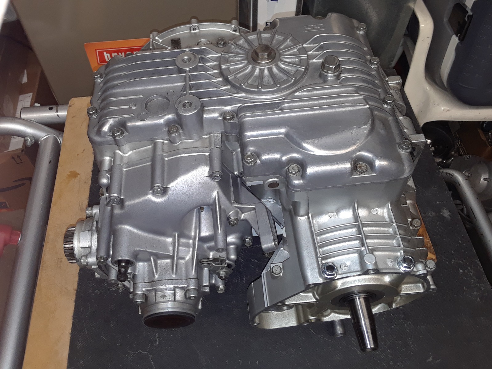

Accomplished it last night, somehow without a single glitch. Amazing.
Rubbed sealer on with my finger tip and kept moving along at a frenzied but steady pace, and must have looked like the guy in that video. Lol
I did remember to check my timer after twenty-four minutes passed, but only after all the case bolts and stud nuts had been torqued.
Applying blue Loctite 242 to each nut prior to stud attachment was the fumblest part of the process.
All good for now!

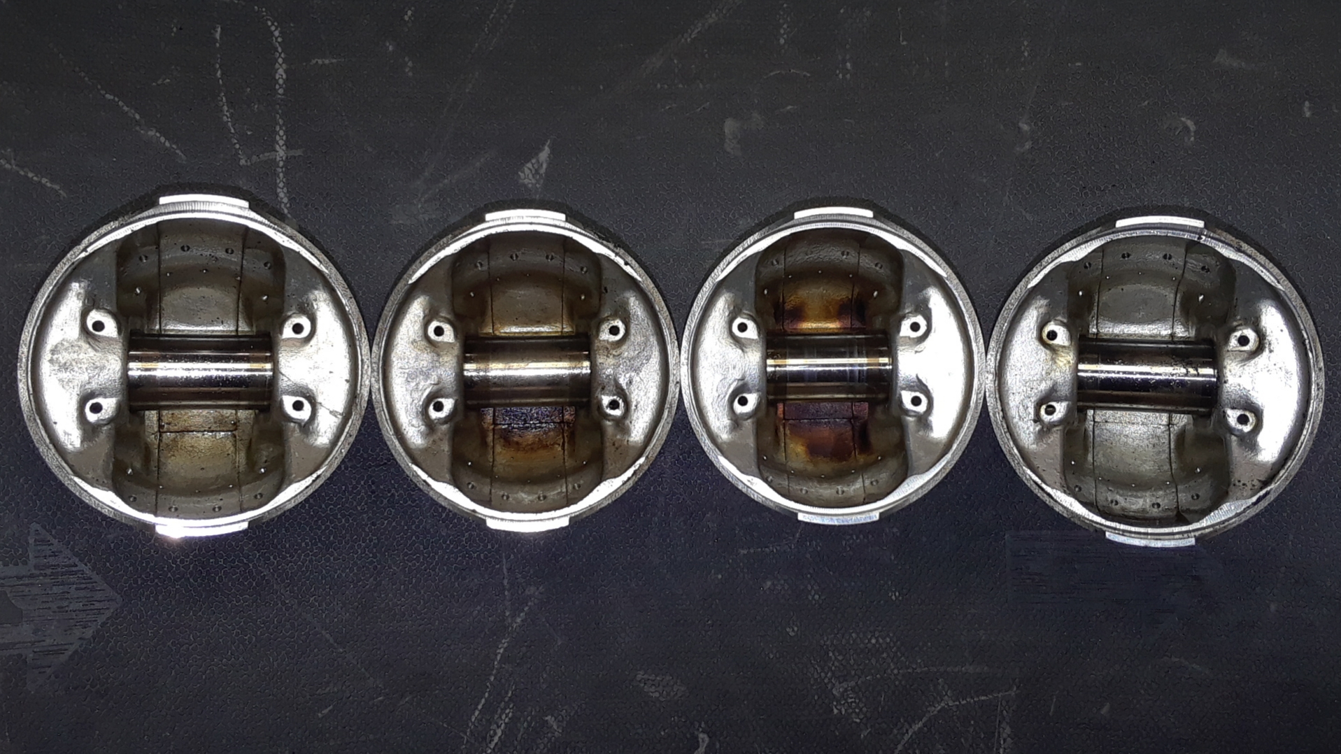

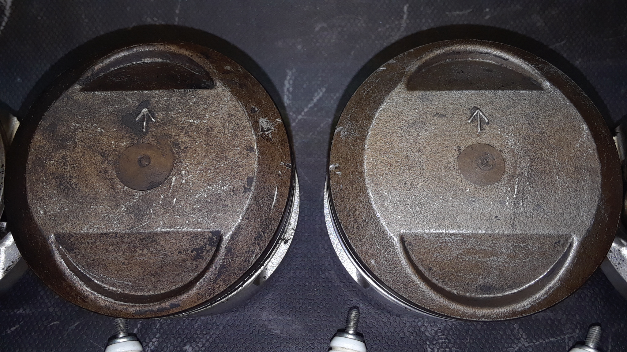

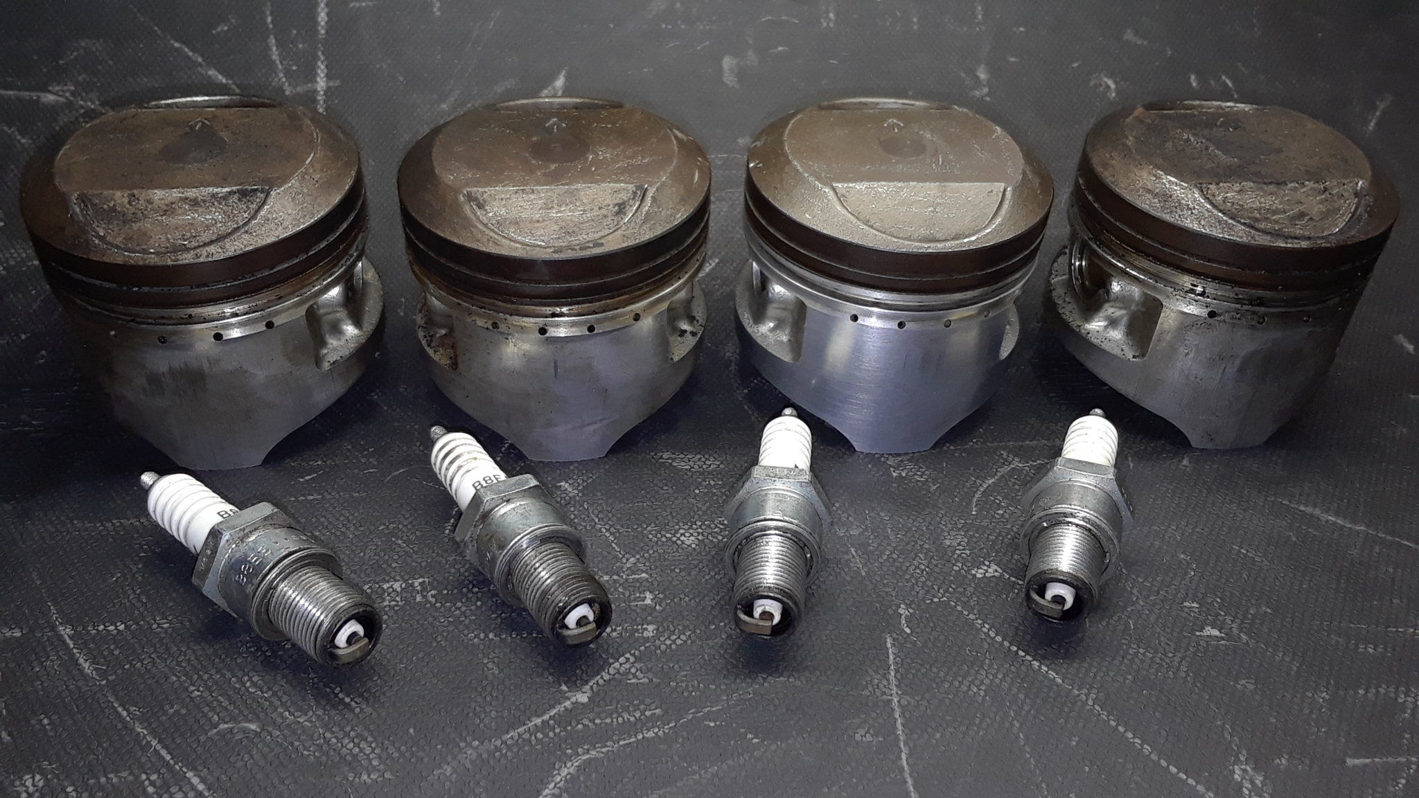

Thought I'd check them out, and do a little clean up on the pistons.
Lean carb settings may have caused both head gaskets to blow.
Apparent heat damage shows on both #2 and #3 pistons
