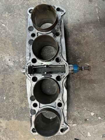

Re: Somebody Blew It
13 Dec 2023 08:16
#892695

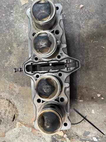

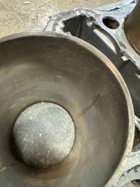

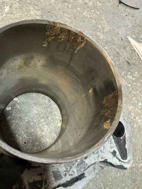

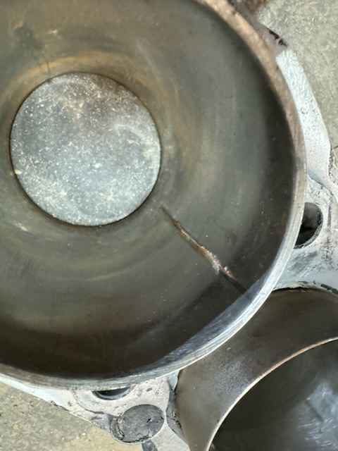

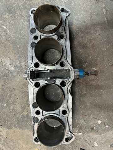

Using an 18" Starrett rule, the head doesn't appear warped from being overheated.
I can't understand how the cylinder cooling passages got plugged solid with grimy grit like concrete while the rest of the motor remained comparatively pristine.
1982 KZ1100-A2/1170 sleeper 😀
  • SWest
  • SWest's Avatar
  • 10 22 2014
  • Posts: 23786
  • Thanks: 3051
13 Dec 2023 08:42
#892696
The front tire slings up all that crap that goes unnoticed.

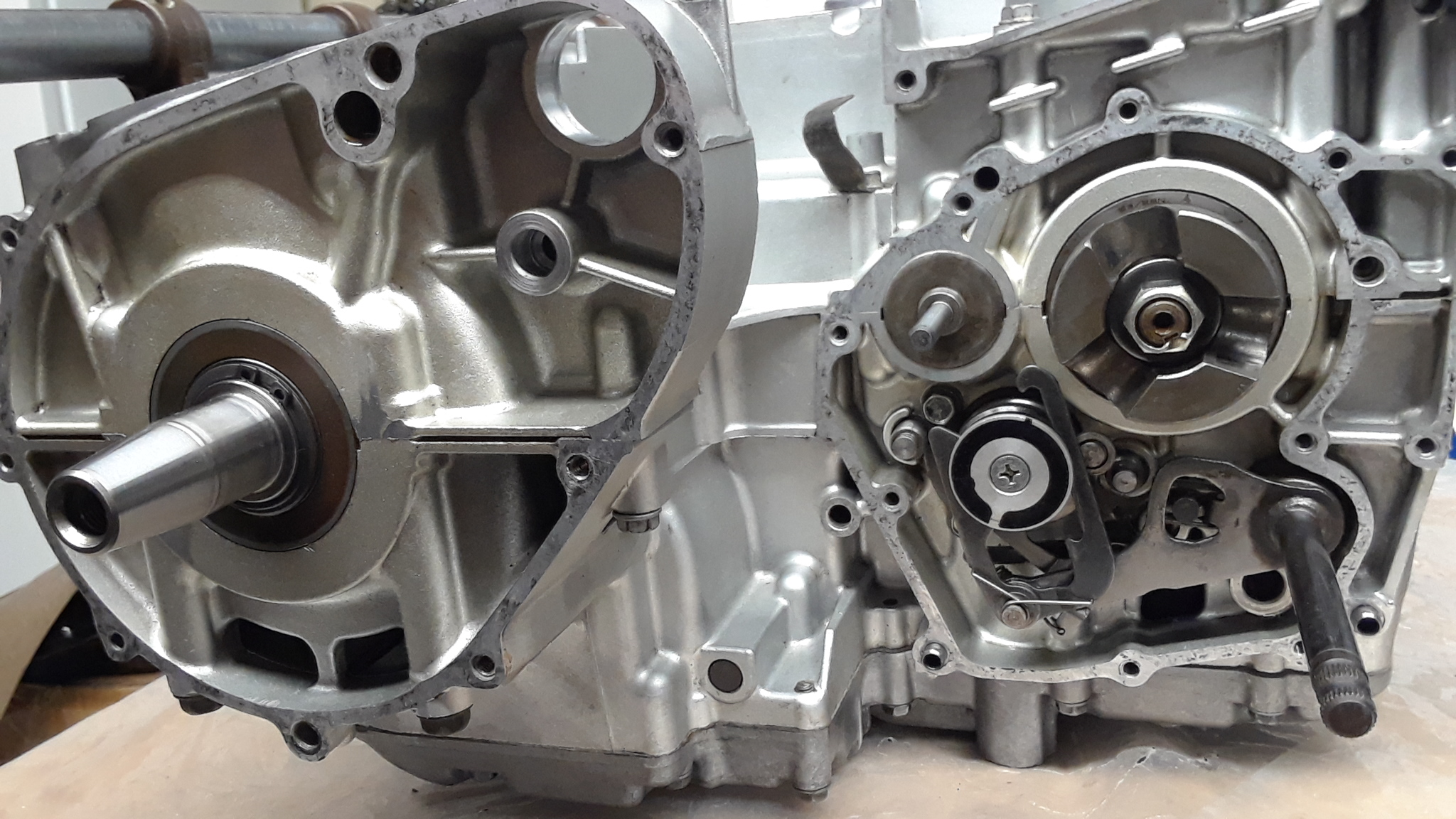

13 Dec 2023 09:37
#892698

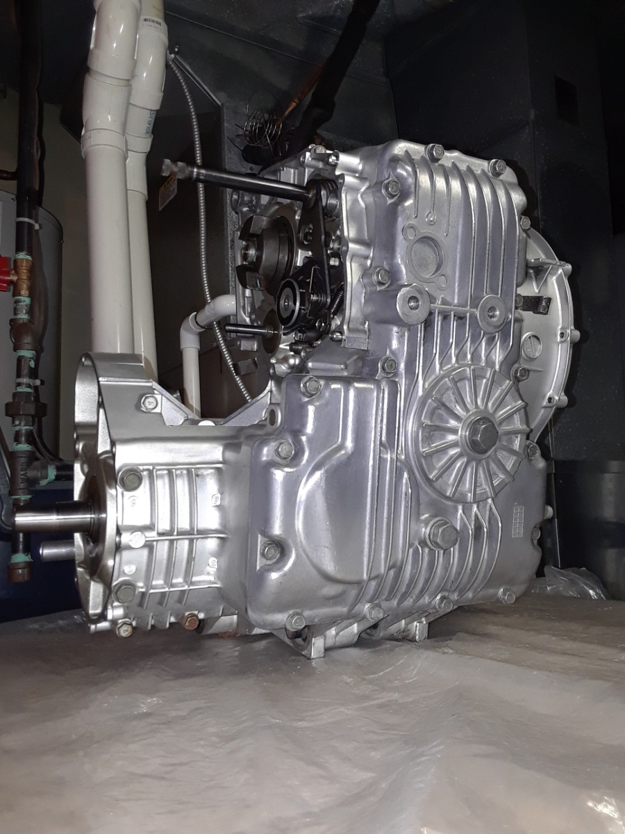

Nice job!  is that a z1000 engine ?  and do you or anyone else know if it is possible to take off the sump while engine is in bike?  I cant check now because my bike is in a winter storage .
  • zed1015
  • zed1015's Avatar
  • Posts: 3376
  • Thanks: 2087
13 Dec 2023 10:53
#892704
Yes! The sump comes off with the engine in situ.
13 Dec 2023 11:34
#892705
ZN1100B shares the same J-model engine case, as I understand.

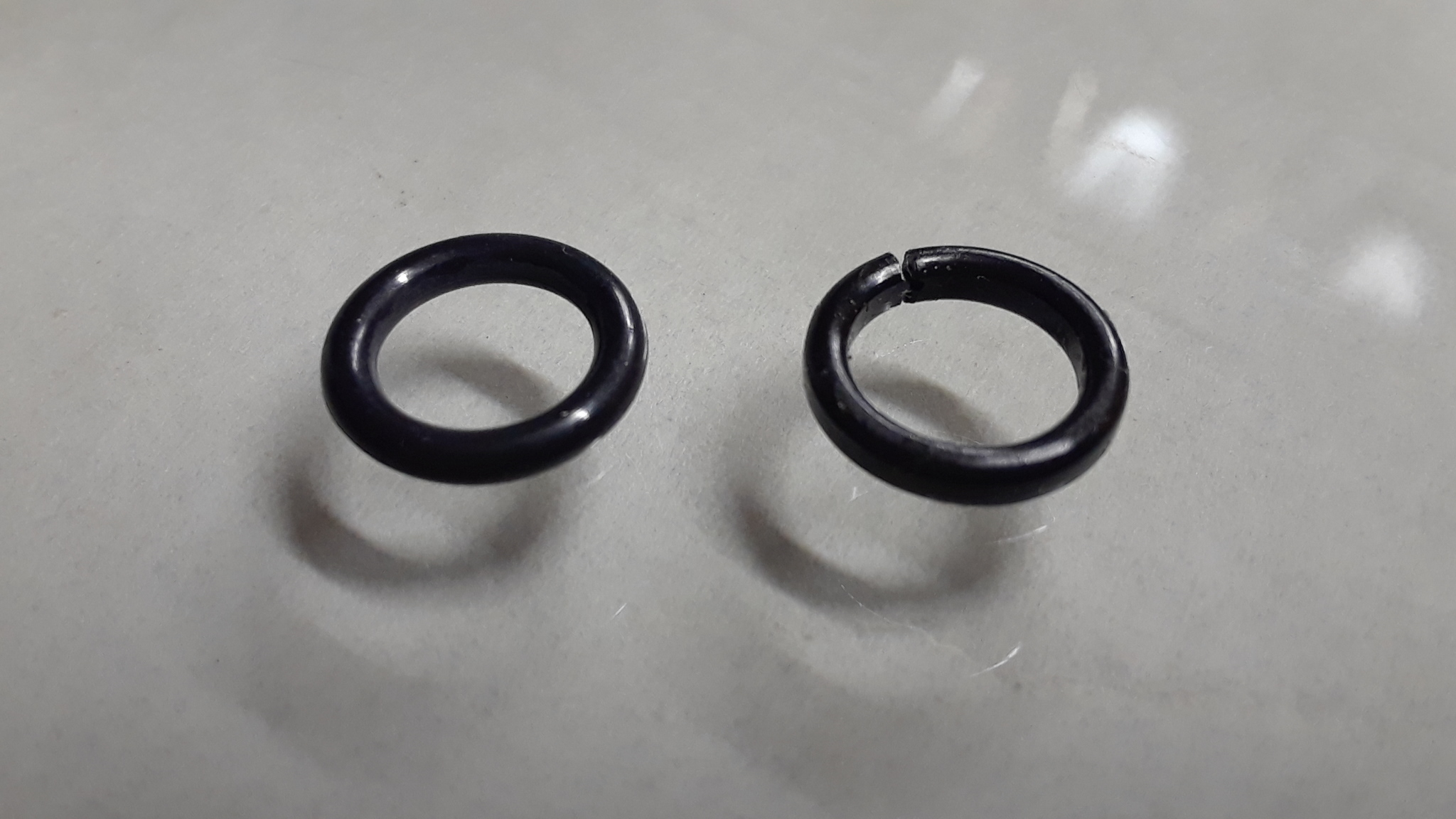

BTW I replaced the original clutch push-rod O-RING, and have a few spares for cheap, if anybody needs one.

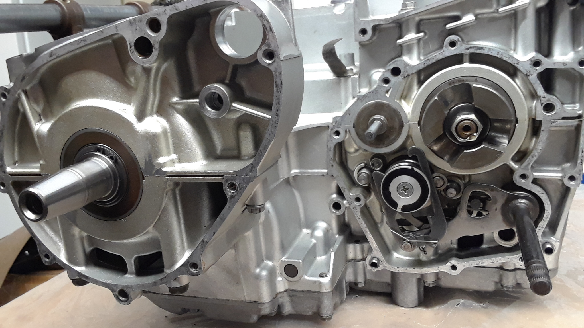

14 Dec 2023 13:40 - 14 Dec 2023 13:51
#892731
Hmmm...
I won't never be closer
Decisions, decisions...the decisions are plenty
14 Dec 2023 15:37
#892736
Pop it in those cases, it'll keep the dust off it
14 Dec 2023 20:40 - 14 Dec 2023 20:56
#892739
Closer still
Oh Sooo tempting:

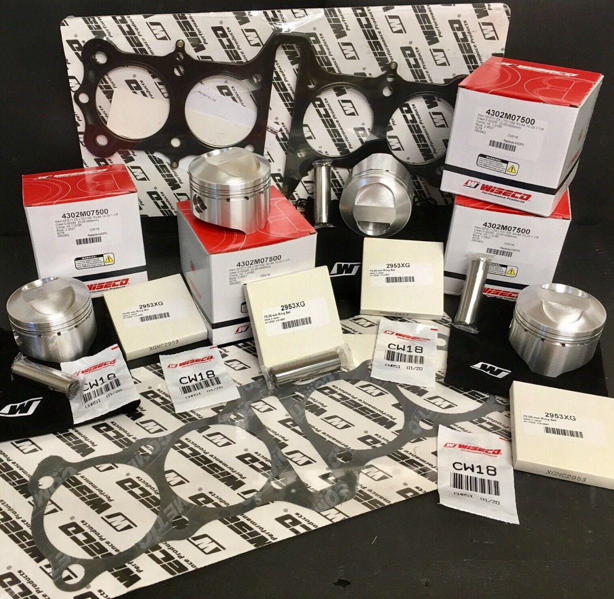

14 Dec 2023 20:48
#892740
This is frightening.
1015 barrels bored to 1075.
  • daveo
  • daveo's Avatar Topic Author
  • Premium Member
  • Premium Member
  • Posts: 3190
  • Thanks: 910
14 Dec 2023 21:06
#892741
WT...?
  • SWest
  • SWest's Avatar
  • 10 22 2014
  • Posts: 23786
  • Thanks: 3051
14 Dec 2023 21:14
#892742
He said it came off a running bike.
