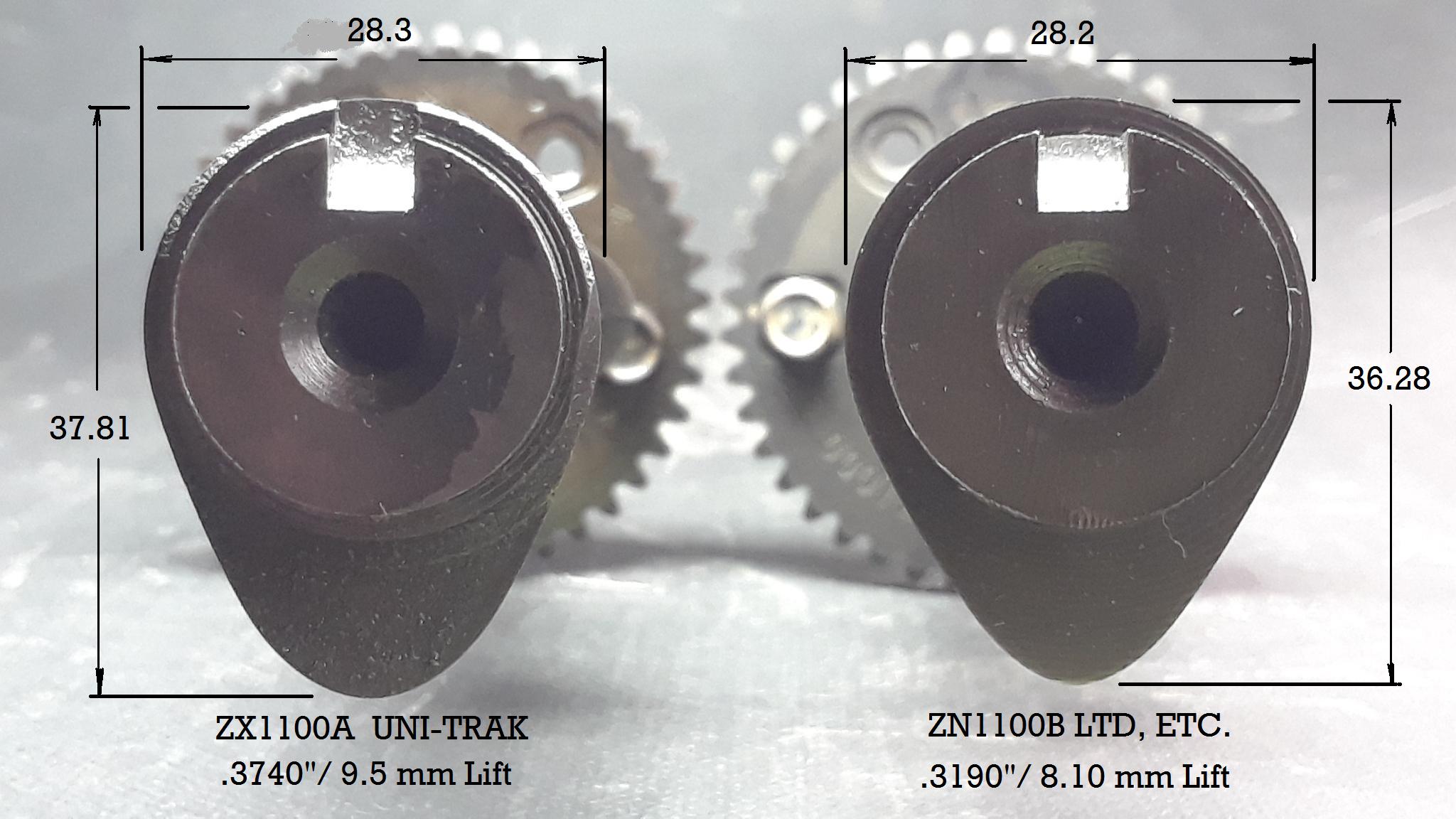

14 Mar 2024 14:49 - 14 Mar 2024 15:07Am I right in thinking these are the highest performance OEM cams used in the KZ/GPZ range ? would like a set but they are like "hens teeth"Unitrack.
I do believe so...
www.deviantart.com/jaymz1976/art/Hens-Teeth-788448307
My interpretation:
300 Uni-Trak degree duration vs. 270 KZ, ZN, etc. other J's
See:
Stock J-model cam options? - KZRider Forum - KZRider, KZ, Z1 & Z Motorcycle Enthusiast's Forum
www.kzrider.com/forum/2-engine/590239-stock-j-model-cam-options

That's really interesting Dave, my stock "K" cams have a height of 36.0 where as the"J" has 36.9 on the inlet and 36.5 on the exhaust. I have managed to find a pair of "J" inlets so 36.9 on both which appears to put them in the middle of your stock 1100 and your "Uni" cams so should at least give me back what KHI took away for the "K"

14 Mar 2024 15:29Yes! highest stock lift of the big aircooled fours.Am I right in thinking these are the highest performance OEM cams used in the KZ/GPZ range ? would like a set but they are like "hens teeth"Unitrack.
I have a set for my turbo, they measure 9.7mm lift.

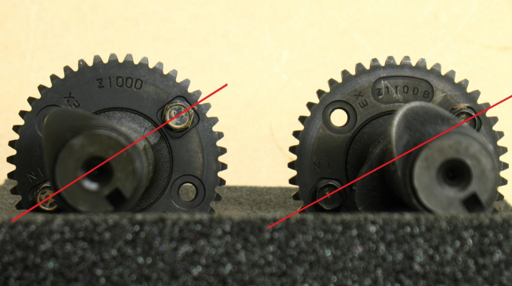

16 Mar 2024 03:06
Dave you're naughty
the angle of the picture is different (I've never seen a sprocket where the mountings are not on the centre axis unless there is three bolts) have these cams previously been run as a conversion in an earlier engine (left one is marked up as Z1000)
