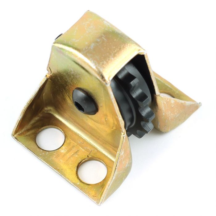

Hello everyone, guys. I would like to know your opinion about the sound of my engine. It sounds like a metallic scraping sound. Is this normal? I have to mention that the idle wheel of the camshaft chain is a cheap version, could that be causing the noise?

Is your cam chain tensioner OK, because the sound seems to disapear when your machine revs up!
How old is your top idler sprocket?
The following user(s) said Thank You: MLMG

Hello, the idler sprocket and timing chain only have 35 km. Could it be that it is ready to adjust the chain tensioner? I'm going to look tomorrow.

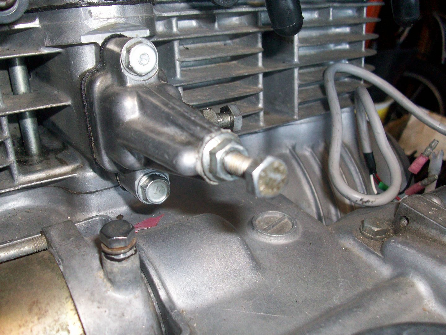

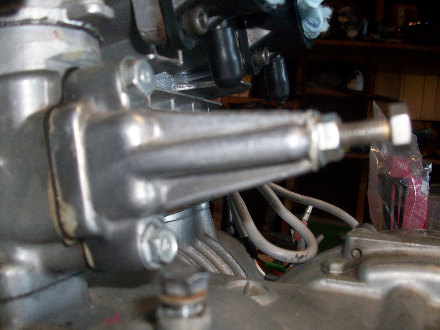

The spring in the stock cam chain tensioner is to weak to set the chain slack right.
I do modify to a manual cam chain tensioner, works perfect for me.
You can adjust the tension on a runnig engine with the force of your finger tips only.
www.kzrider.com/forum/2-engine/575505-ho...-cam-chain-tensioner
Edit: need no Helicoil, cam chain tensioner cast have enough "meet". Center punch, drill 5 mm, cut M6 and ready to go...
Last edit: 29 Apr 2023 15:54 by Scirocco.
