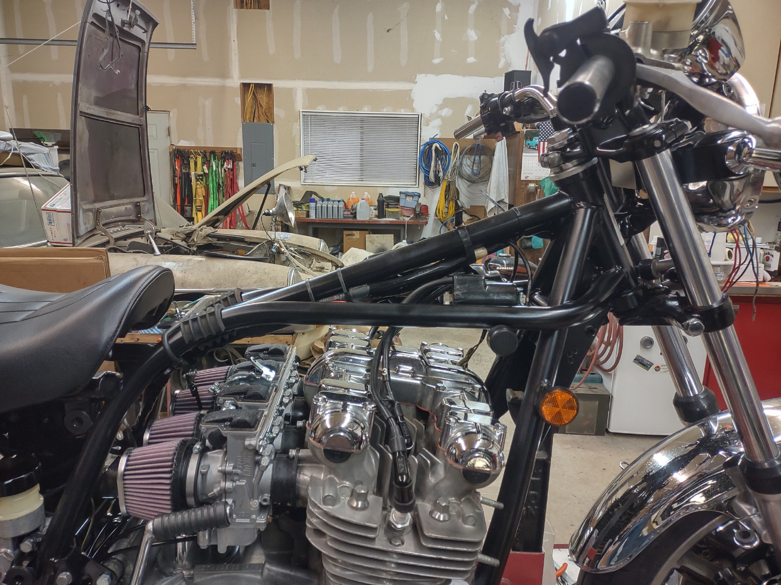

We just installed RS 34 carbs on my 77' KZ 1000LTD But haven't been able to ride it but about 25 miles so far. But they are working great so far. Once you get the head damage sorted out you'll be happy with the RS 34's. We already have put a set on our 80' Suzuki GS 1100E we're really happy with those. We're also thinking about getting a set for the 83' CB 1100F.

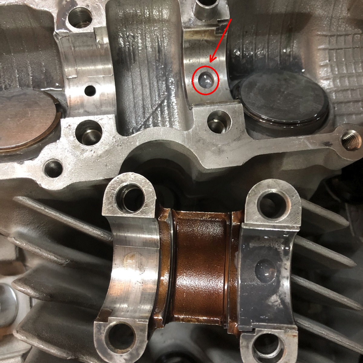

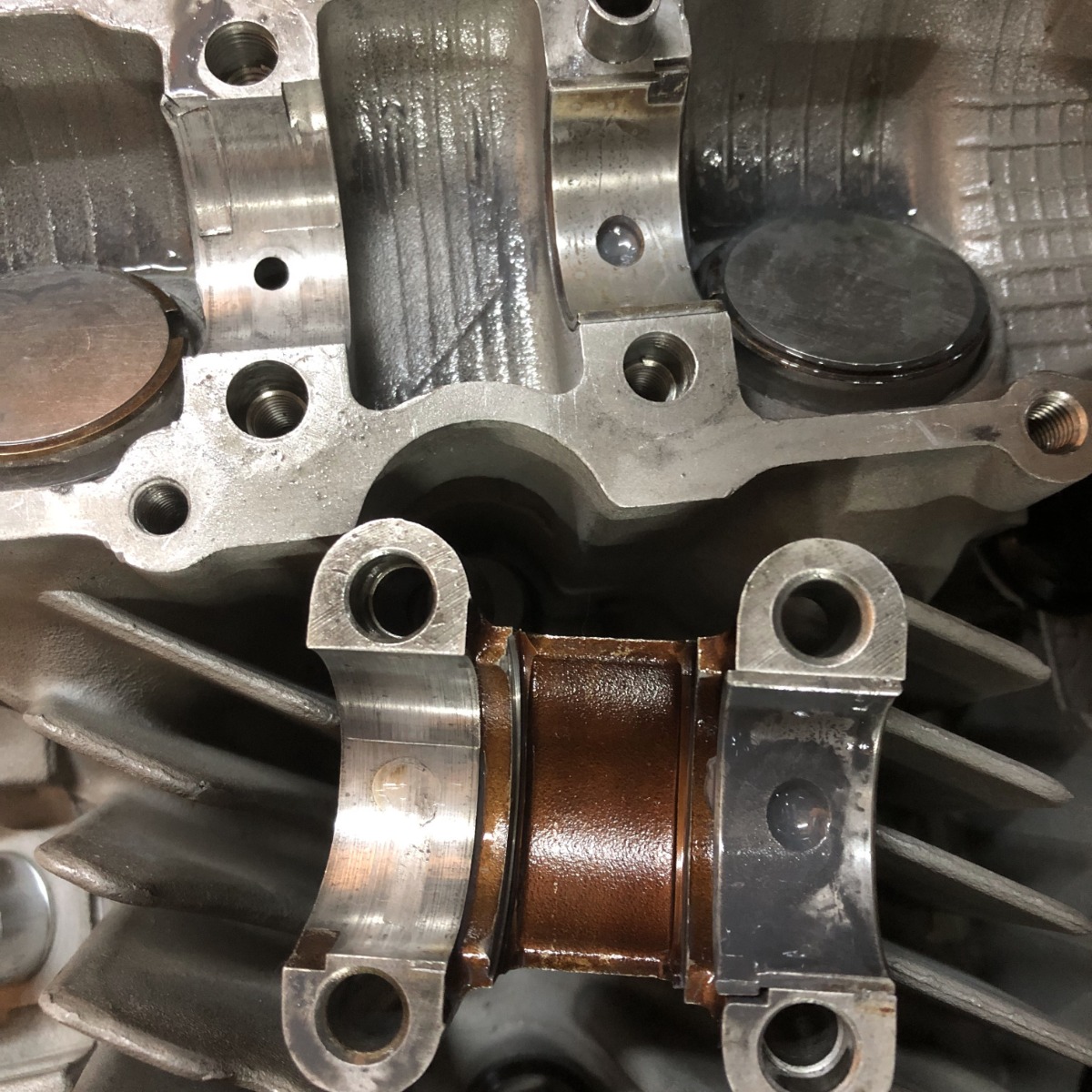

Camshaft bearings lost tabs when turning.

14 Apr 2023 00:00Where did you apply grease ref the above ? Stunning bike by the wayHello everyone, I have a problem that's making me nervous.It's a kz1000 A1. The cylinder head was repaired, new stainless steel guides and valves were added, and the camshaft bearings were also changed.On the first start, the engine stopped running immediately, and upon disassembly, some bearings were found to have stuck to the camshaft.I thought maybe I didn't lubricate it enough after multiple starts.On the second attempt, I used some of the old bearings and some new ones, making sure to apply grease from the first assembly and plenty of oil to the bearings.After 5 starts and the engine running for 3 seconds, it suddenly stopped. Upon disassembly, one of the new bearings on the exhaust camshaft had stuck and turned.Has anyone had problems with new camshaft bearings?Thank you.

Using grease in a low pressure/high flow oil lubricating system is not the best idea! Look at your lower cam journal, cam bearing oil port is clogged!

14 Apr 2023 01:59 - 14 Apr 2023 05:07That does appear to have picked up dry either side of the oil feed drilling.
As Scirocco states you shouldn't use grease on the bearings, it's likely to have plugged the oil feed and whilst the grease plug has lubed the center strip the bearing has run dry either side where the grease is too thick to spread.
Either a light smear of assembly compound such as Graphogen or just a coating of the same engine oil you are using is all that's needed and a few spins on the starter with the plugs out to prime the pump and circulate the oil is the way to go.
Doing that with the cam cover off will give visual confimation that oil is reaching all the cam journals.
