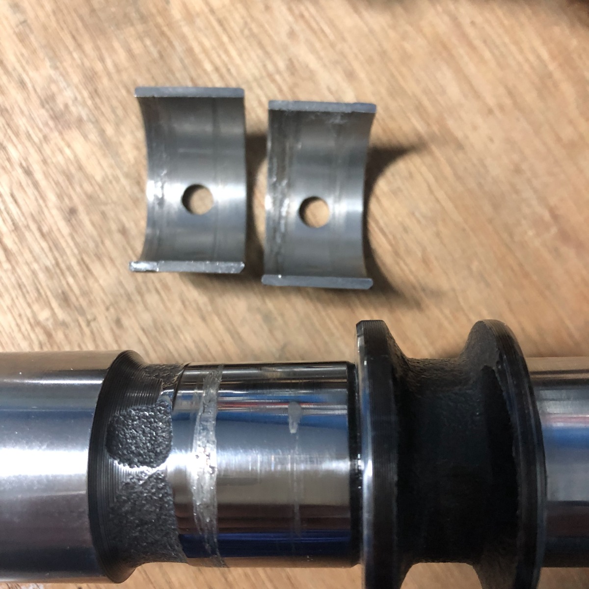

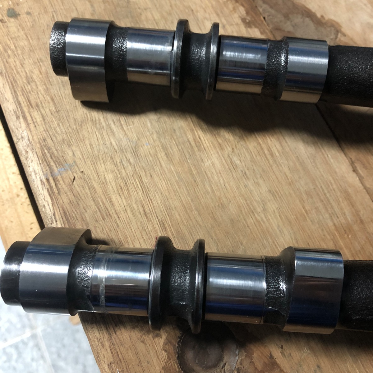

Hello everyone, I have a problem that's making me nervous.It's a kz1000 A1. The cylinder head was repaired, new stainless steel guides and valves were added, and the camshaft bearings were also changed.On the first start, the engine stopped running immediately, and upon disassembly, some bearings were found to have stuck to the camshaft.I thought maybe I didn't lubricate it enough after multiple starts.On the second attempt, I used some of the old bearings and some new ones, making sure to apply grease from the first assembly and plenty of oil to the bearings.After 5 starts and the engine running for 3 seconds, it suddenly stopped. Upon disassembly, one of the new bearings on the exhaust camshaft had stuck and turned.Has anyone had problems with new camshaft bearings?Thank you.

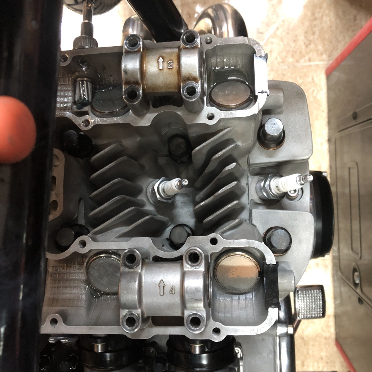

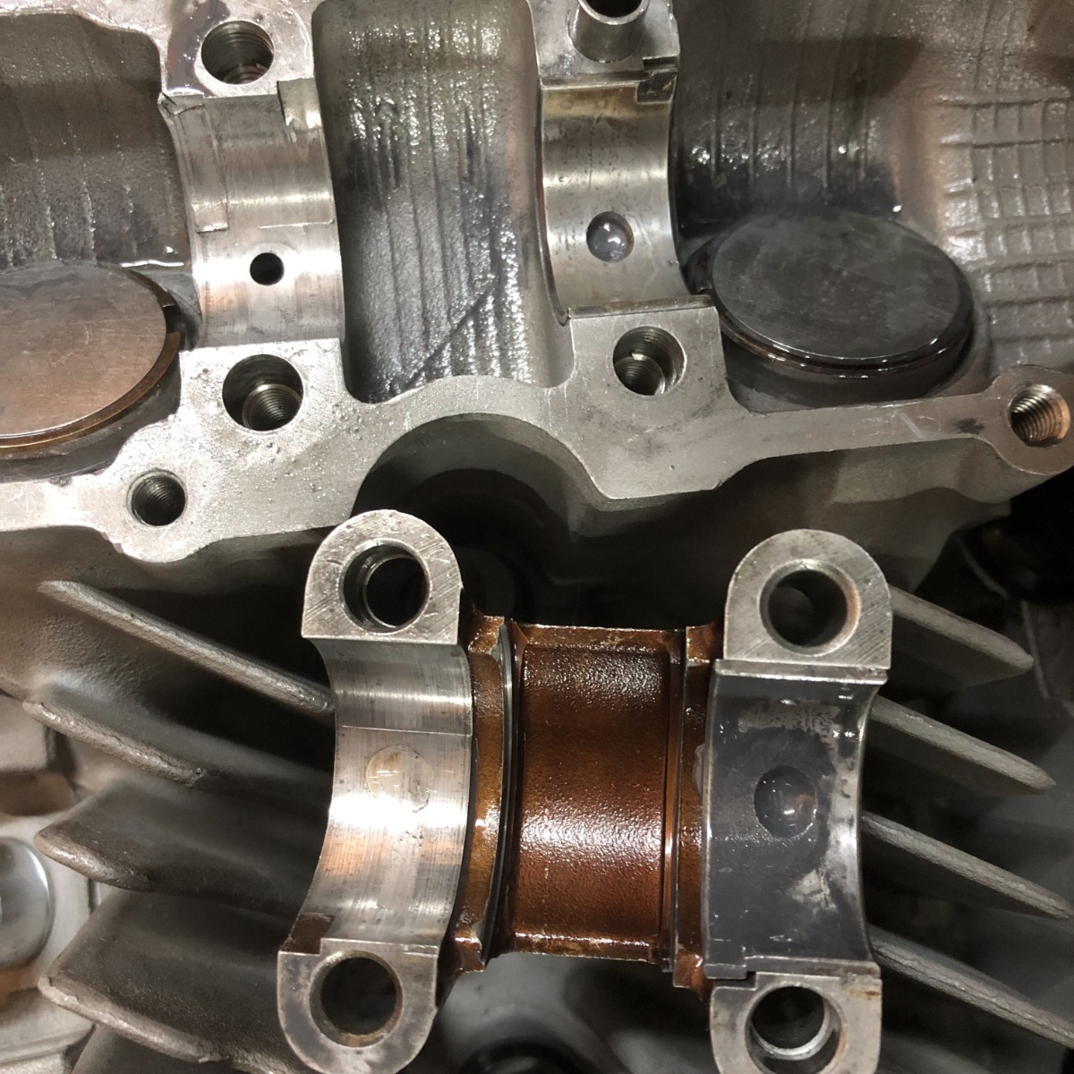

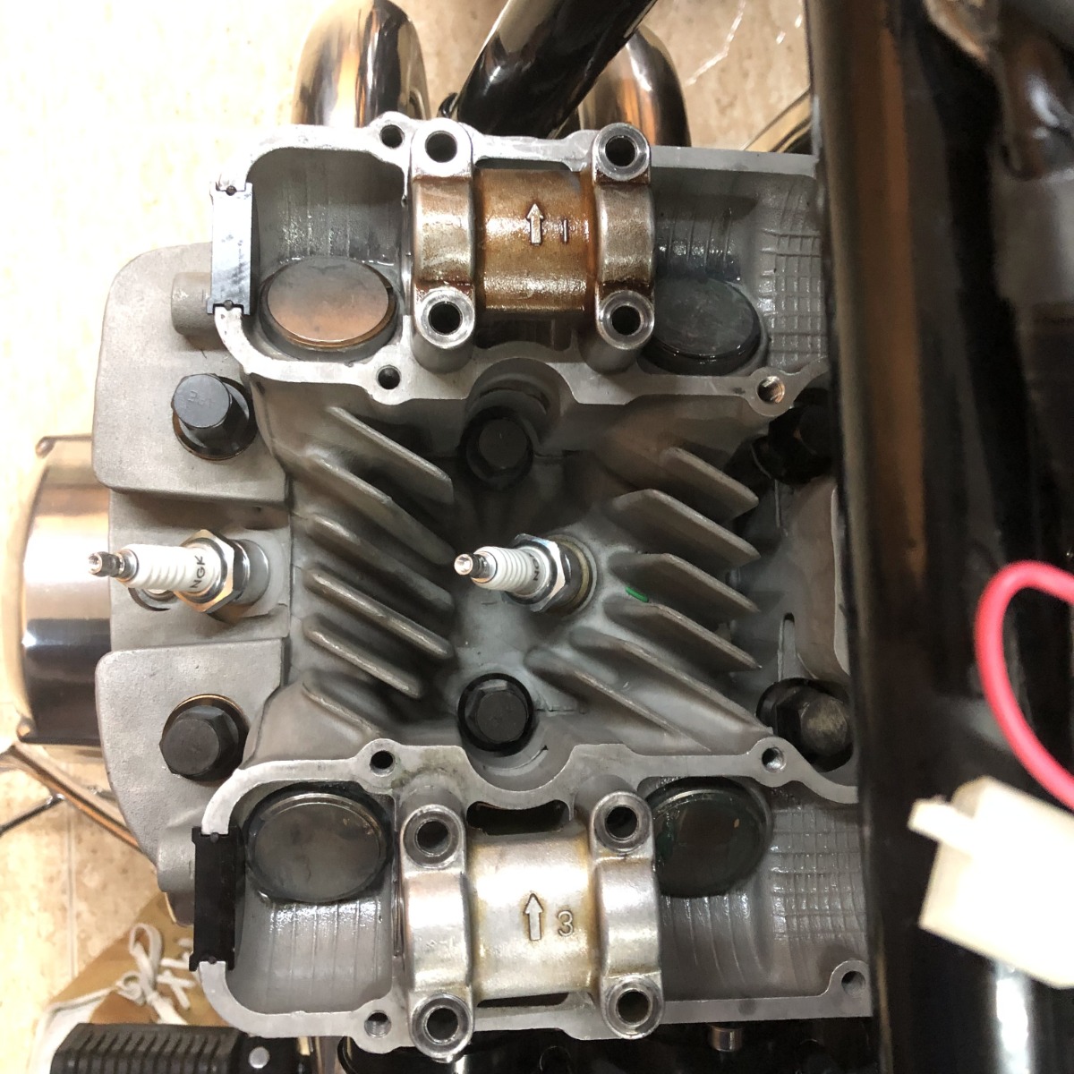

Are you sure you have the cam caps in their right places and not backwards? Is the head flat? The bearing clearance is .001-.006. On the head I'm running now I had to use cam caps that didn't come with it as the others were missing. Two I got to fit facing forward but two wouldn't work unless I installed them backwards. They are line bored with the head so they only fit one way. Even then I had to hone them to get the proper clearances using a plasti gauge. Pics?

A pic of the cam caps?

I'd like to see the bearing surfaces and the numbers on the back. Using a plastigauge will tell the story.

Re: Has anyone had problems with new camshaft bearings?
13 Apr 2023 16:26
I've heard of issues with pattern cam shells but never had a problem myself.
It's possible the actual bearing material is inferior and not up to the job.
If you have your originals and they aren't worn through to the steel backing it's best to re use those.
The shells in the cap get more wear due to the upward valve spring pressure so put the best looking ones there.
