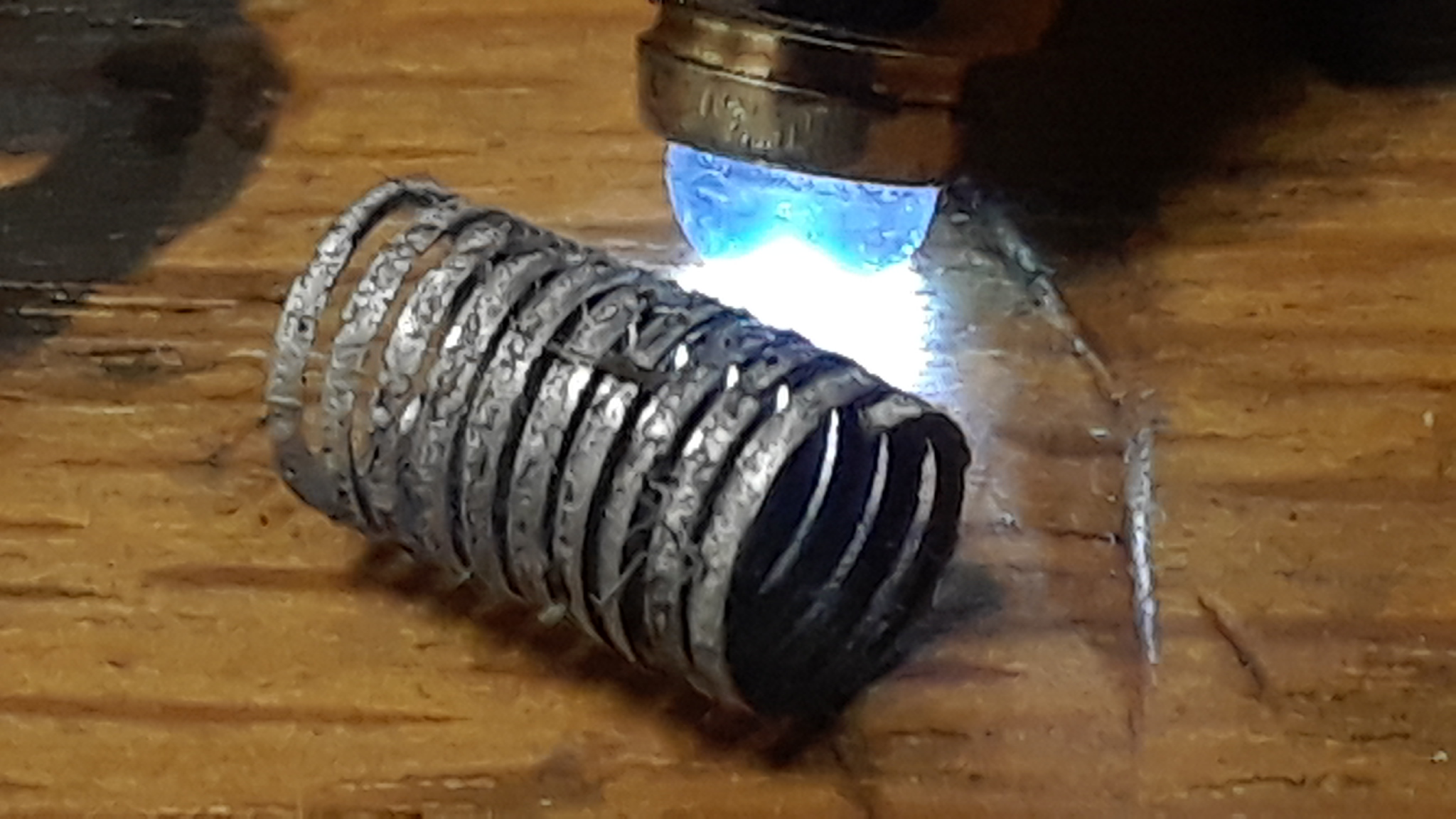

Had to drop an insert in one cam-cap hole this weekend...same strip-thread spring coil situation, just smaller.
Fortunately, I recently grabbed an old M6 x 1.0 Time-Sert kit (three 12mm long inserts included) for thirty bucks off ebay. It's not in like-new condition as the spark plug kit, but hey...it works!
One trick was having to remove the protruding top lip of the insert using a drill motor and file...so the insert would fit in the existing hole above the threads without having to enlarge it.
I will tighten the cam-cap bolts to ten foot pounds (vs. twelve) from this point forward...

It took this tiny aluminum spring for a poor excuse mechanic to realize that the FSM is not gospel, but is simply a source for reference.
Over and over...it's KZR to the rescue!
