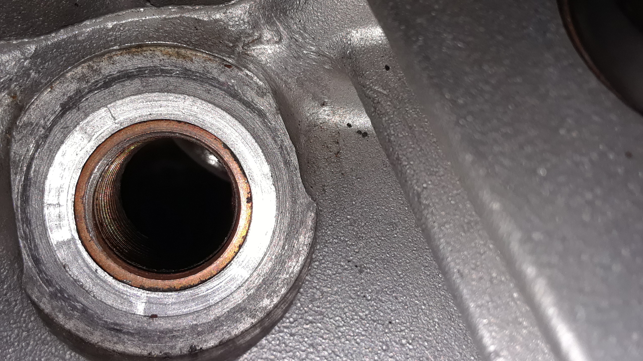

The M14 (small) portion of the tap was able to grab the remnant thread base on the hole wall, even after 90% of it was pulled out like a spring coil, which began this whole adventure.
Should anti-sieze compound be applied to the threads, considering more of the steel insert core material becomes exposed as the plugs are removed and replaced?

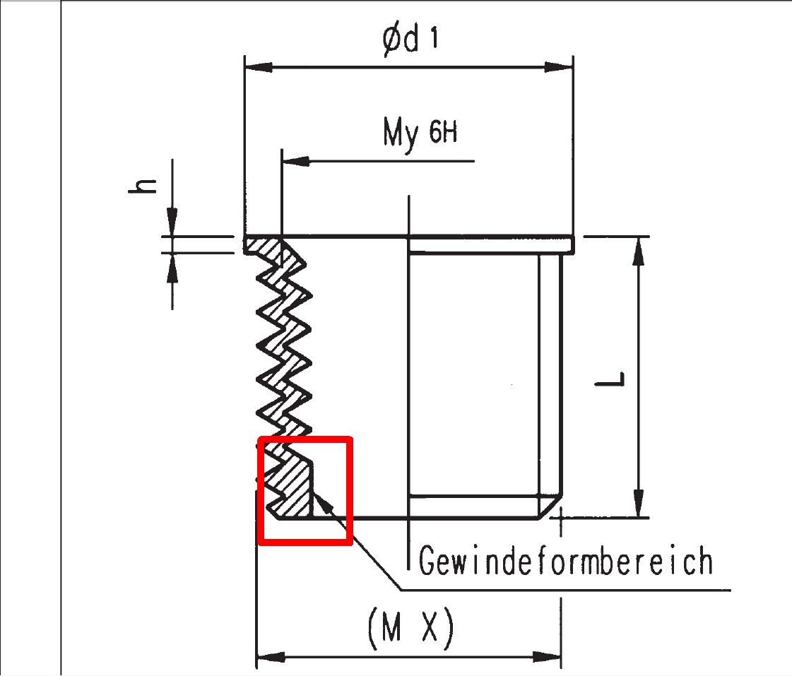

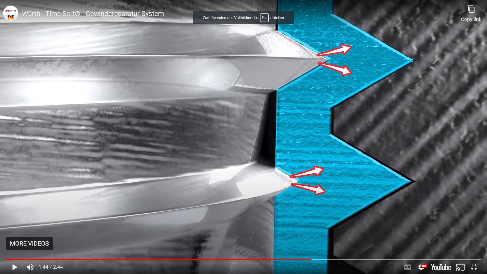

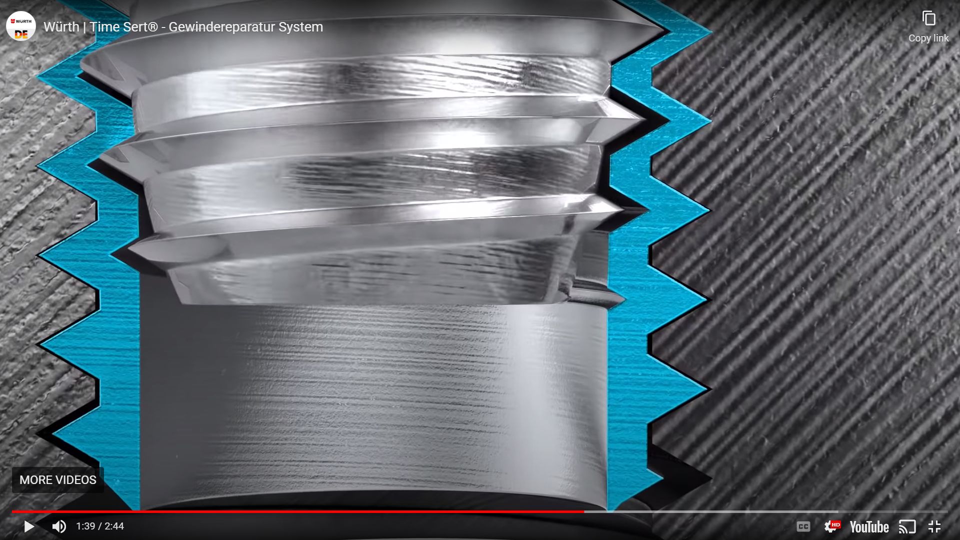

04 Jun 2022 12:04 - 04 Jun 2022 12:08No, the last two un-cut threads will help to turn in the in-sert and will be pressed/formed into the head aluminum after the insert is fully seated and do a permanent lock. Didn´t you watch the YT video? You can use anti sieze but it´s not necessary.Should anti-sieze compound be applied to the threads, considering more of the steel insert core material becomes exposed as the plugs are removed and replaced?

Did you use the expanding tool after you were done. It's supposed to expand the bottom few threads to lock the insert in place. You screw it into the insert past the resistance of the last few unfinished threads. That makes the bottom expand locking it in place.
