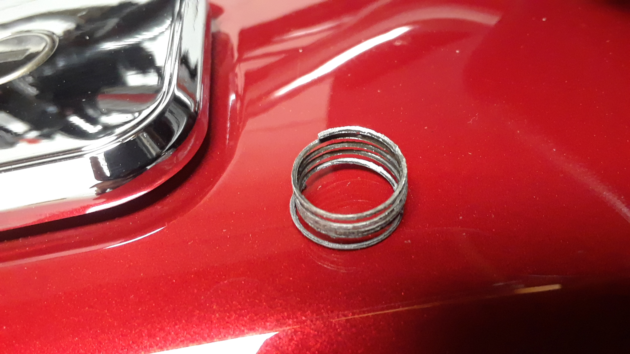

Eleven years ago I used a helicoil on cylinder two with the cylinder head in situ. No problems at all and bike is still going strong.
