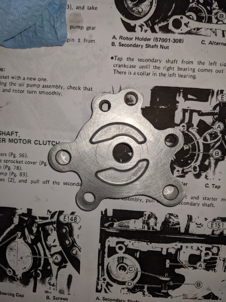

Not too bad should clean up nicely. I'd focus on the relief spring.

Sand in in a large figure "8".... which is generally accepted as the correct pattern to ensure uniform material removal.

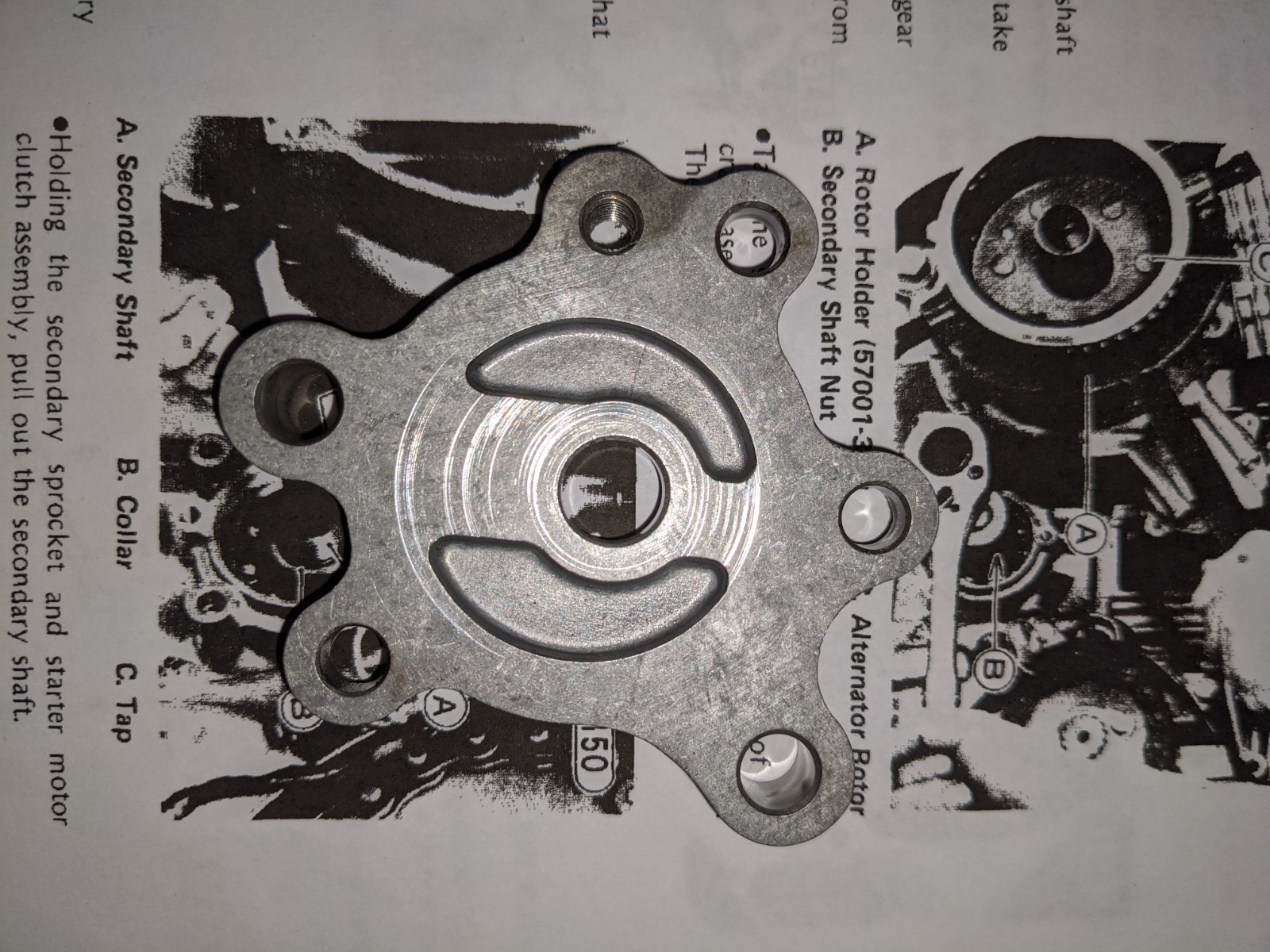

Looks like much of the scoring on the pump cover has been smoothed out.
Before:
After:

Before:
After:

Good job on the sanding!

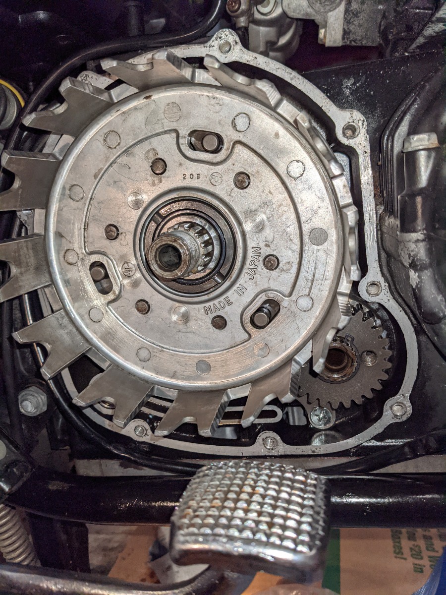

For now, I'm gonna button her up and try running a thicker oil, see if that does the trick.
I'm in the process of putting the clutch back in place and I wanted to make sure of something before moving on.
Are the clutch basket and the gear it meshes with supposed to be able to rotate while the bike is in neutral? Because it doesn't budge at all, and I can't remember if it rotated when I was taking it apart, so I want to make sure I didn't screw anything up when reinstalling the pump and oil pan.
I'm thinking it's probably not supposed to rotate, as that would intuitively make sense as to why the bike doesn't move when it's off and in gear - I just want to be certain.
EDIT: I remember now, the basket was definitely able to spin before - Could the fact that it's stuck mean that the oil pump gear might not be meshing properly with the pump drive gear on the secondary shaft?
And if I have to go back in and mess around with it, will I need to replace the oil pan gasket again, even though it's brand new? Or is it fine to reuse, since it has not yet been exposed to the pressure and heat of the engine?

Re: Oil light comes on at low rpm
19 Nov 2021 08:14
UPDATE: I thought my crankshaft was stuck since it and the clutch basket weren't rotating when I attempted to turn it by hand, but I think the reason I remembered them moving so easily during disassembly was probably because I was trying to turn the clutch hub locknut with a big ol' wrench, and the added leverage made it rotate more easily.
