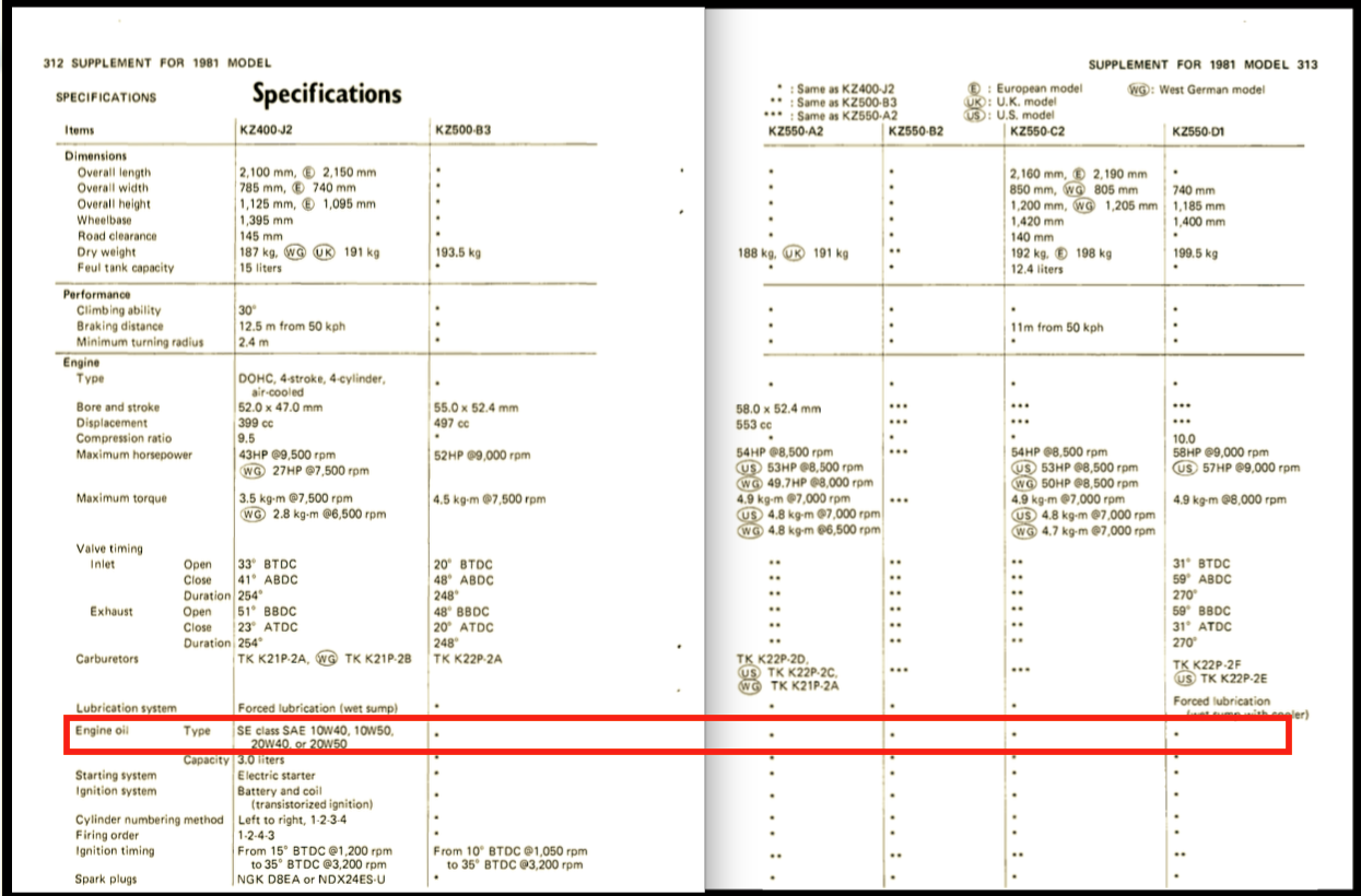

You will lose some power with a 20w-50 but your engine will be better protected as it's air-cooled.
The service manual for a 1981 kz550 does list 20w-50 as an option.
I would be more worried of running 10w-40 in an air-cooled than running a 20w-50.

08 Nov 2021 09:57 - 08 Nov 2021 10:06Mine is an '82, but the oil change section of the supplement says to refer to the main manual, so it appears that I have the same options. Maybe I should give that a try before digging any deeper into the guts of the motor.You will lose some power with a 20w-50 but your engine will be better protected as it's air-cooled.

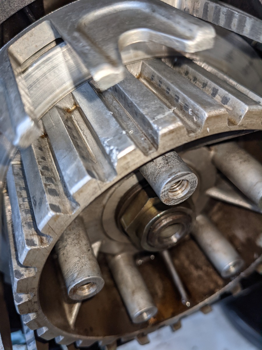

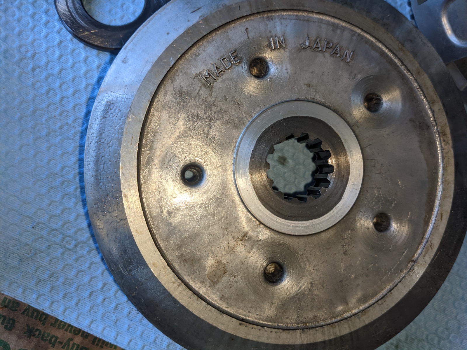

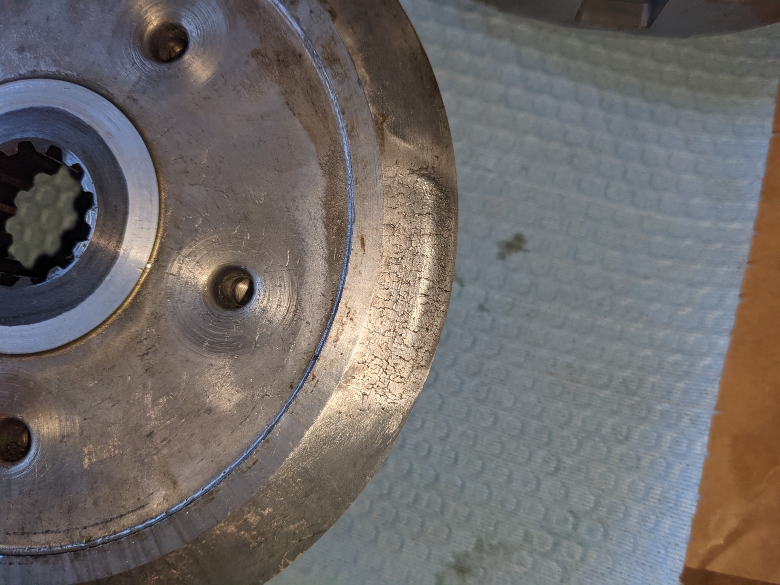

4. A few of the dogs on my clutch hub are a little damaged, and the backside appears to be covered in tiny cracks. Does it look bad enough to warrant replacement?

The back side of the hub is fine. AFAIK those are just casting marks.
I would clean up any burrs on the dogs and check for cracks. If it's just that one chunk I would think it would be fine. Can someone else chime in on this?

The damage to the dogs actually occurred as I was removing the hub nut. I got one of those clutch holder tools (looks like vice grips with perpendicular jaws that clamp between the dogs,) and the video I watched on how to use it said not to clamp it too tight, since the hub is fragile. So I kept it a little on the looser side, and as I tried to torque off the nut with a ratchet + pipe extension, the holder tool slipped out of place, chipped a dog, and scraped another. Pretty disappointing. I tightened it up a bit and it worked okay on the second try. I'm a little nervous to use that tool again though.
Anyone know of an easier/less destructive way of keeping the hub still while I tighten up the nut?
