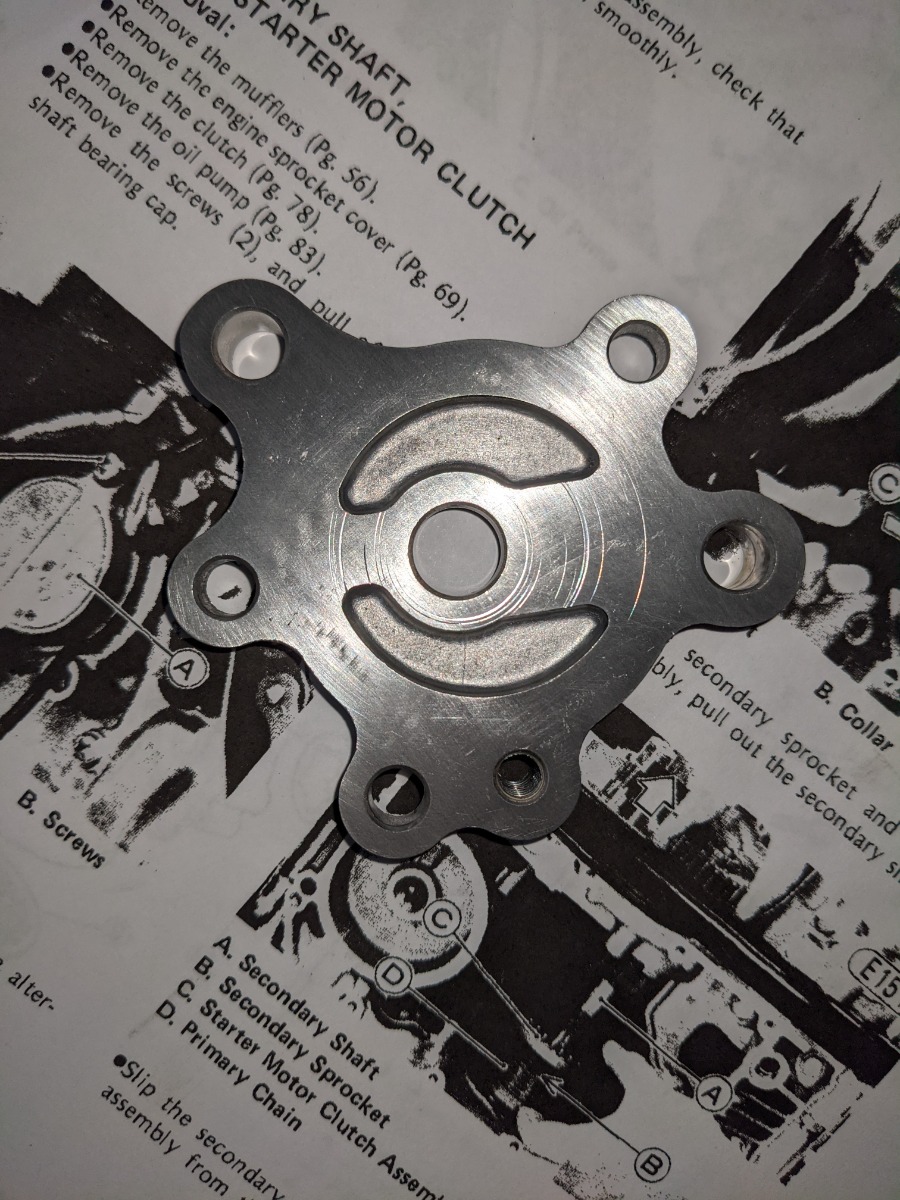

09 Nov 2021 08:32Is the main takeaway from this video that I should sand the surface of the pump cover to smooth out the scoring?

Yes for a start and check the pressure relief valve. When cold the spring could work as intended but when hot it could be weaker.

PIC OF HOW DEEP?
