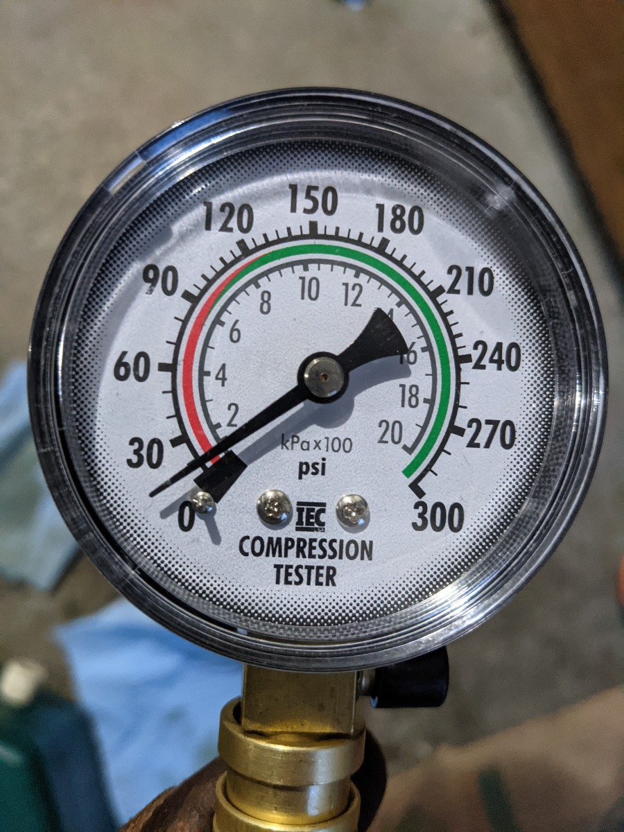

Went for a 30 minute ride, which was long enough to get the oil light on - this time it only stayed on below about 1300rpm.
I checked the oil pressure at idle, and the needle looked like it didn't really move at all. When revved to 4000rpm, I got the reading pictured below. Looks like about 15psi, which falls beneath the 28-36psi range listed in the FSM. Does this mean there could be a problem with the oil pump, since the relief valve appears to be operational?

We're always reluctant to contribute to threads on bikes we're not familiar with, such as KZ550's. That being said:
The pressure spec leads us to believe KZ550A motors are a plain bearing design that rely on pressure instead of volume, as in the big block roller crank motors.
Did you change the filter when changing the oil? Some pressure drop across the filter is normal, but what you're seeing isn't. I appears that the filter on a KZ550A is a cartridge filter. Perhaps defective? We'd try either replacing the filter with an OEM filter or, try a quick & dirty test by removing the filter, then replacing the filter cover leaving the filter cavity empty and testing hot pressure again. No filter will eliminate the filter as a possible culprit.
How many miles on the motor? Bearing wear will reduce oil pressure.
We noticed a compression gauge is used for oil pressure testing. Is it rated for that? We've never tried that and have to question the accuracy of the result. Too, the result is very, very close the bottom of the scale where mechanical pressure gauges in general are not accurate at all.

To answer your question, the odometer is at 31,500 miles.
I too was skeptical about using a compression gauge to test oil pressure, but the guys at Advance Auto told me it would work.

At 31K mi., there may well be bearing wear affecting oil pressure. Running 20w-50 might increase hot pressure enough to reduce the tendency for the oil light to energize at idle. Only way to check bearing wear would be a complete teardown and mic and/or plastigauge test of all bearings & journals.
As far as testing oil pressure sans filter, we'd try this:
Prepare all the tools needed, catch pan, rags and workspace in advance. Ride the bike for 20 ~ 30 miles to get everything to operating temp. Immediately upon returning to the workspace, drain the filter cavity, remove the filter & reassemble as quickly as possible. The motor & oil should still be hot enough to get an accurate hot pressure reading. Oil light still on? Pressure reading change?
But...
Even though the needle moves a tiny increment on the compression gauge when testing idling oil pressure, it's still the wrong tool, operating at the extreme 3% ~ 5% bottom end of a scale that doesn't have enough resolution for an accurate reading to begin with. So, as far as the guys at Advance Auto, yeah, they're right; it does 'work'. The needle moves. It just isn't designed for pressure as low as what you're dealing with.

23 Sep 2021 06:33Yeah, I agree with this. It looks like there are several 0-100 psi gauges on Amazon. That range would more closely match the expected range for your bike (28 to 85 psi).Even though the needle moves a tiny increment on the compression gauge when testing idling oil pressure, it's still the wrong tool, operating at the extreme 3% ~ 5% bottom end of a scale that doesn't have enough resolution for an accurate reading to begin with.
Something like this? www.amazon.com/OTC-Tools-5610-Trans-Eng-Tester/dp/B000R5G0DO/
