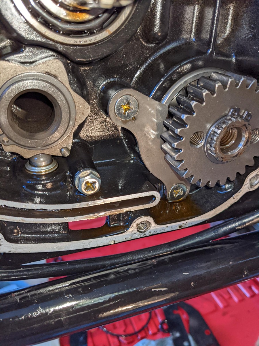

I've drained the oil, removed the filter, exhaust, and clutch pack, and I'm getting ready to pull the oil pan and pump. The FSM says to replace the pump cover gasket (part # 16145-004) during reassembly, but I'm having trouble finding the part online. I checked Partzilla and Z1Ent, but neither of them seem to have it. My google search didn't turn up much either. Same for pump rotors (16154-003). Does anyone know where else I might be able to find these parts?
I've also heard that the oil pan can be a PITA to remove, so I'm open to any tips for that process as well. Thanks!

I managed to remove the oil pan by leaving 4 bolts in place just a few threads deep, then holding a 2x4 against the pan and giving it a few good whacks with a hammer. The gasket came off pretty clean, minus a couple small problem spots around the bolt holes. I could probably scrape those off with a razor, right?

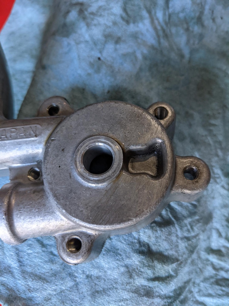

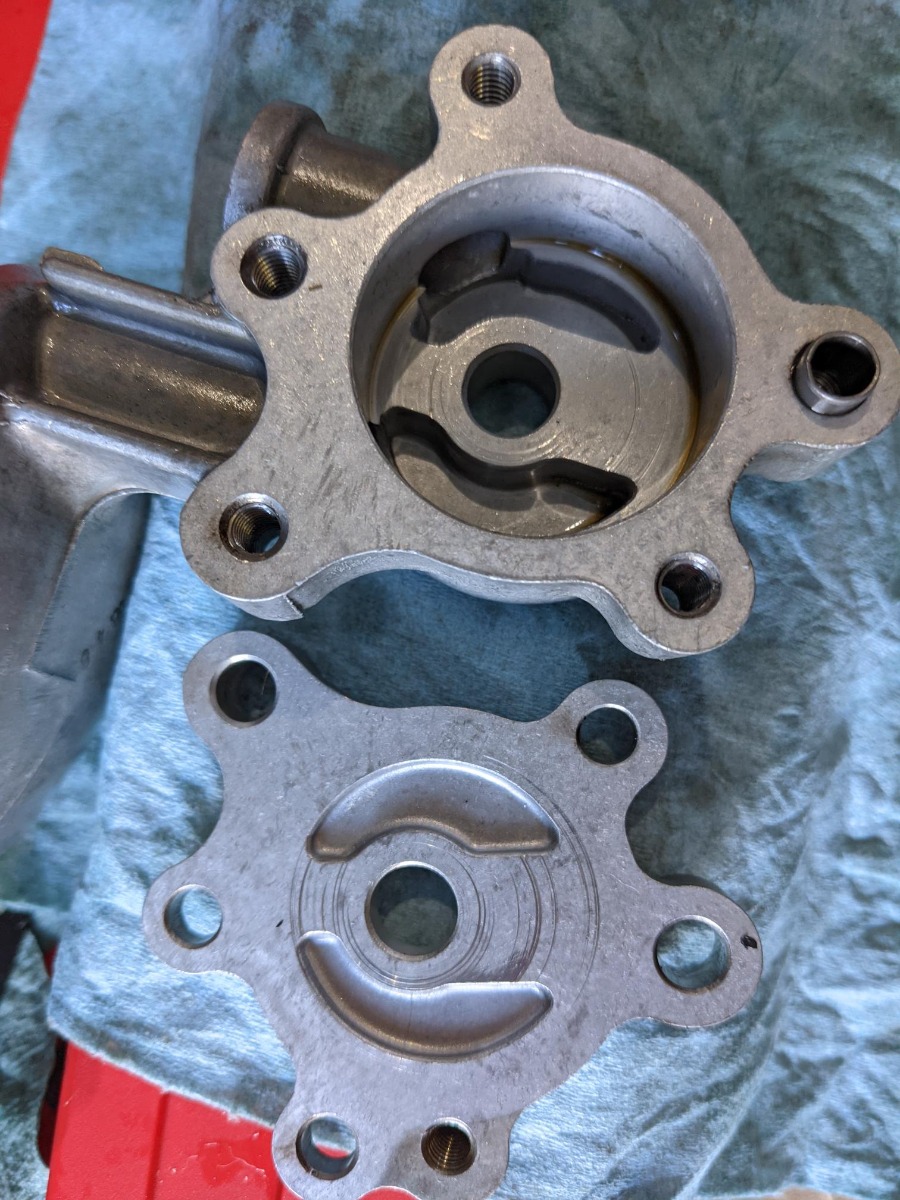

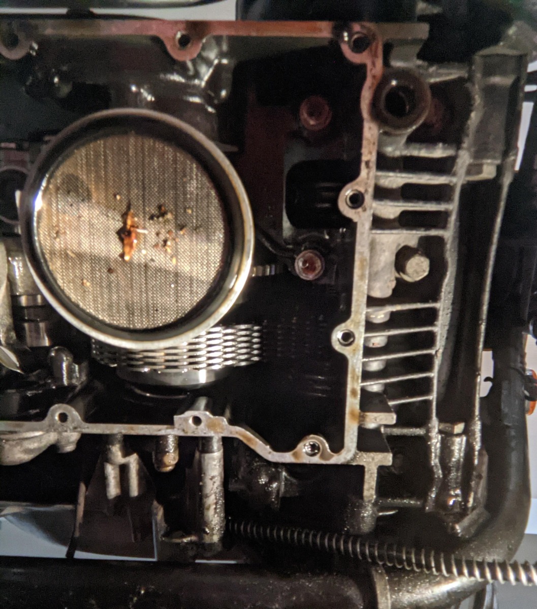

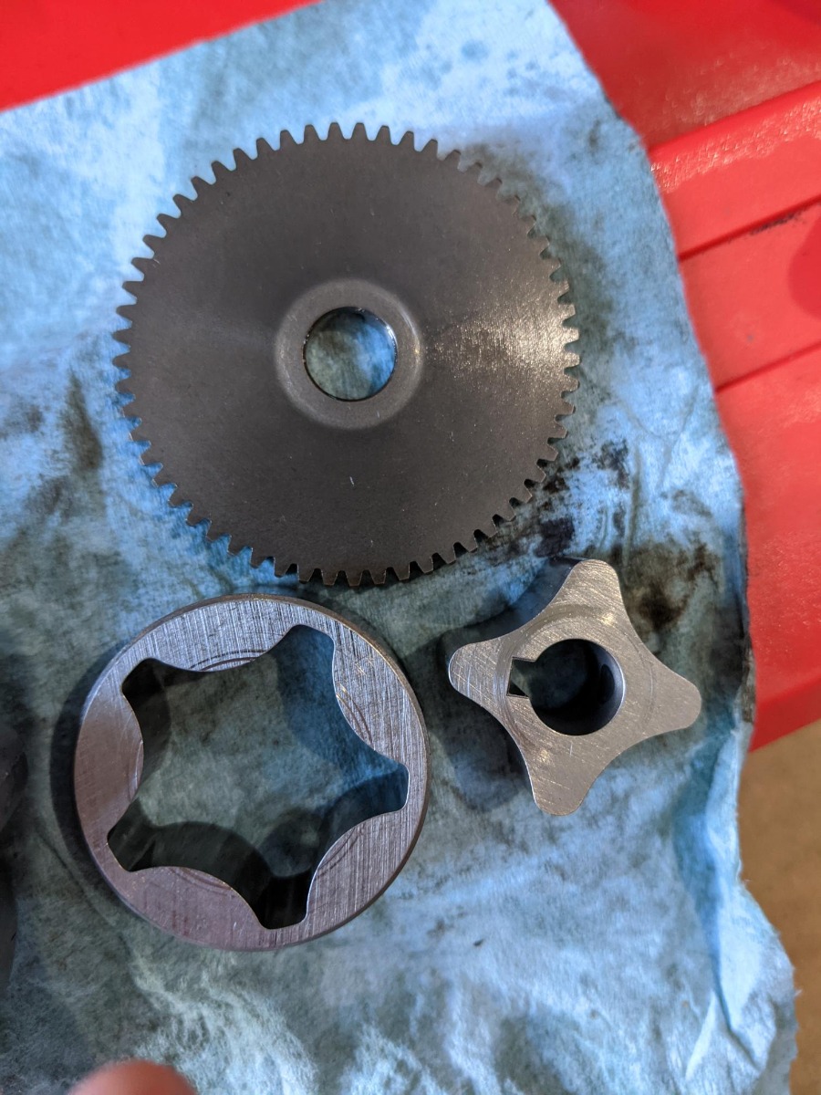

I took a look at the oil pump screen, and it was definitely dirty, but I don’t know if I’d go so far as to say it was clogged… there are some small particles, and that large object is a piece of a leaf. The streak across the middle is just due to the lighting. Does this look like enough debris to be causing the drop in pressure?
Removal of the oil pump mounting screws was a colossal pain in the butt, as they were staked in place. Even with my Vessel JIS Impact screwdriver, they wouldn’t budge until I upgraded from my 20oz hammer to a 4 lb mini-sledge. When I eventually reinstall the pump, will I need to stake the screws again? Or is it enough to just use blue Locktite?

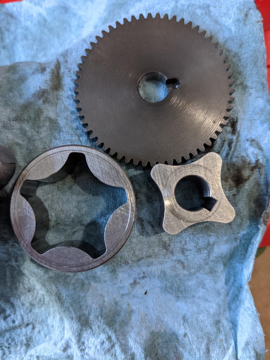

I checked the pump rotor clearances with a feeler gauge, and they were well within the service limit of 0.3mm. The rotors and gear don’t appear to have excessive wear, but I will let you folks be the judge of that. I preemptively ordered new rotors, so should I just replace them anyway, since I have them?
Side1:
Side 2:

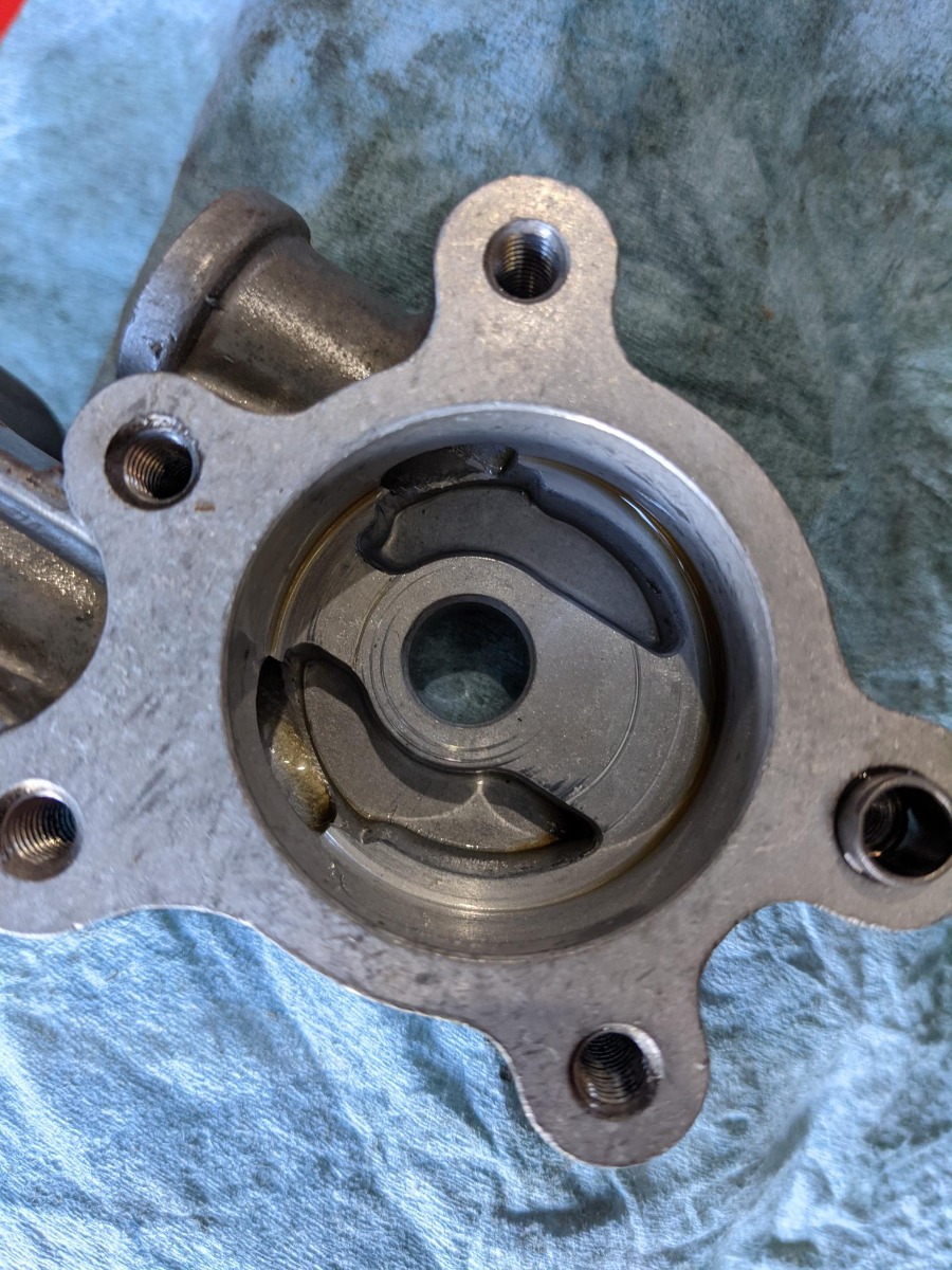

The pump body and cover appear to have some scratches/grooves. Does this indicate any significant damage?

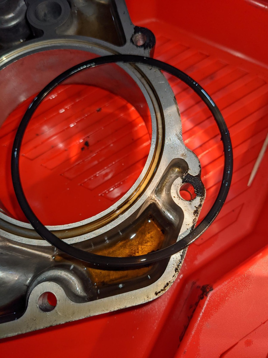

The 90mm O-ring that sits in the pan, around the oil filter hole, seems a bit worn – notice the fraying on the right side of the image. I’ve ordered replacements for all the O-rings and gaskets that I’ve had to remove. Could a poor O-ring be contributing to low pressure?

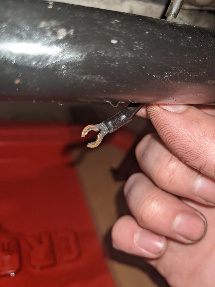

The pressure switch lead looks a little dirty, so I’ll clean that up when I reassemble everything. Dirty electrical contacts could potentially explain the oil light coming on in error, but it wouldn’t explain the low pressure readings, unless my gauge is incorrect.
Side1:
Side 2:

I had a similar problem with my wife's mini. I replaced the oil pump, which looked a lot better than yours does, and the problem got a bit better. I still have the problem though and the next step is to check the crank & big end bearings. If the clearance is way out it will be hard to build up oil pressure at low RPMs.
I would replace that pump and hope the problem goes away - the pump body seem too far gone to just put it back in. If the pump and the relief valve are all good and the problem still persists, then I'd be checking the camshaft, crank & big end bearings

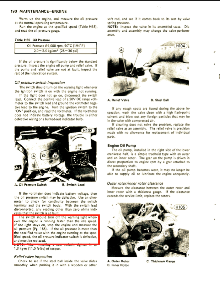

Your very first post, according to the factory service manual, does not seem to be an issue if the bike is at idle.
It is an issue if the light stays on above idle.

07 Nov 2021 16:10I've read that section as well, which is why I wasn't too worried at first. Initially the light was shutting off around 1300-1500rpm, but more recently it had been staying on up until 2000rpm. Also, my pressure tests indicated about 20psi at 4k rpm, which is lower than the ideal range listed on that same page of the FSM (28 - 36psi).

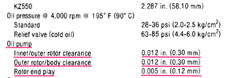

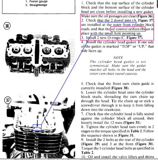

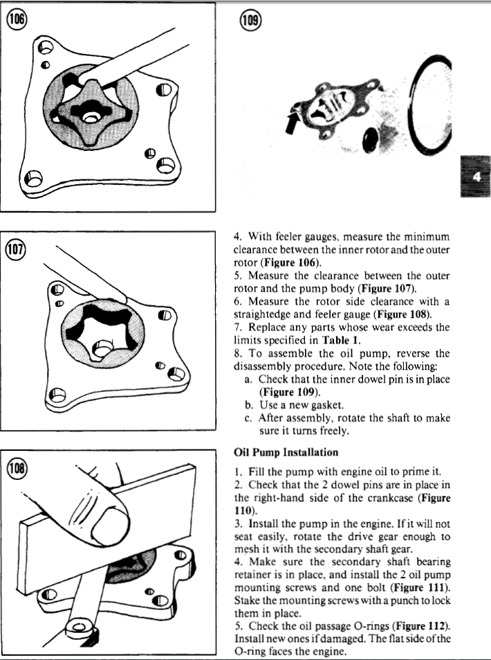

In my opinion, that oil pump "looks" OK... Small striations in the rotor contact faces are "normal".
However, you will have to verify the measurements set out in the instructions. (See attached pics)
The pump cannot work effectively (create pressure) if clearances are bigger than spec.
If the measurements are ok, then it is clear that there is a pressure drop due to increased clearances elsewhere.
The first thing I would then check is if the oil pressure orifice could have been omitted, or incorrectly installed by the previous surgeon!
I'm not sure what the effect of a hardened / faulty o-ring would be (the "oval" shaped one that surrounds the oil pressure orifice in the cylinder block) but it would seem logical that if oil was bypassing the orifice, the pressure would potentially be reduced.
